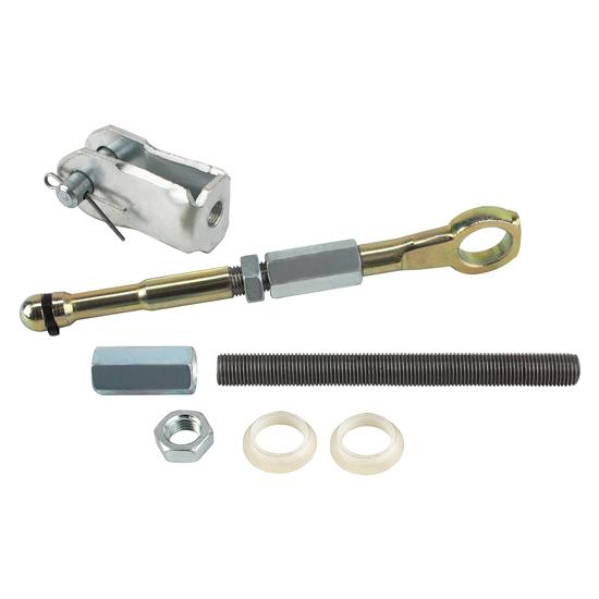

Ok, got the lines bent and flared, that's all set. I start to "bench" bleed the brakes on the car and the rod is making a clunking sound now, looks like the rod is too short. I re-used the rod hat was on the last master cylinder. Also noticed that the brake doesn't come in contact with the brake light switch now too.
Edit: you think this will solve my problem? http://www.speedwaymotors.com/SSBC-U...Kit,50351.html

Ok, I orderd up the above mentioned pushrod, hopefully that solves my problem.

Ok, got the adjustable pushrod in yesterday and got it installed. still had the clunking problem, it ended up being the cap that goes onto the master cylinder that the pushrod passes through, I'm thinking to keep it in place, well there are reliefs on the top and bottom for the pushrod to easily move through at angles, but I had the reliefs going side to side, which didn't allow the pushrod to get the angle it needed. I finally removed the boot that was covering it to figure it out. I can't believe I took that damn thing off about 6 times, and each time I put it on the wrong way. Doesn anyone even know what that cap is called?
anyway, got that fixed FINALLY, and got the master cylinder bled. I'm now waiting for a friend to come over and help me bleed all four corners.
