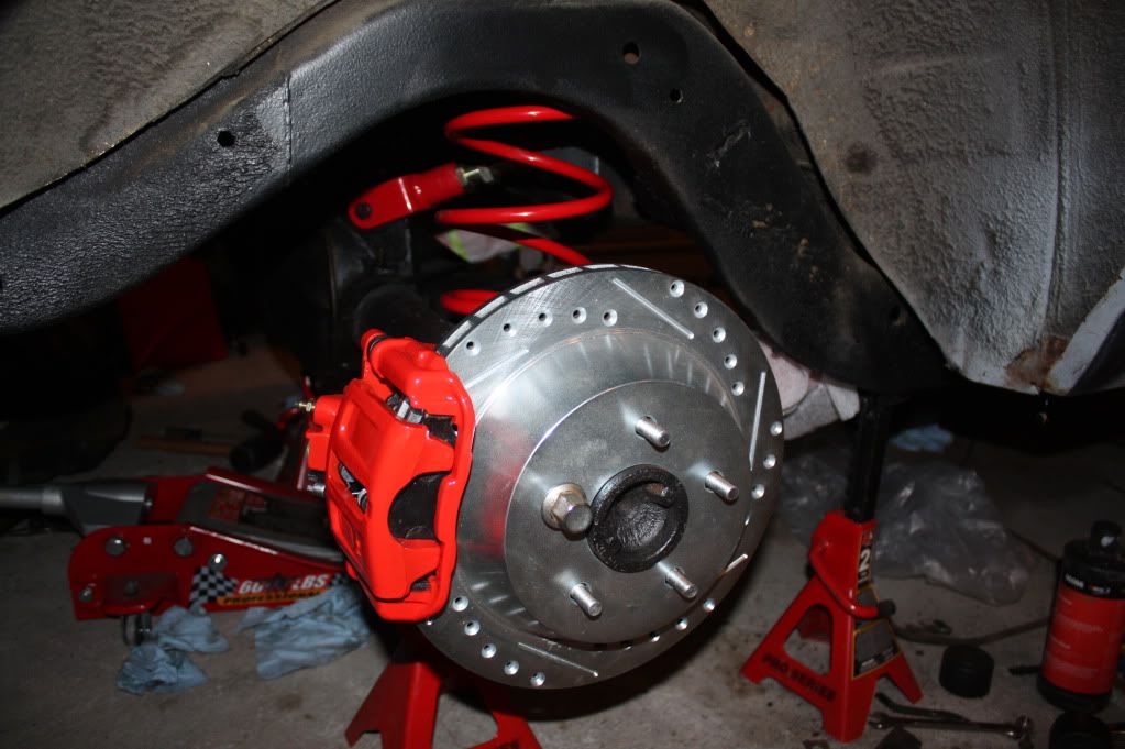

Here's some photos of the progress. Again...sorry for the mess. Trying to slowly throw things away i don't need...but I generally hold on to the until the last possible minute just in case I need it.
Anyway, on to the pics!
Here's another shot of the front suspension with complete steering...only thing left is to install the shocks
Complete Long block sans valve covers...kinda had an issue with the ones I got...they were misrepresented and I did not get better pics...oh well.
Without valve covers:
With Driver's cover...passenger doesn't fit:
Edelbrock adapters with PST mounts:
Rear suspension installed minus sway bar - 12" rear brakes:

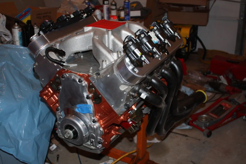

And for today's updates...
Finished buttoning up the bottom end and front cover...still waiting on my accessory drive from Pace Performance...its a very popular item so they are a little backordered.
Installed the new valve covers and coils as well as the Pacesetter Headers that I will be modding slightly for my build. Should work nicely.
Also made a sweet purchase from Luke Mau of L&H Kustoms - a complete Vaporworx tank pump and regulator set-up!!! I am VERY STOKED about this one as I plan of upping the power in the near future and won't have to do a darn thing to the fuel system.
On to the pics!
Different lighting shot:
Shot from behind:
No shots of the tank for a few more weeks. EZ-EFI should be here this week. More pics to come!!! Thanks!

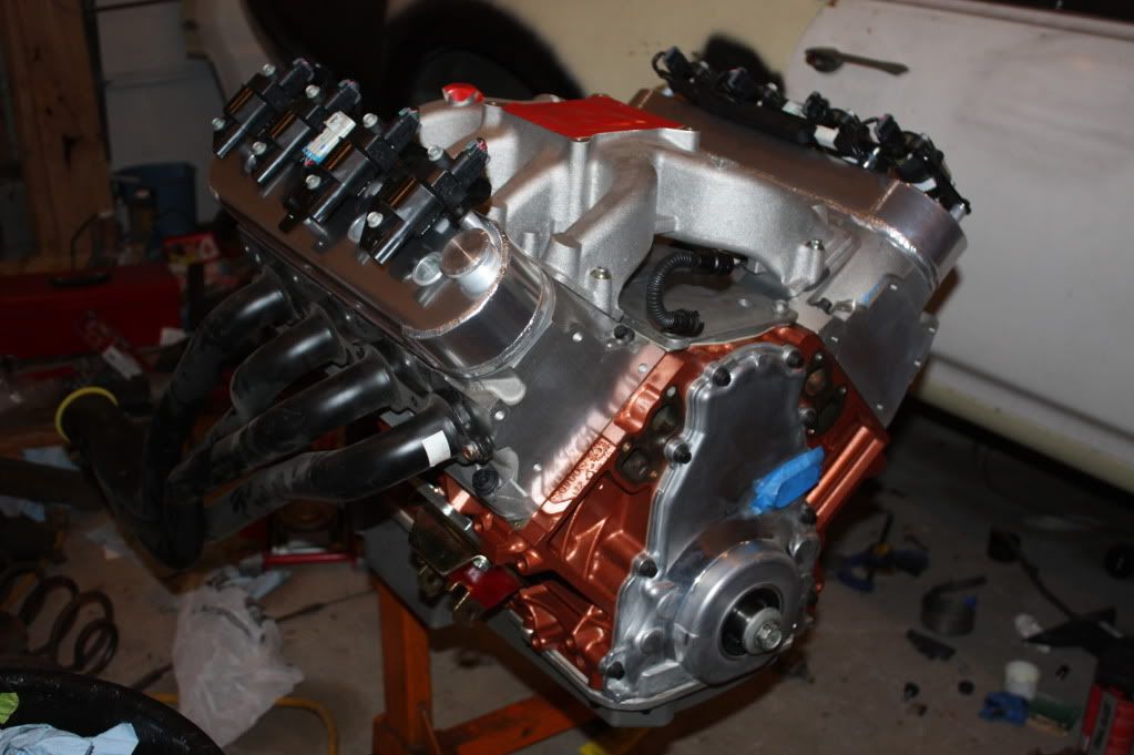

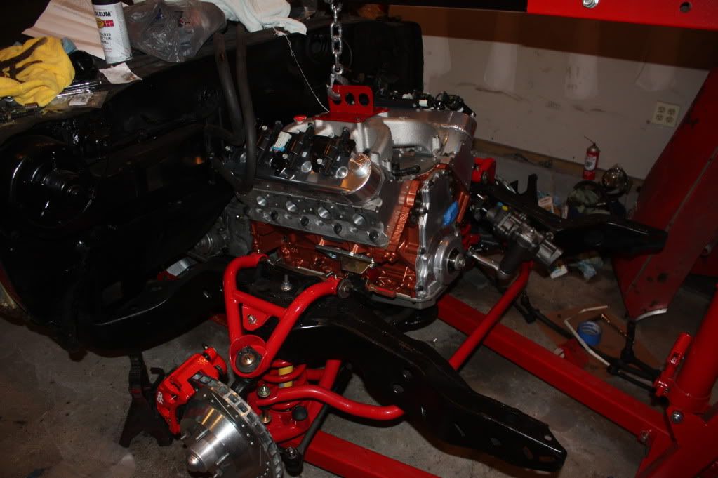

Few updates for today. Got the EZ EFI on Thursday...very excited!!!! Also got the engine and trans stabbed in for the first of many times this weekend. The PST urethane mounts are a real PITA to work with not to mention I have to trim some metal off the top of the 4L60e. Is there any other A-body guys out there that had that issue as well? I will take some pics of had to do tomorrow after it is done. I believe they are panhard bar mounts for the 4th Gen Fbody as that is what I got it from....what a pain in the arse.
Anyway, a pleasant surprise, 4th Gen Fbody headers will work well in an A body. I will have to redirect the pipe once out of the header but no big deal.
Enjoy the pics.
Thanks!
Dave
