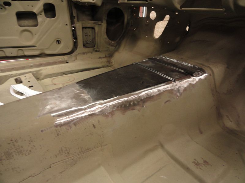

New dash is in. Caught them welding in my rear brackets!
They also got the transmission tunnel patch put in.

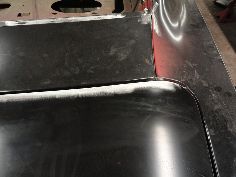

They had to do a lot of work on the new trunk to get it to fit the rear fill panel well. It was good side to side on the quarterpanel gap but needed work on the top edge as it had a significant gap on one side and touching on the other. They managed to get it all looking pretty good

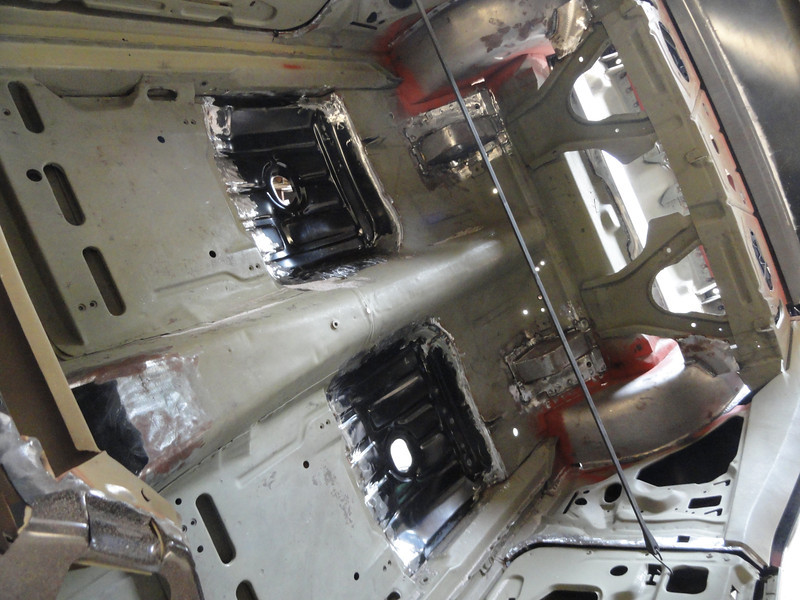

The two small floor patch panels that were needed have been installed and completed.
Lastly a few misc shots of the car on the rotisserie

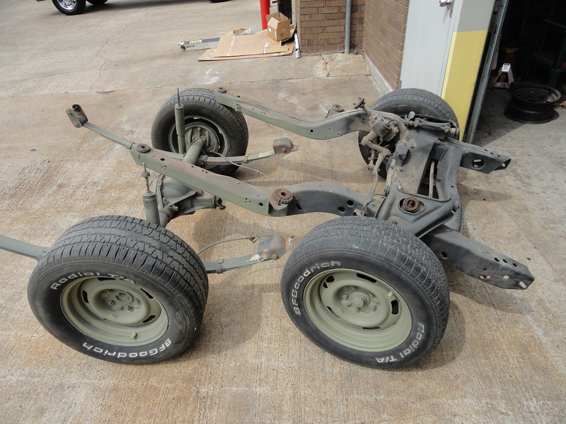

These old crusty parts await their limited time back in the car. These will be replaced before the car is driven. The DSE 9" awaits in the garage and I will be buying a new front subframe (yet to be decided). These will stick around until the car is through paint.
