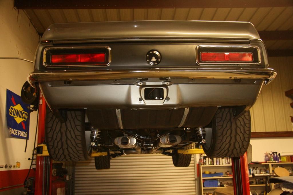

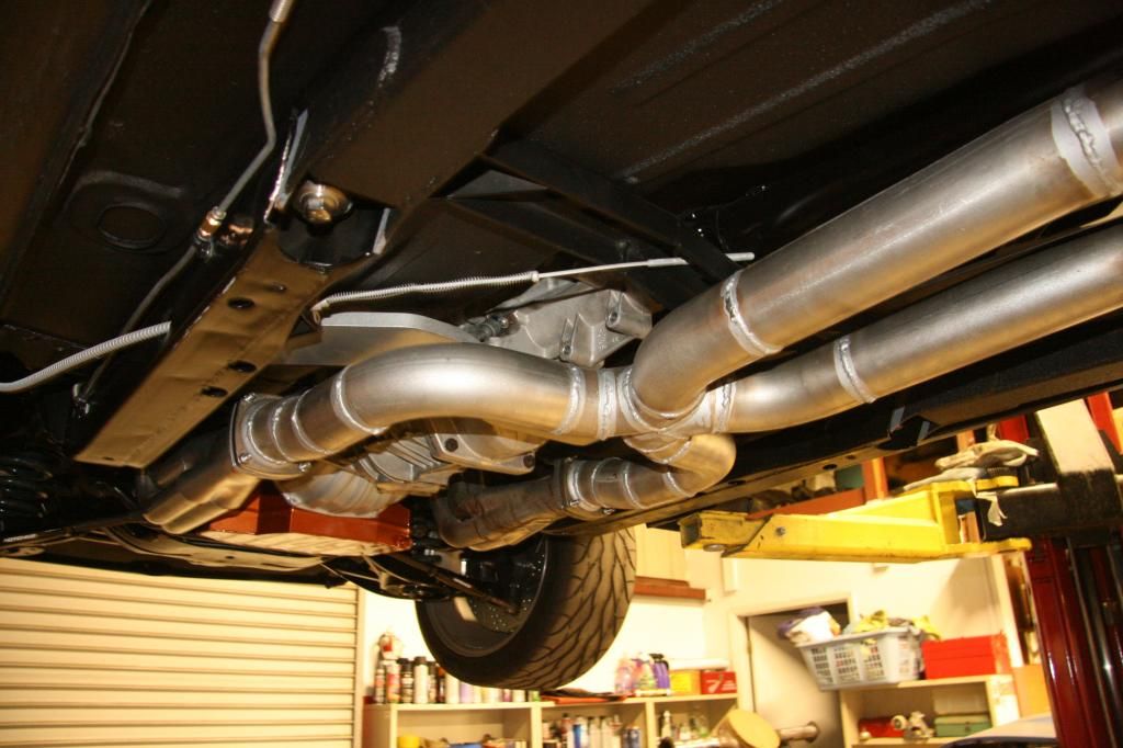

Default Exhaust Progress Update ~~ Road Touring Customs ~~
This project is looking mighty fine, Rich!

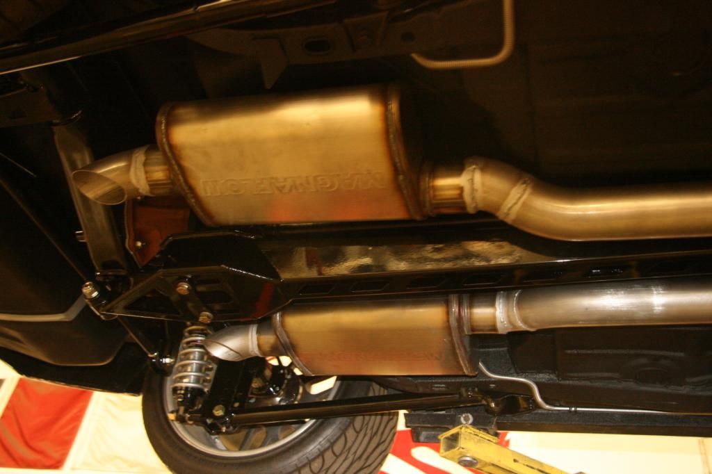

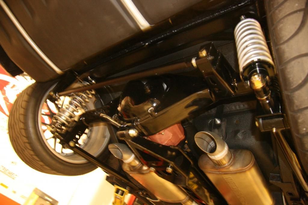

Default Details

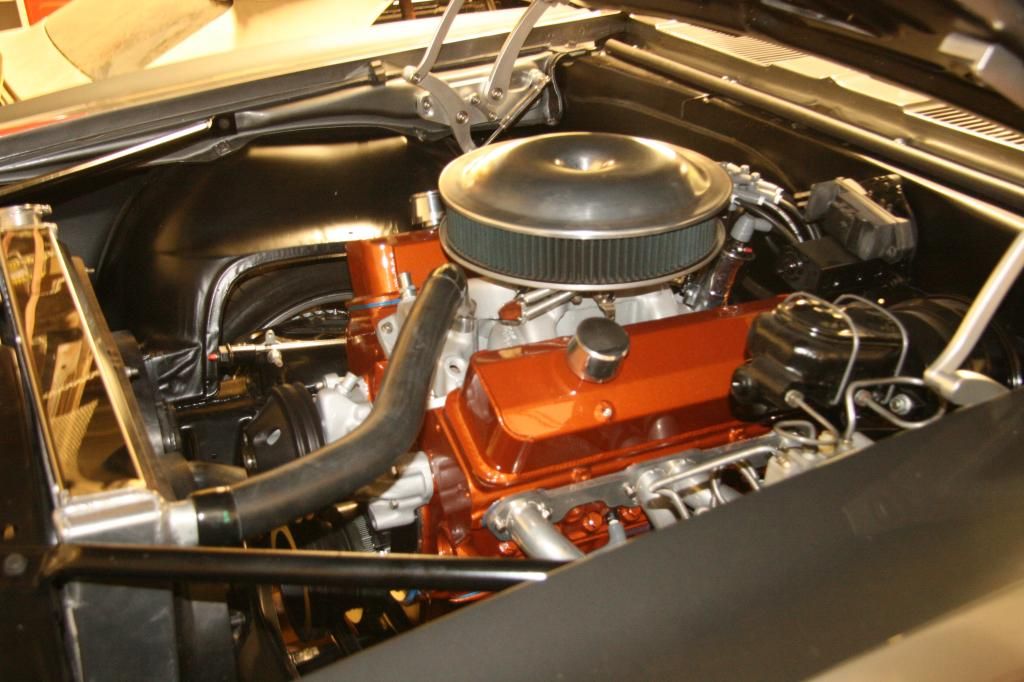

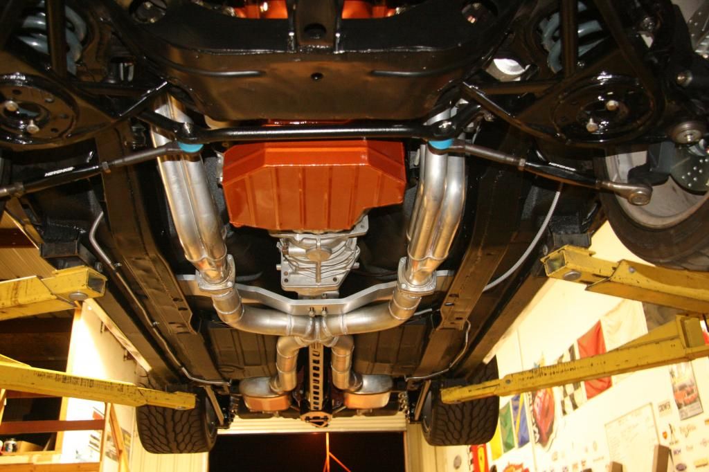

Default Engine and Frame
