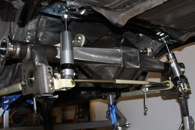

Time flies when you're having fun... Now if I could only slow it down so I could get some work done on the Nova .
Not much to report really. Picked up some parts I needed to get it mocked up to roller stage.
Got the new AMD HD cooling radiator support and inner fenders. Been so long since I had inner fenders I couldn't remember the fitment of all the overlapping pieces. I ordered up an assembly manual .
Spec'd out and ordered up a set of Strange 35 spline axles with the Timken Set20 tapered bearings. Got the seals and bearings pressed on no problem. The wedding rings... no dice with my "little" 20 ton H-frame press. Just doesn't have the nuts I guess. I'll find a shop to do it. In hindsight I should've just ordered up the axles with the housing and been done with it. I just wasn't sure then on which diff I was running.
Went with the small 11" 4 piston Wilwood rear brake kit with the integral parking brake. Matches the fronts I had but nothing "pro-touring" cool with just plain rotors. I'm running manual brakes so I went with their aluminum master cylinder with 7/8" bore. Picked this stuff up from Justin@Scott's Hot Rods who was great. Stuff shipped right out.
I got a few hours over the holidays to unbox all the G-link parts and get it mocked up. It went pretty smooth and easy since the bracketry was already installed. The kit ships with 12" 200lb springs which I don't think are gonna work. They would require 2-3" of preload and even then I'm afraid it will ride too high. I'm gonna go with a 10" Hyperco I think. It looks like with the shocks within the manufacturer stated 13-14" minimum length at ride height and utilizing all the G-Link adjustments to lower the car, a 15" wheel lip is even with the fender lip. That's a pretty good height I think. When I get the 18" wheels they'll tuck some and that's what I'm after.
So the bad news... I was hoping to defer the cost of the center section for a while for cost reasons. Well after getting the rear mocked up I'm a little afraid the center might come too close to the rear tunnel. I'd rather know this now than later so I guess that'll be my next purchase. When that happened I stopped on the rear mockup since I'll just have to take it all back apart once the center arrives.
The other maybe bad news... exhaust clearance. I've always wanted 3" out the back. Thinking that just ain't gonna happen with the G-Link crossmember without going up and over requiring trunk pan mods. We'll see.
In the meantime I've moved on to the front suspension mockup.
Sounds like "Up and Over it is" Funny thing I was worried about the same thing. Then I realized it's just metal and do and get it over with and I will be some much Happier.
So have the Metal Master cut the floor and trim the tank and you will be super happy. Plus when your at a car show people are going to look in your trunk and see a cool funky floor and ask you is that stock and you can reply, "Is Now"
ps - the rear set up looks awesome.
