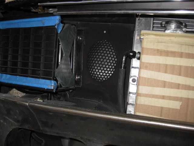

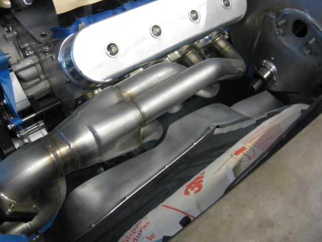

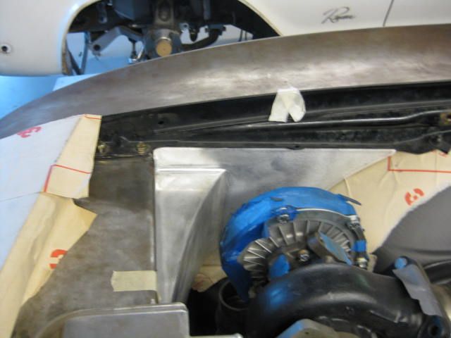

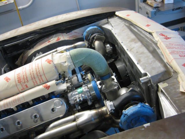

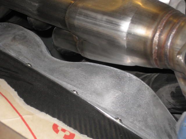

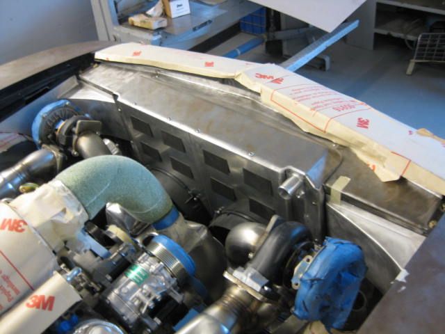

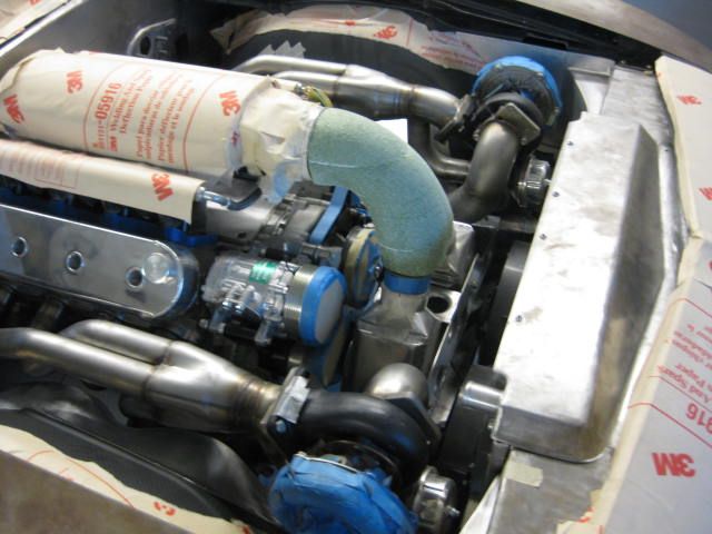

Ok, Ok! Havent updated in a while so here we go...
We needed something to transition from the Anvil carbon wheelwells to the AME sub. This is what we came up with....
Radiator support fabbed up with huge Ron Davis radiator, intercooler radiator, AC condensor and RS headlight doors = tight fit!
We grabbed some fresh air on both sides to direct to the air filter areas behing the headlights....
Steve Keefer

Old 10-20-2012, 07:12 PM
coolwelder62's Avatar
Join Date: Aug 2005
Location: Vinland Ks.
Posts: 4,315
Steve,Awesome.Look's like you have run out of room.Tight fit there.

  #66
Old 10-22-2012, 10:12 AM
Jr's Avatar
Jr Jr is offline
Location: so cal
Posts: 1,772
What are the intercooler rated for?

Thanks: 8
If I remember right, it was 650hp each
Steve Keefer

  #69
Old 01-08-2013, 02:07 AM
Vince@Meanstreets's Avatar
Posts: 5,532
Thanks: 13
Thanked 18 Times in 12 Posts
very nice, I love the metal work. Air filters in the fender or in the radiator support?

Old 01-08-2013, 07:01 AM
EBMC's Avatar
EBMC EBMC is offline
Join Date: Feb 2007
Location: Discovery Bay Ca.
Posts: 751
Thanks: 8
Thanks guys, weve been working alot on this car lately and are just about done with all the fab work and ready for teardown. I'll have some pics soon.
Vince, the air filters, K&N cone style, are behind the fender area in the corners.
