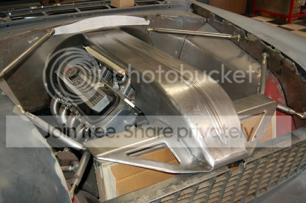

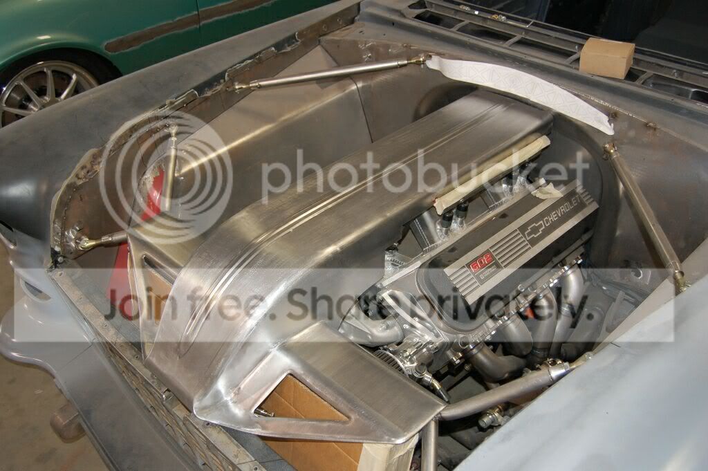

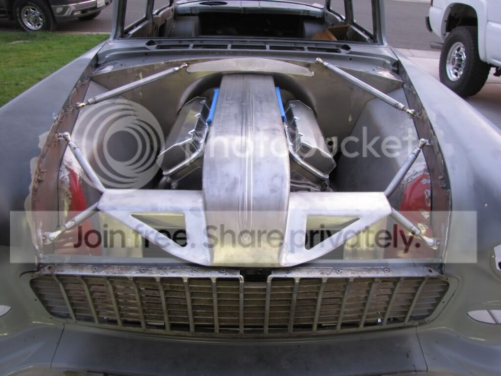

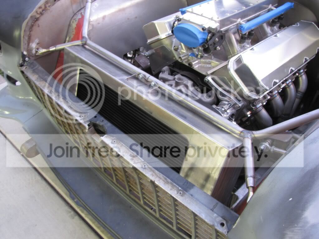

Thanks for encouragement guys!! Here are a few more updated pics.
I worked on the firewall this weekend. It's not in final, but this is the
direction I plan on going. The center piece I bought. I'll just piece some
sides in to make it go all the way form side to side. I had to put the real
motor in instead of the mock up. I was looking at it & thought the heads
looked a little different. We'll I'm glad I did, turns out the deck height
on the Topline heads are a little over 4", where as factory GM heads are 3.5".
That could have been a costly one...
