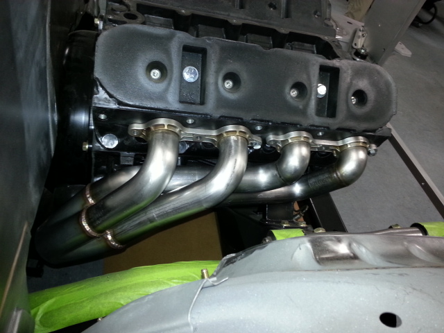

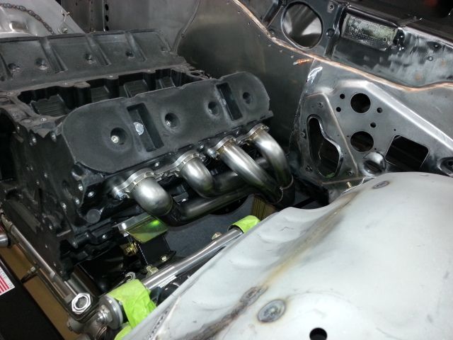

looking to hopefully buy headers soon for 69 camaro w dse sub , solid body mounts, ls6 , t56 mag combo. I love dse headers but $$$ is holding me back anything else out there that would give all the clerances needed especially the collector to floor.also would like to get 3" stainless exhaust kit that I can rework to meet my needs ?
any sugestions

I'd save your money Frank.....there that nice.

Hands down the sweetest set up for a DSE sub car. Fit/finish, clearance...you name it. Lemons/others custom headers cost the about the same. Maybe just buy a one brand at a time from Summit and return if they don't fit to your liking?
