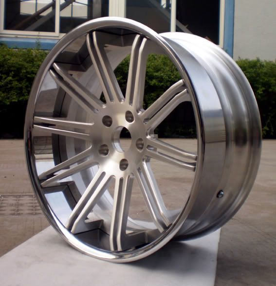

Originally Posted by Rybar View Post
Thoose look pretty sweet, seems like your putting alot of work into this car and only a 10" wide rear wheel? Might as well mini-tub while your there.
Those are more of those cookie cutter "made in the usa" wheels that are actually made in China and assembled here. Theres a bazillion Miami and California wheel importers making wheels like that and none are JWL or TUV approved. Be careful with those and inspect them for cracks regularly if you use them.
Some of the companies known to be a part of this are iForged, ADV.1, Cor, rotiform, Strasse Forged, 360 Forged, Sevas, New gen (yes, those too) etc. If you look through all their portfolios you will see the same wheels over and over. Rotiform is actually pretty unique, but you can tell they use the same wheel blanks and construction methods as all the other companies. Kind of a shame because tehyre very nice looking.

Anyway, Im not saying they're bad wheels, but Im saying they're not tested to any kind of standard at all. Just keep an eye on them if you use them for any kind of track use, and dont count on any of those companies taking care of you if something happens. Cor changed their warranty after their infamous failure at a track day (on street tires).

Look through all those companies' wheels and you'll start noticing all the similarities. They all come from the same Chinese plant... the same 2 or 3 assembly methods, and looks like most come from the same 2 or 3 blank designs iwth the same "concave"ness to them.

Take this from someone who has been there and done that...mini tub your car while you are there. I did not the first time I did my car and I had to go back to do it...at a very large cost. Pictures are different than real life and the 335 rear do not look to large. Tub it for 335's even if you are not going to run them. If you ever sell, I would be the buyer will want 335's on the back. Can't remember what motor you are going to run, but anything over 400 hp at the wheels will cause traction problems without the larger tires.

I spoke to the guys at the shop and they told me they are going to mini tub it later in the build when they create the custom chassis rails.
In the mean time, what they have done is beat the inside of the outer tub out so that its closer to the outer quarter.
This will allow me to run the wheels nicely tucked with less chance of rubbing.
So I get best of both worlds
And 3 piece wheels means I have some flexibility changing the widths too.
Amit
