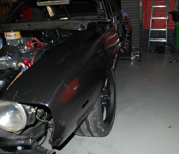

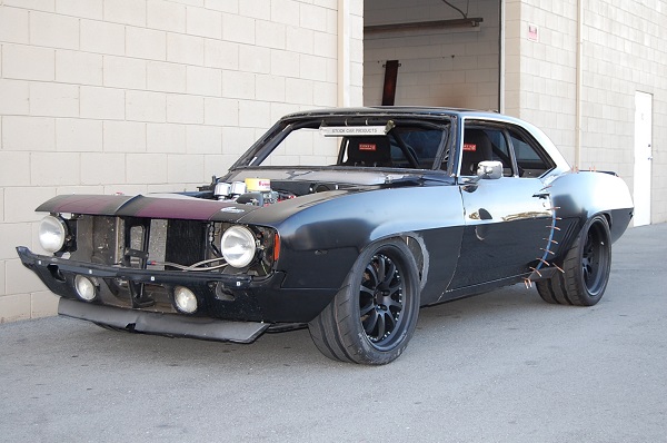

This is a customers ex-Silver State open road race car that we are doing some work on.
It came in for a quarter panel, fender replace and once over.
Here is how it came to us.
The fenders and quarter panels were "modified" to clear larger tires.
Follow along as we transform this one to a reliable HPDE and open track car.
A bit rough but a great base.

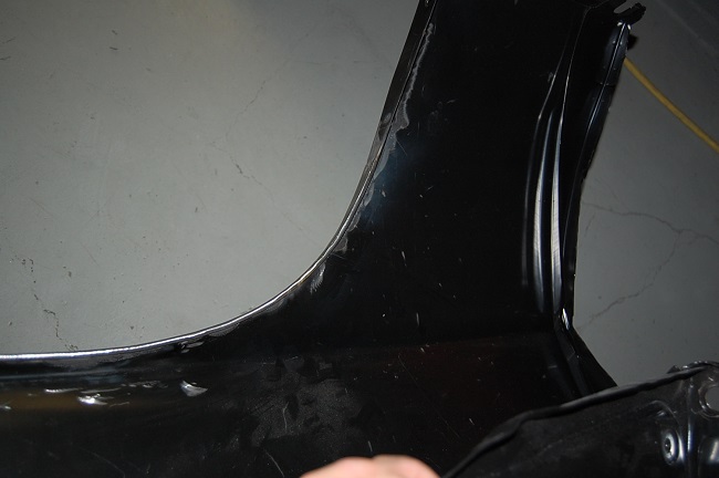

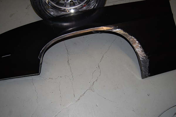

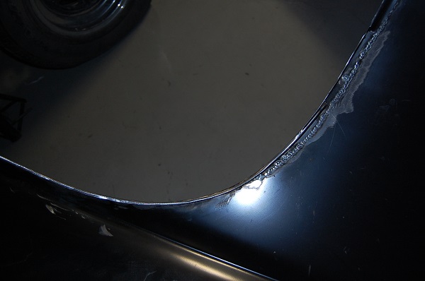

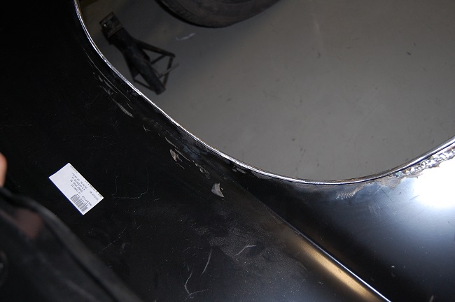

We ended up having to cut the fenders off. It was partially welded to the body.
Parts are on order now that we know what we need. A quick call to AMD and we should have the pieces in a few days.
Once stripped down we can give it a good look over and safety check.

Once the body parts came in we got to work on figuring out the wheels we could use.
The customer happend to have several sets and brought them in for fitment. Unfortunatly most had offsets that would not work with the front sheet metal and front suspension.
Back to the drawing board.
