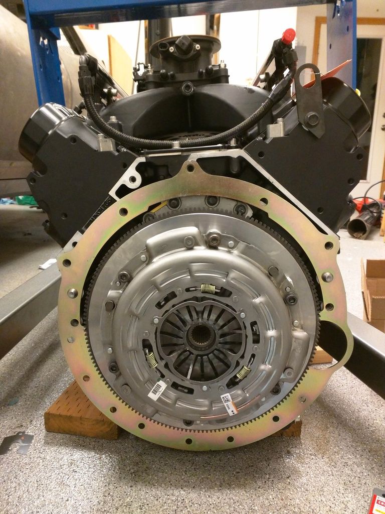

I spent some time sorting out parallel and concentric alignment on the bell-housing. I ended up with a few shims to get things within spec. The concentric measurements were good to go so there was no need to get offset dowels.

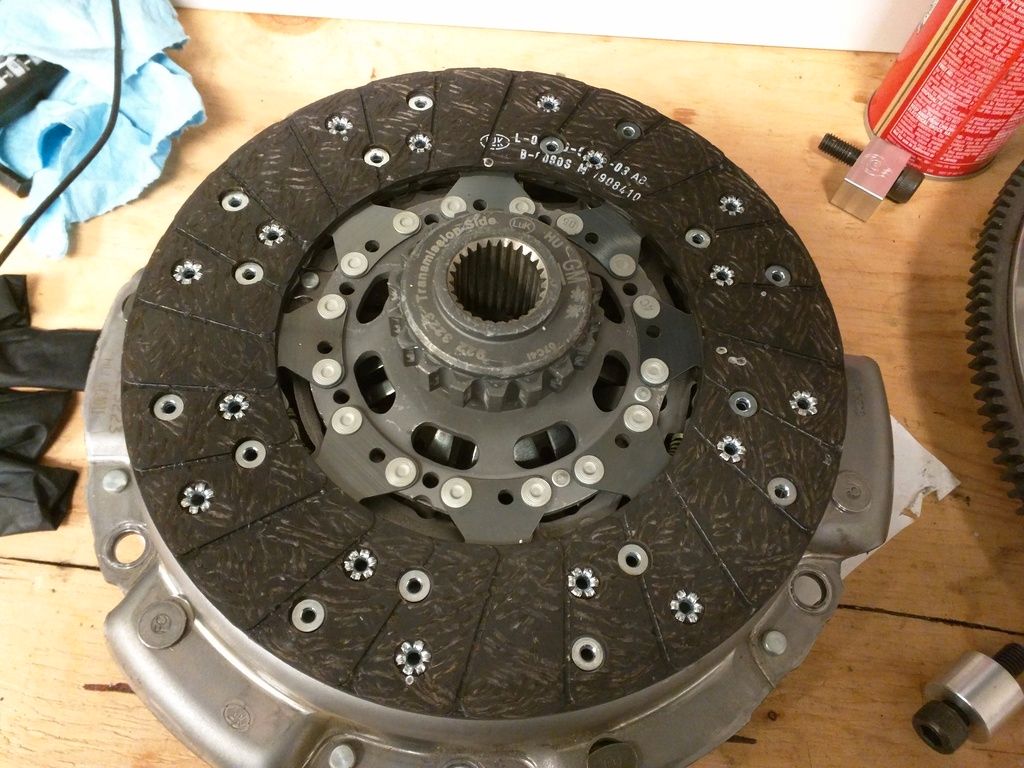

Ordered up a clutch and go it installed. It's a Monster LT1-S. It's basically a C7 clutch with a custom billet steel flywheel and some other little bits. I've heard good things about it so I thought I'd give it a go.

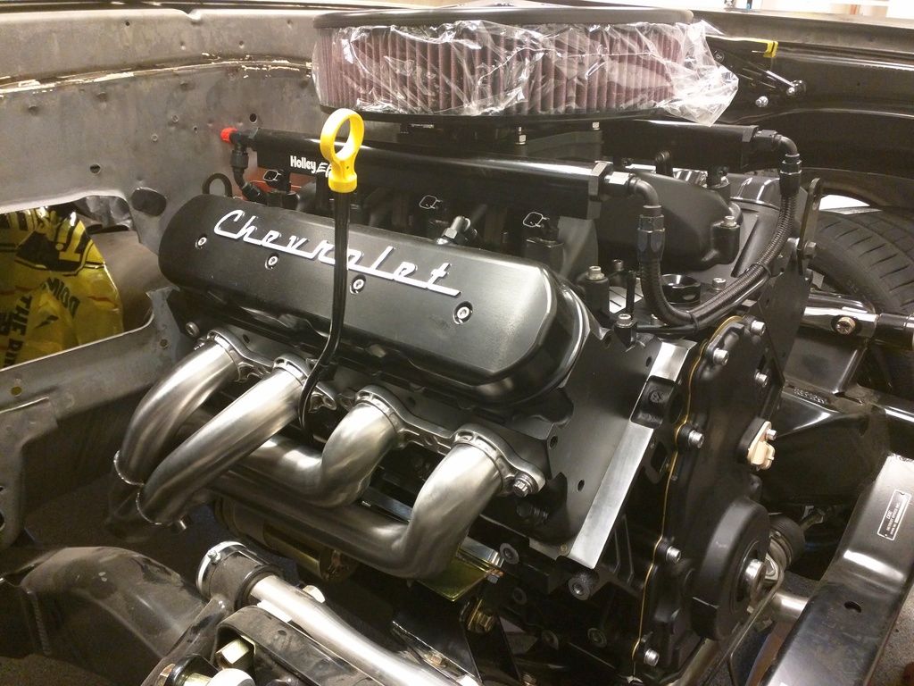

Motor/transmission are in. Looks like I'm going to have to do some firewall work to allow proper clearance for the fuel rail feed line...oh well, probably wouldn't hurt to add some additional clearance behind the motor anyways.

Got some ultimate headers and brake booster mocked up. The fit leaves TONS of room.
