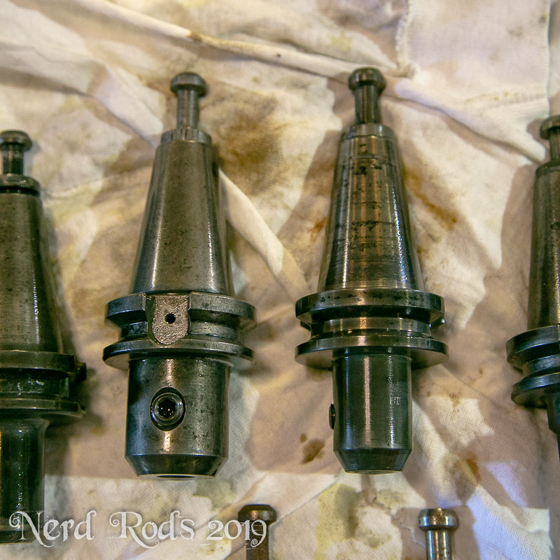

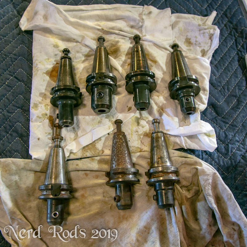

Working on getting my my CNC Mill up and running. Doing a little rust removal on the tool changers. Cool stuff, Evapo-Rust. No crazy smell. Just soak the parts for a few hours or over night in my case. Results speak for themselves.

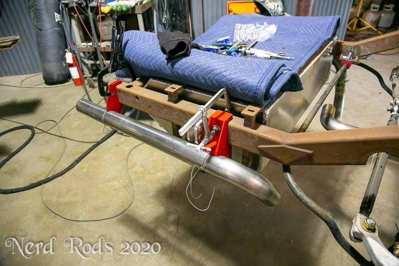

a 3D printed Jig for an exhaust I was fabricating up. It holds the exit tube in place while I play connect the dots between it and the mufflers while clearing the swaybar and fuel tank.
Then a guy online challenged me to simplify my design and speed the print up so that's what I did.
This made this part of the job super easy so I'll probably use this as part of the kit for anyone looking for a DIY exhaust for my frame.
