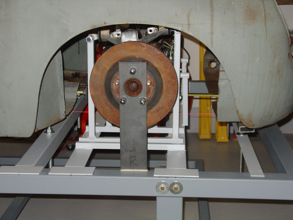

Slow today. Had to modify the front susp cradle to fit over the front jig legs. Couldn't get much room that way - so I repositioned the entire car to compensate. It works - just had to redo all the adjustments again.
Installed the front suspension and rack. Front suspension will need to be pulled inward like the rear to clear the fender lines.

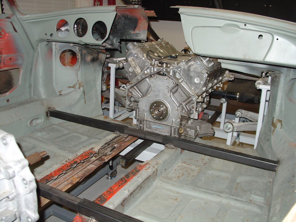

Snowed in today - so, I installed the motor. Set the engine .5 inch off the back of the rack and centered. Looks like a 3 inch inset replacement firewall will do it. The footwells are looking like a cobra deal though, very tight. Now I can take measurements for shortening the torque tube. Wish I'd done this kinda work years ago - it's a blast !! (but I'm really tired of the rust and green primer)

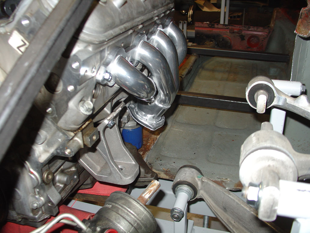

The Hooker LS1 Block Huggers worked just right - they look tiny though compared to the monsters you guys run. Just one more compromise in this journey. The pipes should route fine.
Need to replace the batwing pan with a camaro pan so I can run a 2.5 exhaust into the backbone.
The torque tube is out to be shortened at a local IND shop. Shortening it 21 inches total.
This weekend I remove everything - rebuild the suspension jigs so they can be moved inward - and then put it all back together again for the final measurements.
