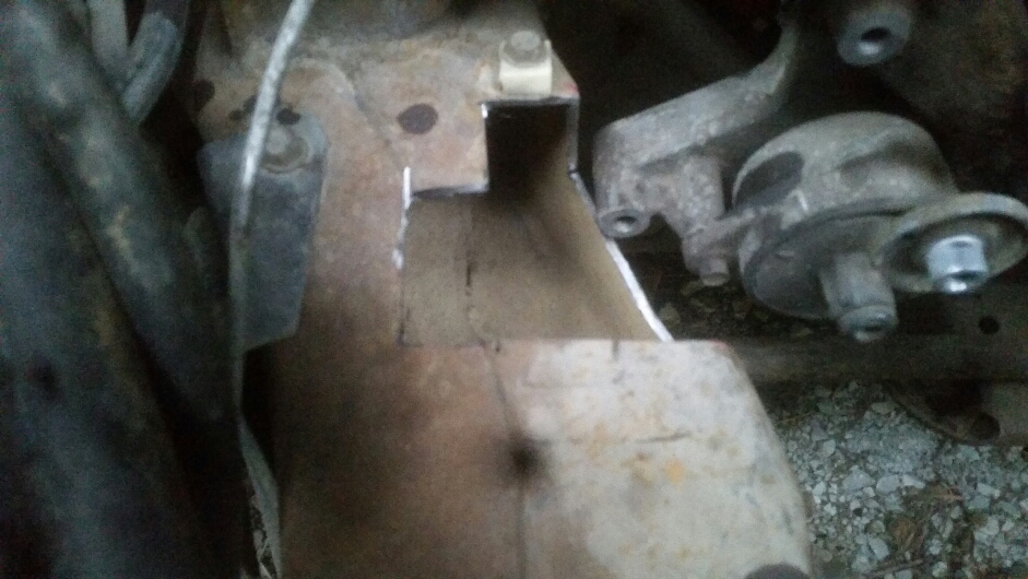

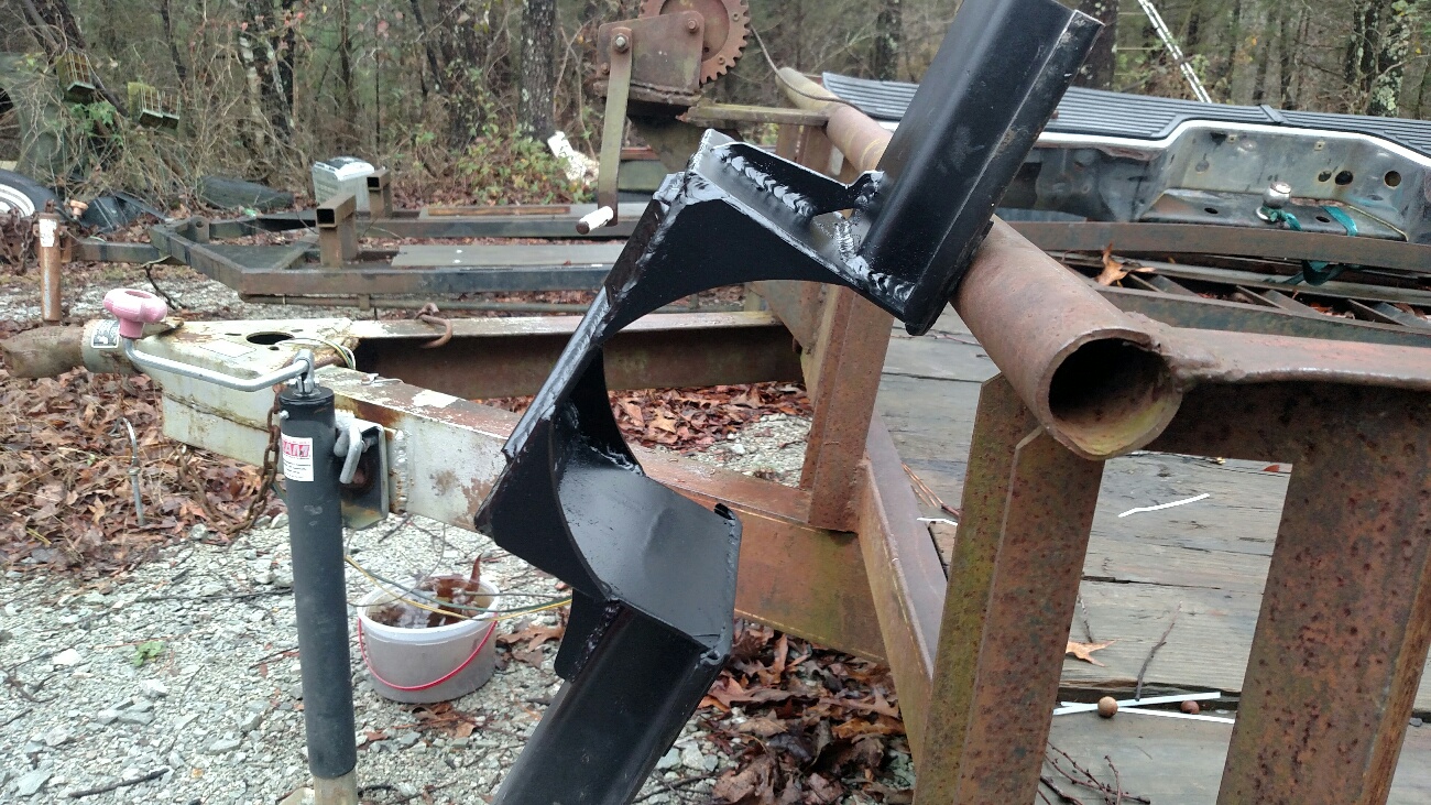

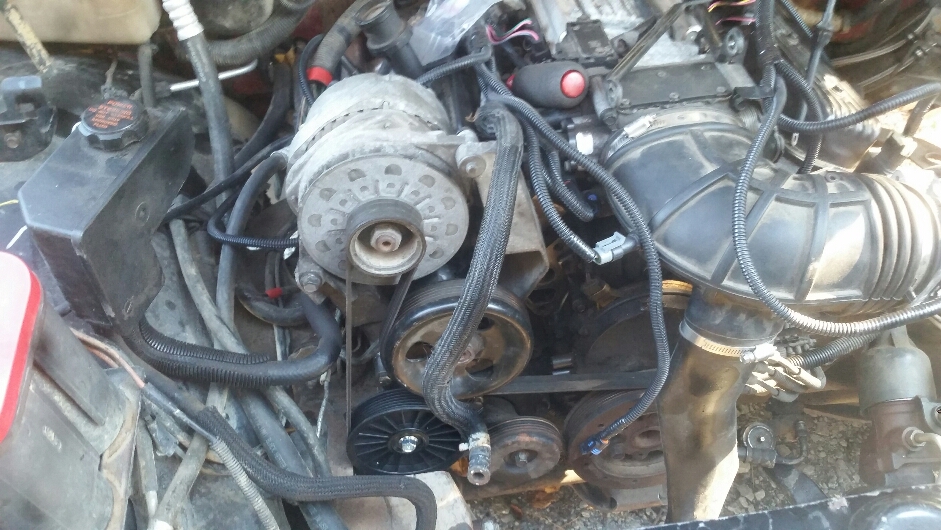

Decided to just notch the frame for the Z28's accessory bracket to save on costs and time.
Later I will box the frame back in.
Name:  2016-10-22 10.55.42.jpg
It is notched to fit the 1LE pulley plus with the Z28 power steering pump one of the lines will reach the truck steering box and the other is about 8 inches to short so to reach i'll get a new line made plus I'll need to make a bracket for the reservoir.

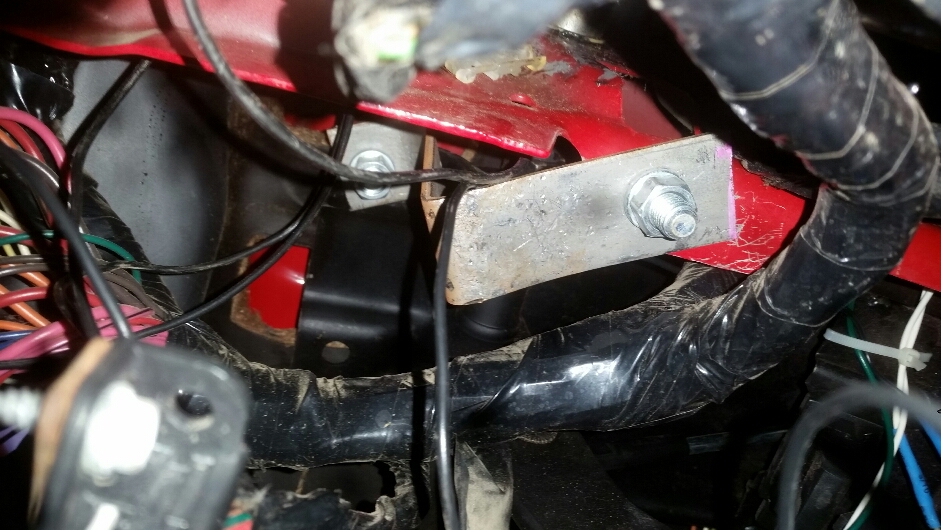

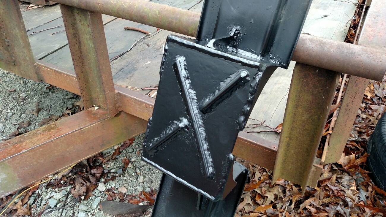

And here is the clutch pedal bracket support brace I made out of some flat steel from the part store and just made a z out of it to hold the bracket up and solid.
Also turn the engine over yesterday so now it just a matter of time before it's running and running down 4.6 Mustangs.

Ok here are the parts I used
•Stock replacement Z28 Zoom clutch kit #MU70043-1
•The stock 15lbs Z28 flywheel(just had it turned)
•Dorman Slave Cylinder #CS360052 (1996 Z28)
•Russell Clutch Adapter quick release fittings #640281
•Earl's 45° -3AN hose end #604693ERL
•Earl's 90° -3AN hose end #609133ERL
•Dorman master cylinder #CM126856 (1994 C1500)
•Earl's Speed Seal -3AN hose
The master cylinder and the clutch pedal are the only thing used from a 1988-94 C150 the rest is made or used from the Z28.
I don't know how the Tilton is made but I used the stock replacement master cylinder with the Russell quick disconnect fittings ti go from a hard line to a -AN line, the 45° is a stainless steel hose end but the 90° fitting is a aluminum and the reason for that is it would have taken a month for them to order the 90° in SS. As for the brace I had to make because there was no manual clutch bracket framing under the dash as I was told so I just made it and it is pretty solid.

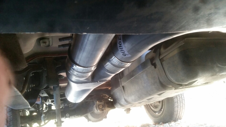

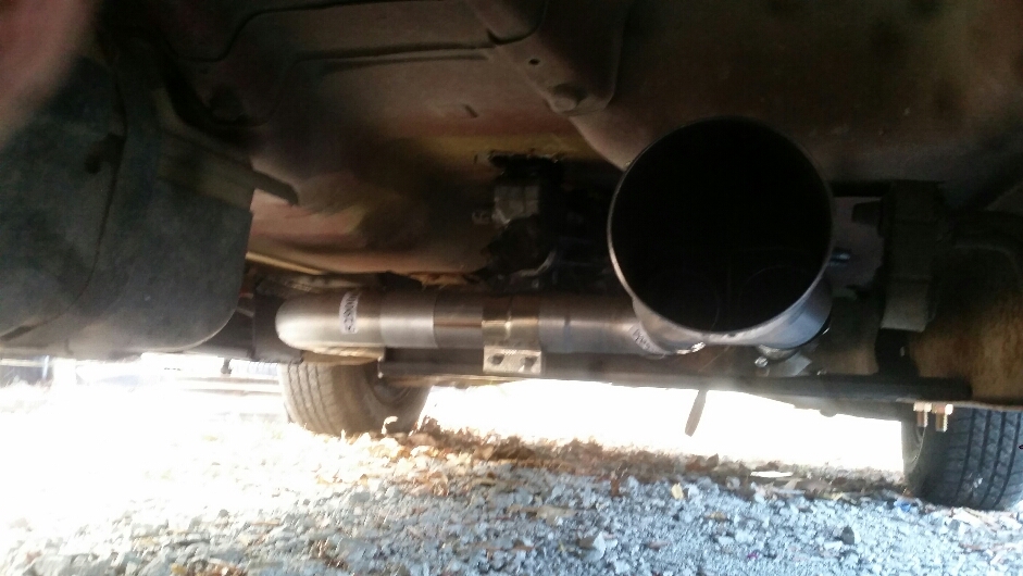

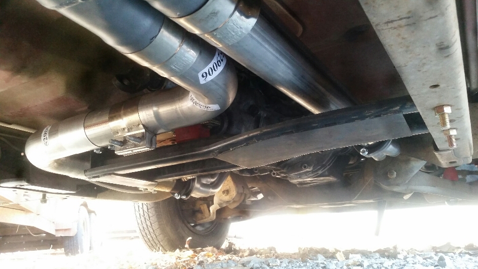

Got the exhaust mostly done to at least fire the engine up this week. Its a 3inch exhaust with both pipe going into a Flowmaster merge pipe and it comes out a 4inch to what will probably be a Flowmaster muffler.

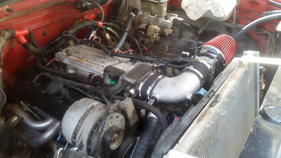

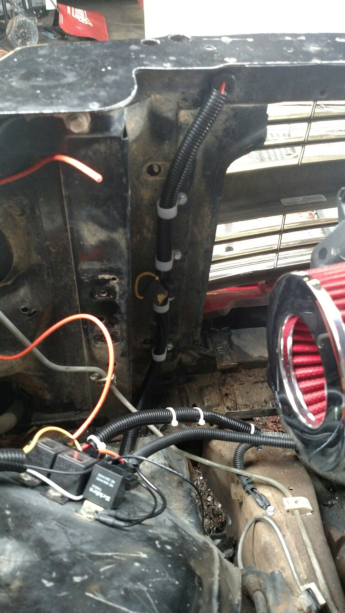

Here is the air intake done on it with a $44 ebay aluminum elbow and a part store Spectre air filter with the cool choose your size that will fit a 3in, 3.5in, or a 4in inlet size.
Name:  2016-11-12 00.38.11.jpg
And the merge pipe in all it's glory.

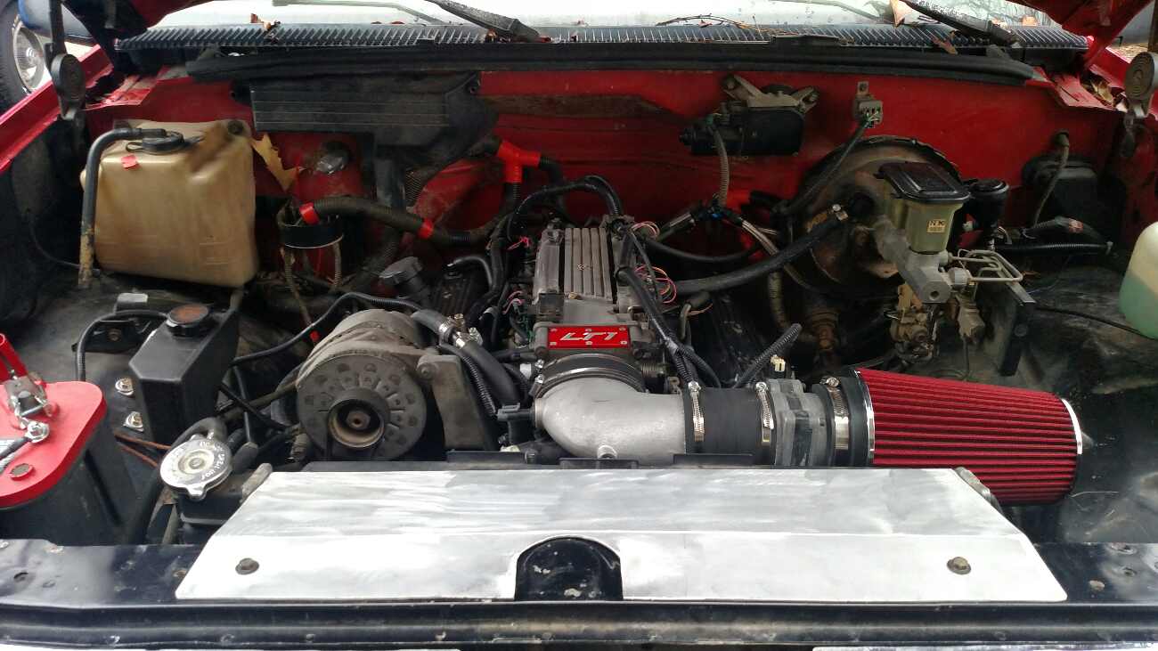

Built a new radiator support top made out of a old street sign. And then got a big tach mounted on the bottom of the dash.

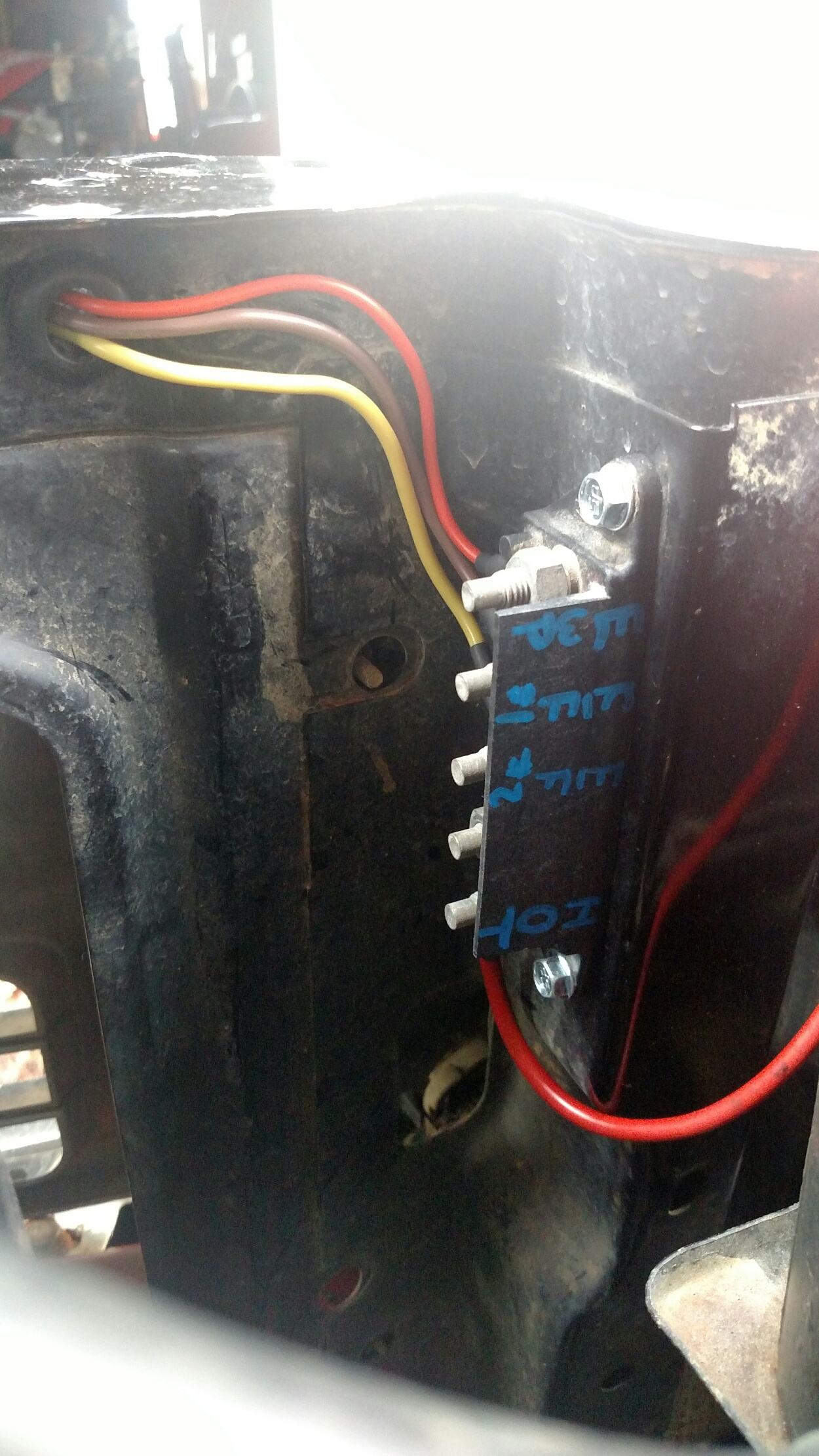

Then proceeded to get the water pump wired up and the #1 fan wired up and #2 lacking two wires bit with the rain a weather I haven't been able to finish it yet but it's alot cleaner than most of my wiring in the past.

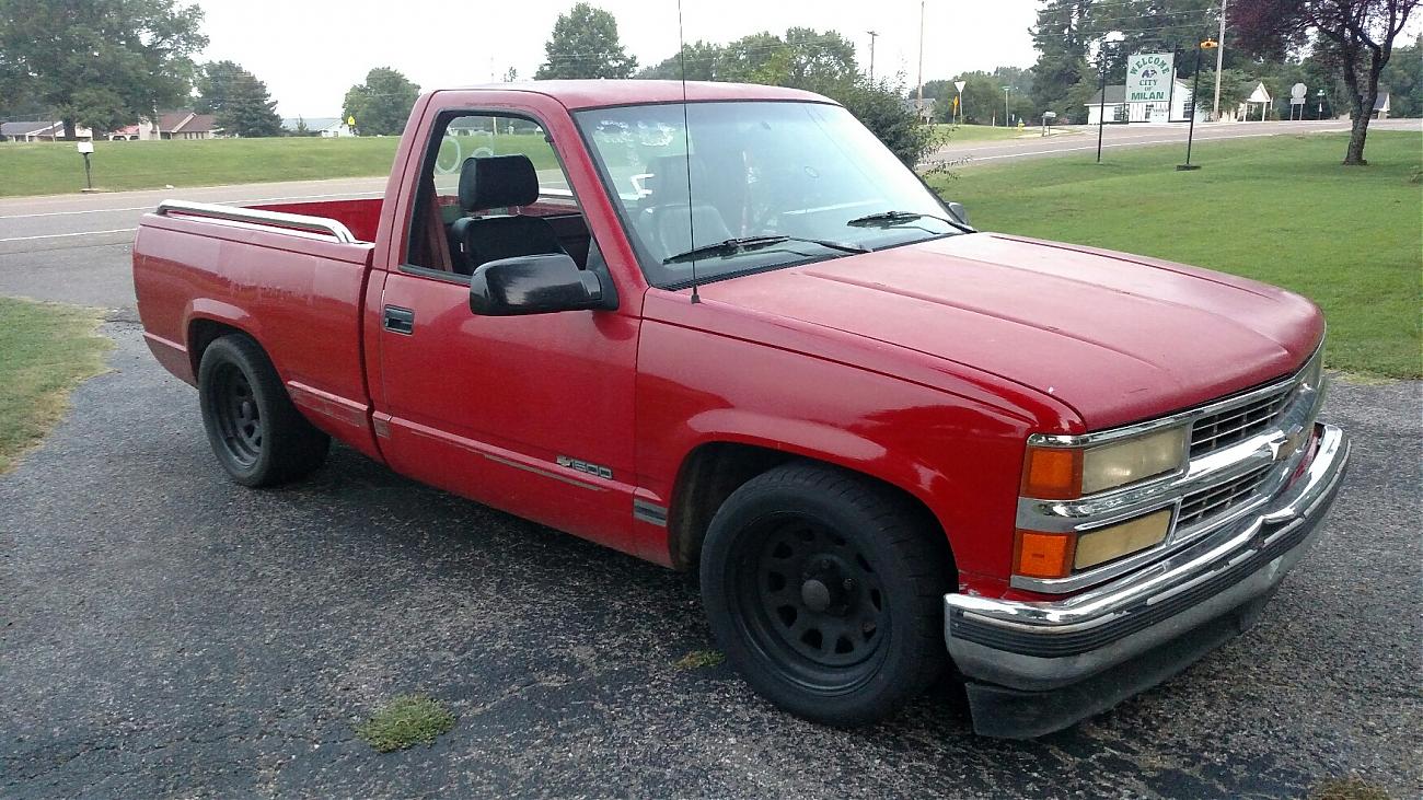

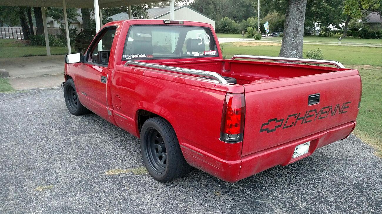

I finally got the rearend built with a eBay posi, stock axles, Motive 4.11 gears, Moser main cap studs, Strange forged 1350 yoke, and Little Shop 10.5in disc brake kit.
Attachment 62871
With the rear flip kit done and some 285s on all four corners the truck is almost done for now except for a bigger front sway bar and double adjustable shocks.
