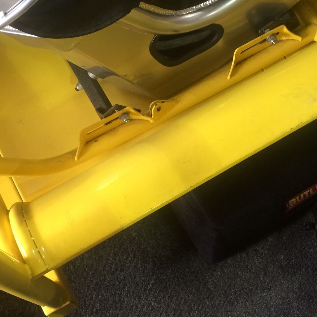

How are the seats mounted to the floor?

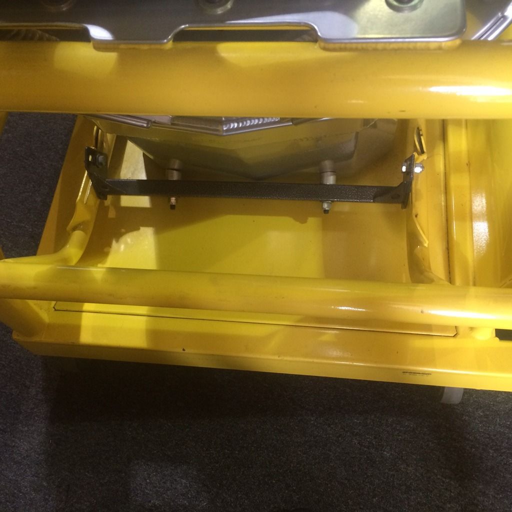

I have DOM bars that connects to the cage and runs along the floor. From this, Butler sent me tabs to weld on and then a 1" .063 square tube bar is attached to the seat. Like this (not my car, but snapped these at Butler when I was there):

That front end is a thing of serious thought and planning. I don't even know how to cut the slots for all of those adjustment slugs, but wow, the level of precise adjustability on all of the parts is just nuts. I'm also impressed with the diversity of tubing (no bendy round tube!) used on the subframe; I've been trying to use more 1x when it's possible, along with thinner-wall tubing. Clearly, Ron Sutton knows how to calculate where you need what for certain load paths, which also helps in weight management.
If you haven't yet, you might want to compare the brackets used on Kirkey seats. While the sliding adjustments on the Butlers shown may seem convenient . . .

Do the Butler seats not have integral places to run bolts through on the sides like the Kirkey seats ? Been thinking about getting a Butler seat but looking at that picture I'm not sure I see any way to use my current brackets.
Do you have other pictures of Butler seat mounts ?
You drill the holes for the bolts on Butlers. They double up the aluminum in the area where you would attach them. Butler provides a sheet to tell you where they recommend you drill them.
