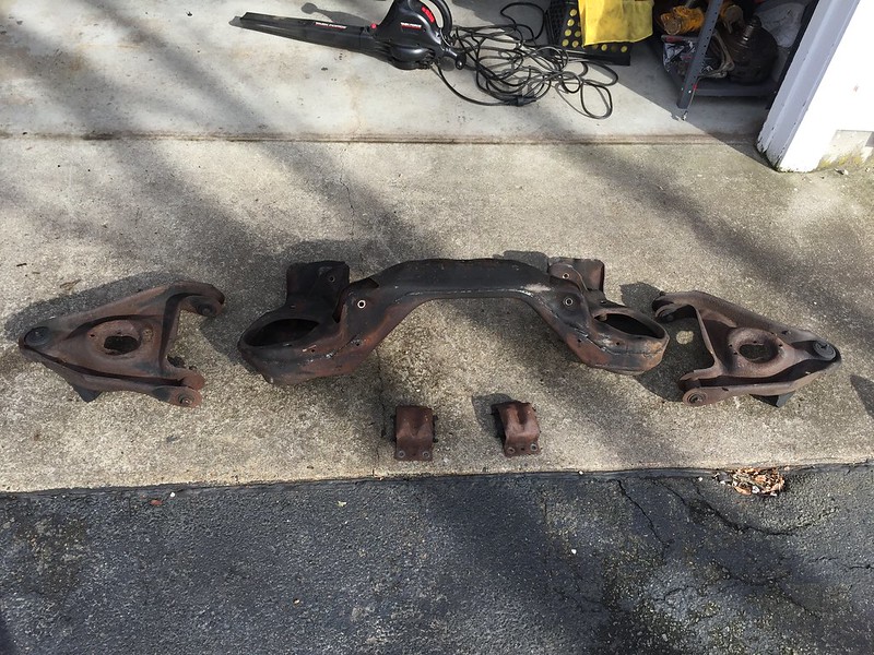

My first project is tackling the K-member. I used the same degreaser I used on the engine bay and hit it with the wire wheel and the paint came flying off! I have a little more work to do on it, and need to figure out a way to get the grime out of the inside of the K-member... might need to get creative there.
K-member all disassembled:
Stripping it down for paint:

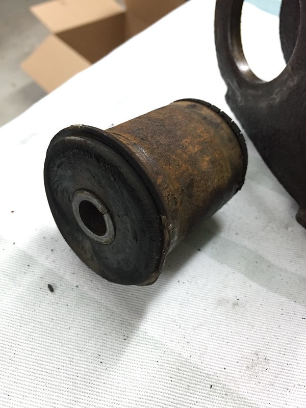

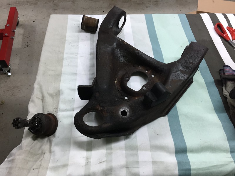

I had a busy week, so in order to keep moving forward I dropped my lower control arms off at a local garage to get the bushings and ball joints pressed out. I would have loved to have done them myself and learned a bit in the process, but I have to pick and choose my battles if I ever want to get this done!
In staying with my budget theme, I'm going to be keeping the stock lower control arms but rebuilding them with new components. For bushings, I am going to go with Delrin ones from Global West. Haven't tried them on anything and I am basing my decision purely on reading, but they seem to be the go-to upgrade for these cars. I like the no-binding benefits and am looking forward to seeing how they feel.
For ball joints, I am still torn. Since my car is lowered, it's causing my lower control arm to be at a different angle than factory (with the ball joint higher than the mounting point on the frame). In order to restore the stock geometry (which is essentially a horizontal lower control arm) and keep my lowered ride height, I believe I need to use a taller ball joint. However, I've been having trouble finding the proper part number and if these are even necessary. I'm going to keep searching, but if anyone has any info to save me some time it would be greatly appreciated!

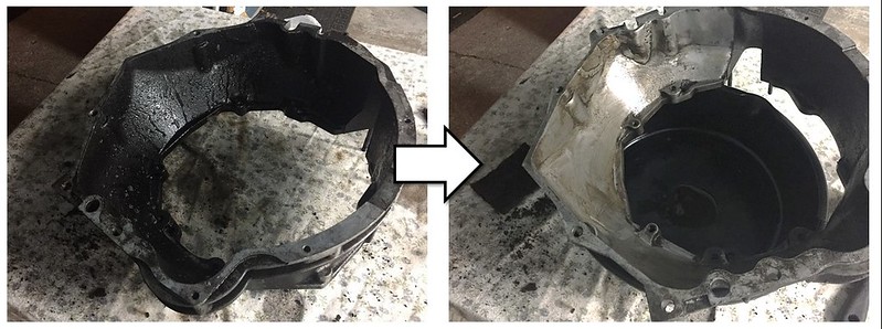

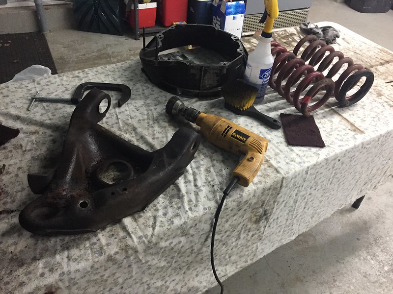

I moved on to cleaning up some other parts and getting them prepped for paint. I don't have my hose hooked up right now (still too cold) so I've going at it with just some degreaser, a wire wheel, some scuff pads and a ton of elbow grease!
Scraping the layer of oil and crud off the inside of the bellhousing. Think my rear main seal is leaking??
Getting the control arms cleaned up:
Hoping to get some of this parts painted this week so I can start reassembling them! Thanks for following along.

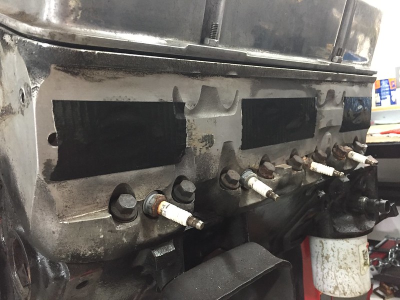

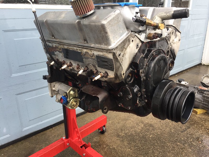

Busted out the power washer again this weekend, but this time on the engine, transmission and some other components that needed a degreasing. I was really nervous about getting any water in the engine, so I took some time to really seal it up with some rags and tape. I also left all of the spark plugs and old sensors in there to act as plugs for those threads... I'll be putting in new ones anyway before the engine goes back in.
Plugging up the exhaust ports:
All sealed up:
I hit the parts with degreaser and let them sit for a bit before blasting them with the power washer:
And the aftermath:
I was so happy to get this done this weekend, since we're supposed to get some cold temps for the next week or so. The big layers of grease and oil are off, so I can just work on the smaller intricate areas in my garage.

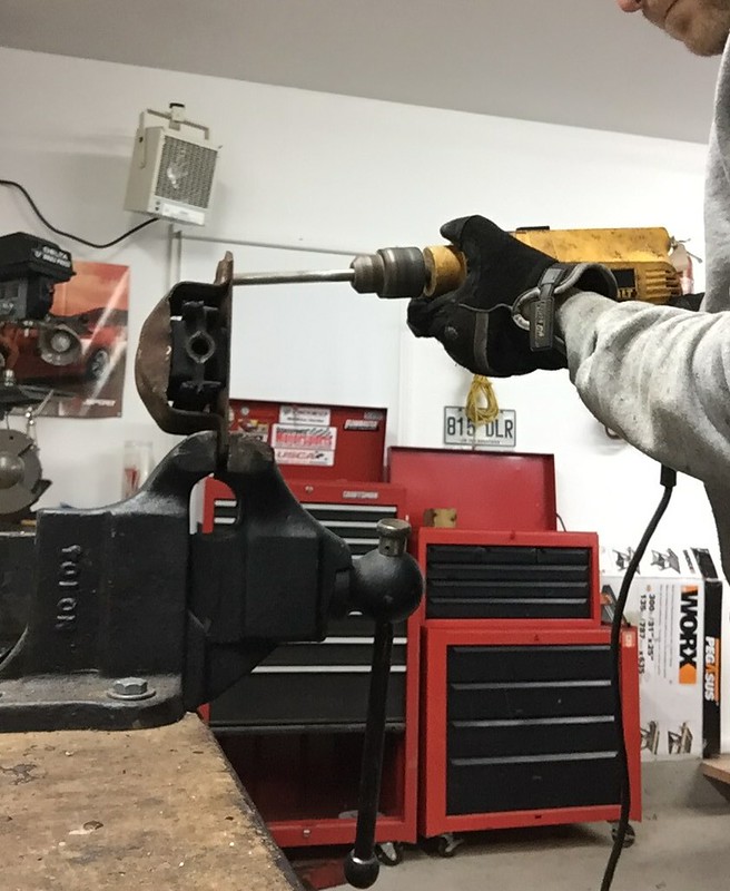

I also tackled a small job of taking apart the engine mounts. I'm going to be replacing the stock rubber pieces with polyurethane so I need to split them open. For those that haven't done this (I'm sure most of you have, but it was a first for me) you have to drill out the rivets that hold the 2 halves of the mounts together:
The rivets that need to be drilled out:
I know my drill looks crooked here!

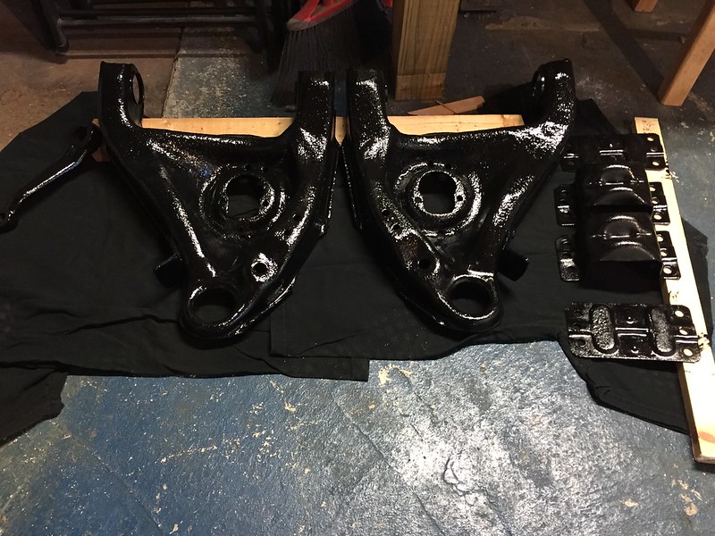

More progress! I have the final coat of paint on my K-member, the control arms and a few other pieces. I had to move everything into my basement as it's still pretty cold up here in the northeast. I'm using a Farm and Implement paint I got at Tractor Supply... it was super cheap and is apparently tough as nails. I'm not sure if I'm sold on the gloss finish though... I may switch over to a satin for the detail pieces in the engine bay.

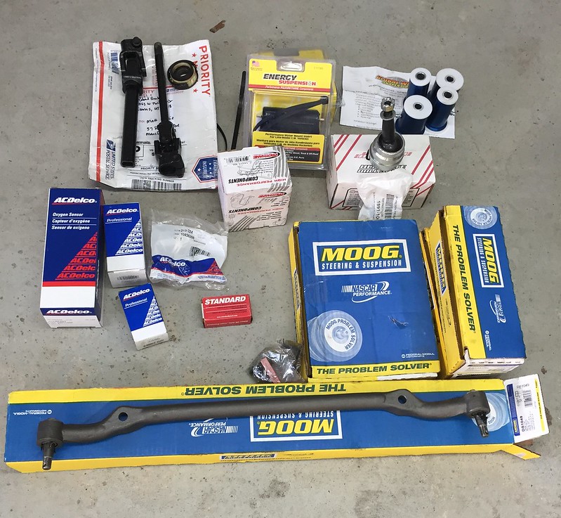

I've also been ordering a bunch or parts that have started to come in. Even though I'm on a budget, I've been trying to order quality parts for important things like steering/suspension components and for pieces that are hard to get to once the engine and trans are back in the car:

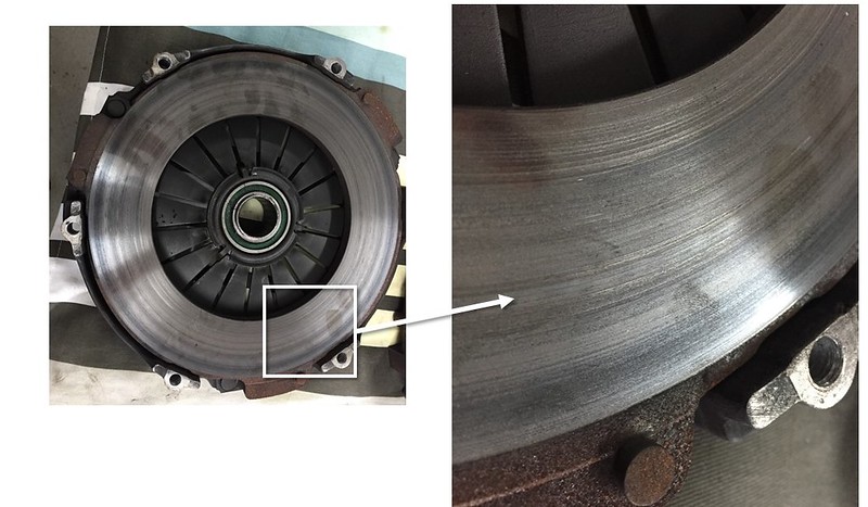

I was hoping someone on here could help me assess the health of my clutch. I tried to take some detailed pictures below. I have been contemplating switching over to an AL flywheel and perhaps swapping out my slave cylinder for something with a stiffer feel. I am going to call SPEC this week to see what I'm working with here but if anyone has any comments that'd be awesome:
Clutch Disk:
Pressure Plate:
Flywheel Surface:
