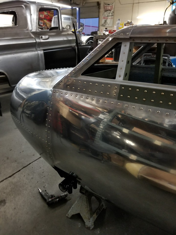

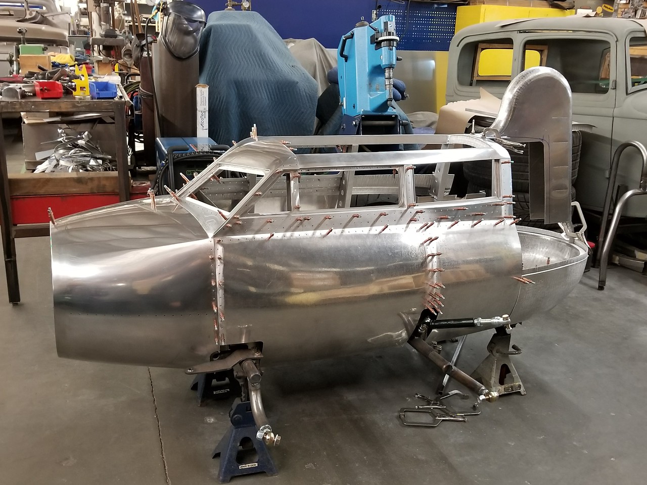

Any reason you used AD rivets? You could have used A's which are softer and may have been easier to shoot in the 3003.

to be honest, I only ordered the rivets based on the lengths I needed. I just asked my B25 guys what they used and went from there. they seamed to be easy. just a couple knocks with my riveter and on to the next.
