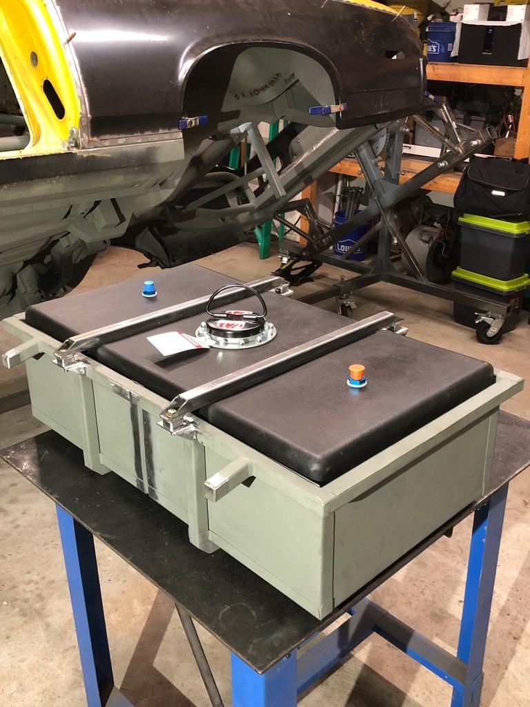

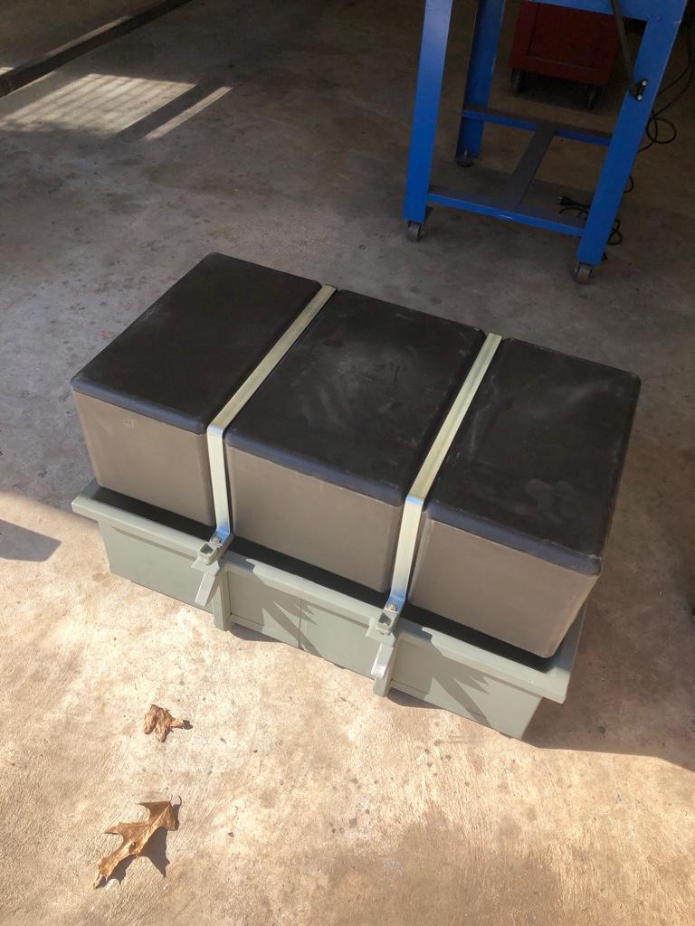

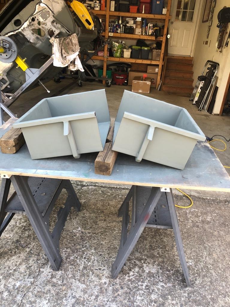

Since last update:
Had to deal with my fuel cell can. Cut it in half and extended the length by 1/2”. My 22gal. fuel cell fits now. Added some handles to the retainer bars and integrated the install straps into the design for lifting the cell out of the can. Currently working on closing up the trunk pan around the fuel cell can.

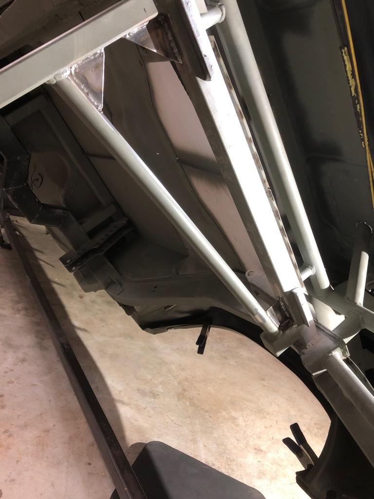

Decided to add some gusset tabs to the panhard bar chassis structure. Not sure why, just looked like it needed it. Better safe than sorry kept going through my mind. The Strongarm tools Mag tab tool is the ticket for gusset and tab work on tube chassis!

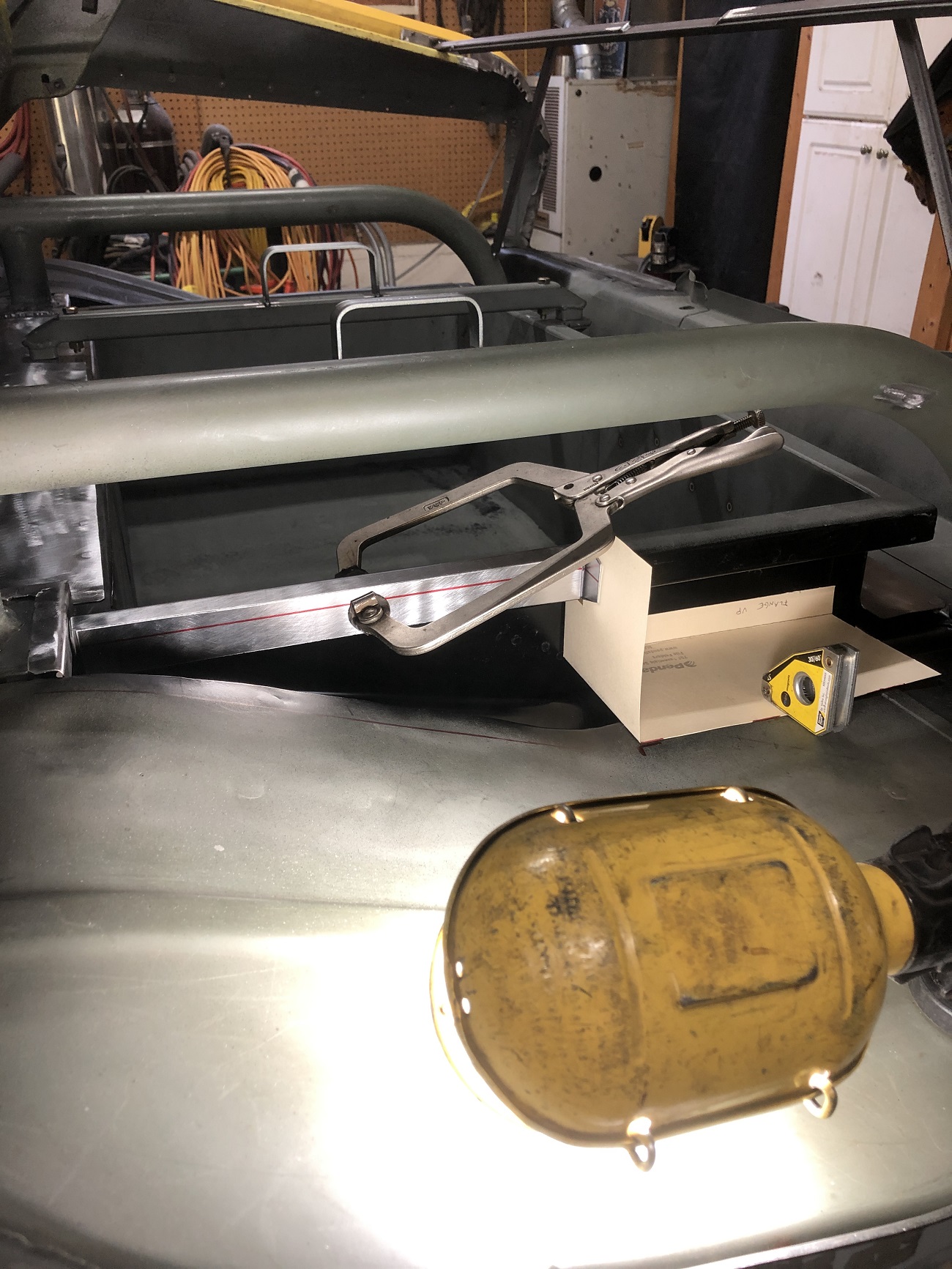

I finally finished getting the fuel cell can welded into the trunk plus closed in with sheet metal. The sides took some thought to figure out how to deal with the sloping trunk pan.
