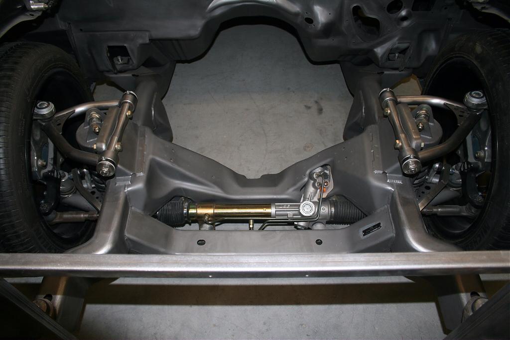

Fits like a glove!!! Sorry for the poor picture quality !

Very nice but you can't just throw up some pictures and just leave it at that!! Why did you cut the frame up??
In order to fit the tires and back spacing on the wheels it's cheaper to put the frame on a diet then it would be to widen the fenders. If you widen the fenders and then someone hits it gently it would be a huge expense to repair. Being that the frame is tucked in there is last chance of damaging the sub-frame.

Thats a slick fix for more tire in the front. Nice!

Nice job. Did you need to change/modify the steering rack to compensate for bump steer?

Not one bit ! The rack is from DSE, for there Nova sub frame.It bolted right in!!!
