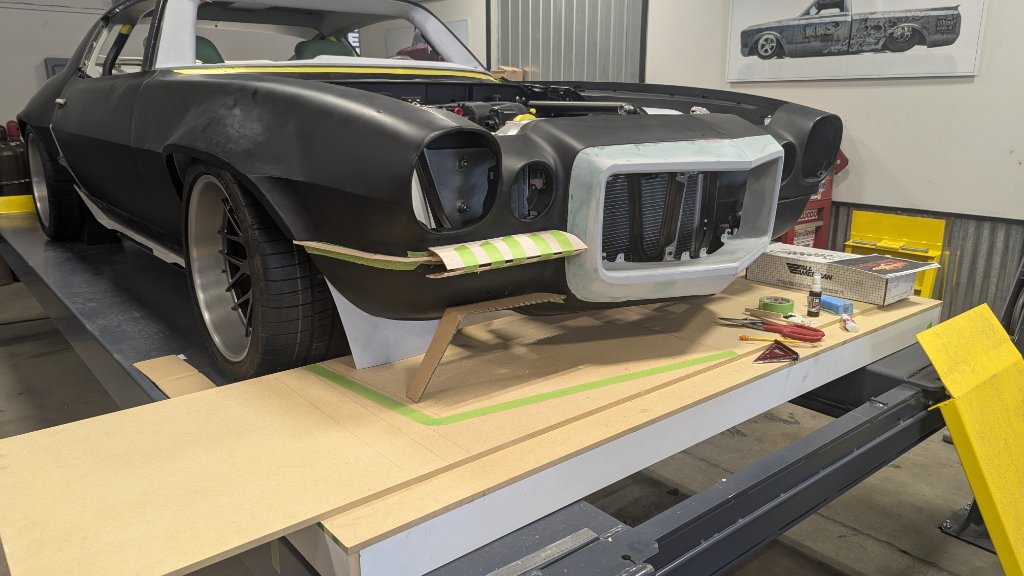

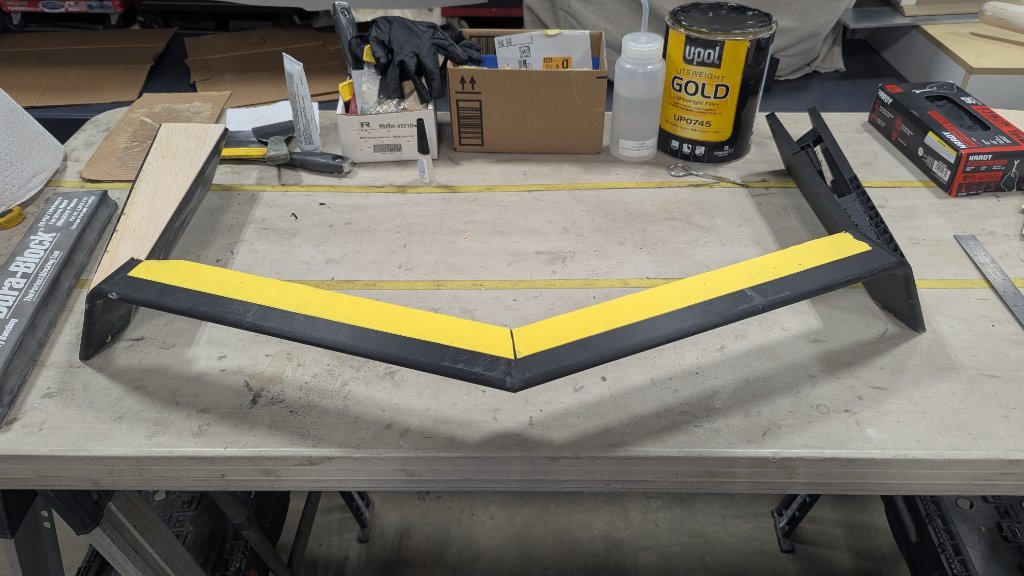

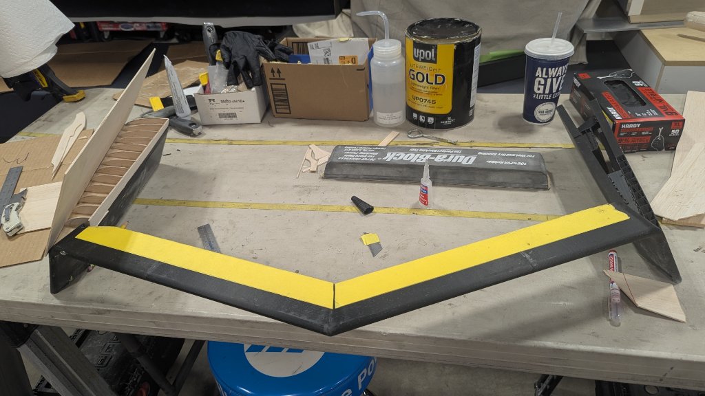

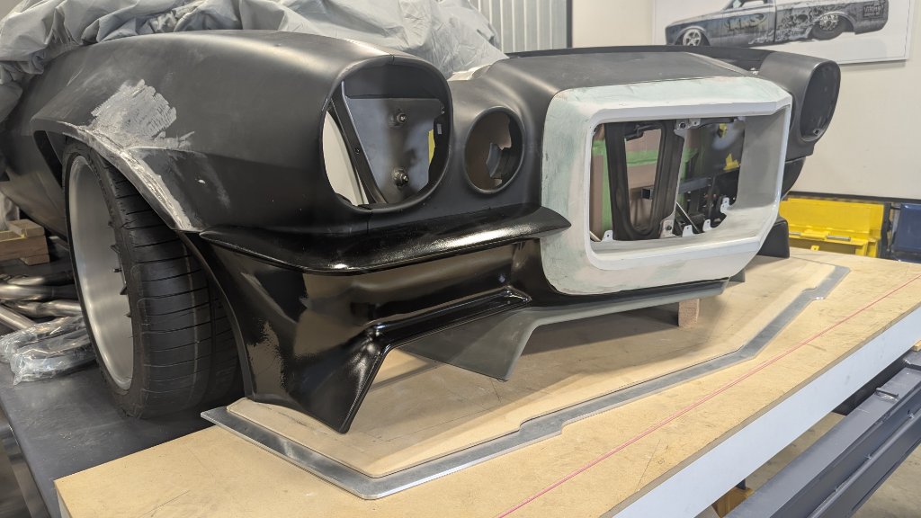

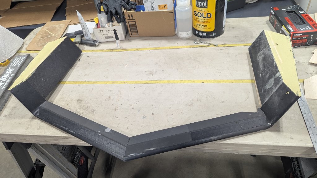

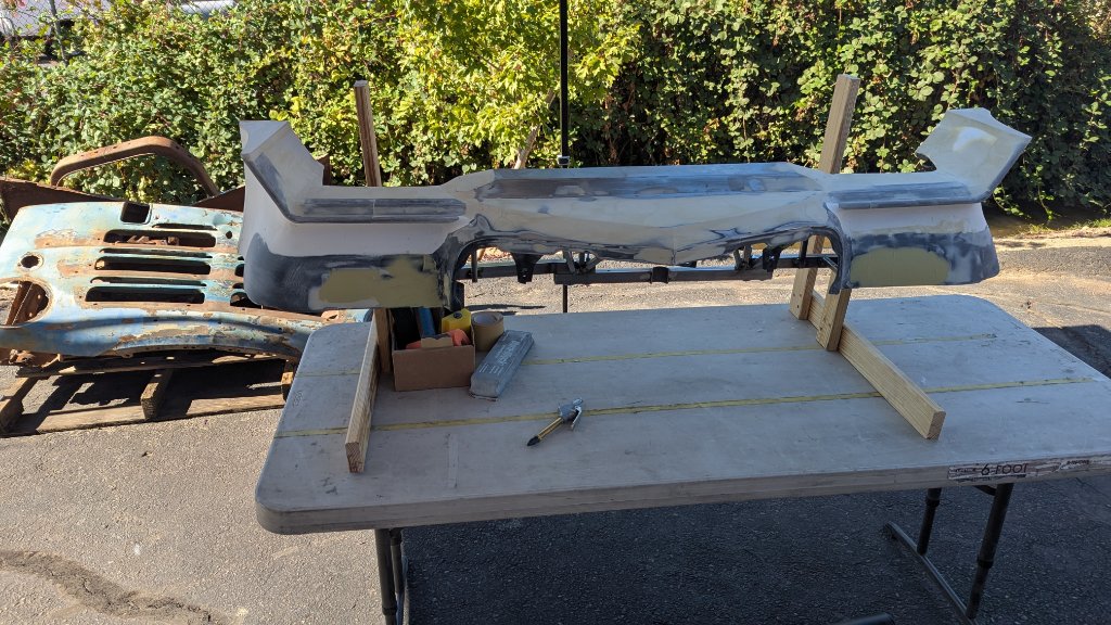

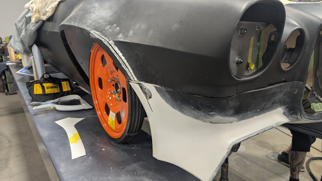

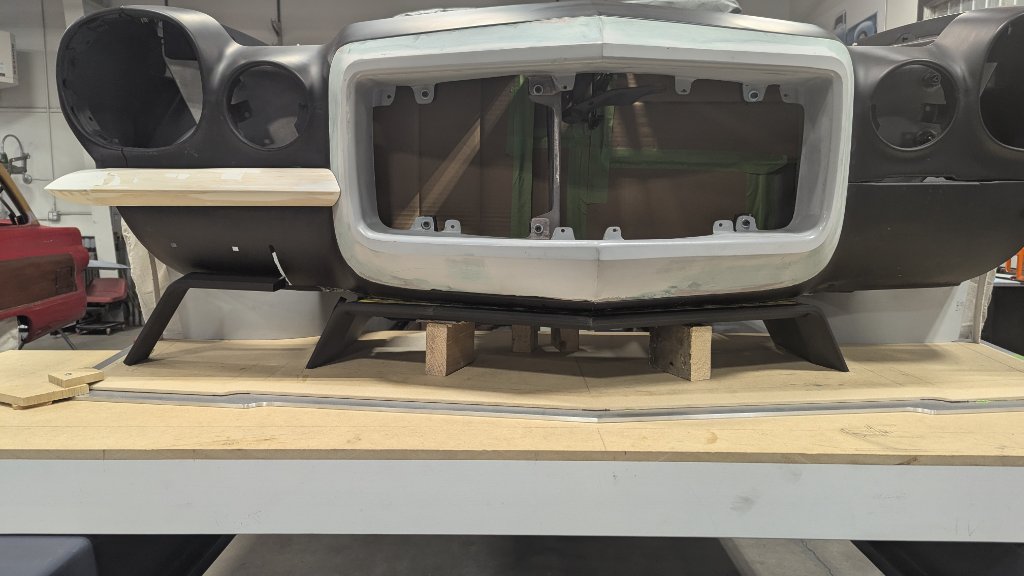

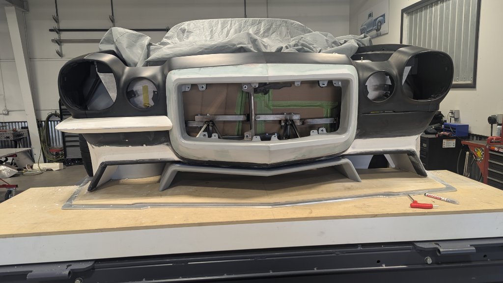

Starting the plugs for the bumperettes and front spoiler.

For making plugs with anything soft like balsa, drywall mud is your friend. Sands like balsa so you don't over-sand.
Might have been able to do this whole thing on the printer but likely just as quick and accurate doing it by hand, some printed parts and some hand formed. Fairly square and symmetrical but as you can image the center line of the nose isn't perfectly centered so playing the compromise game to get it better.

First pass at primer and blocking to confirm shape works. Will crisp up the lines and flatness, then a mold.

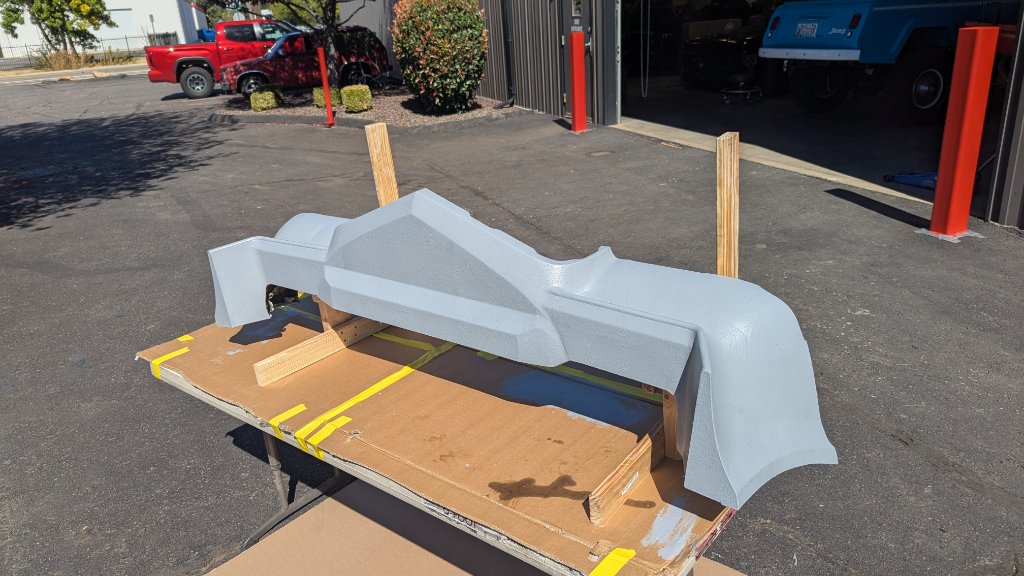

Final sweep with body filler and drywall mud. I like drywall mud for making plugs in some cases; it's cheap, sands super easy, allows easy shaping of complex curves and for sure it's the only way to go when using balsa as they sand very similarly.
A handful of heavy layers of filler primer rolled on, final blocking is next. And then onto making the mold.

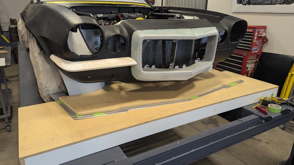

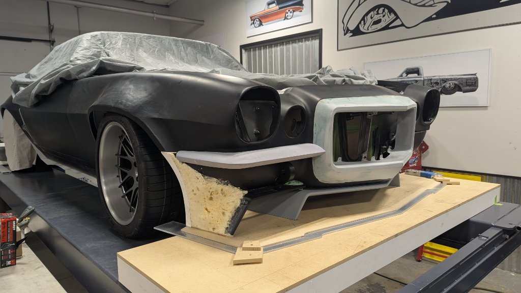

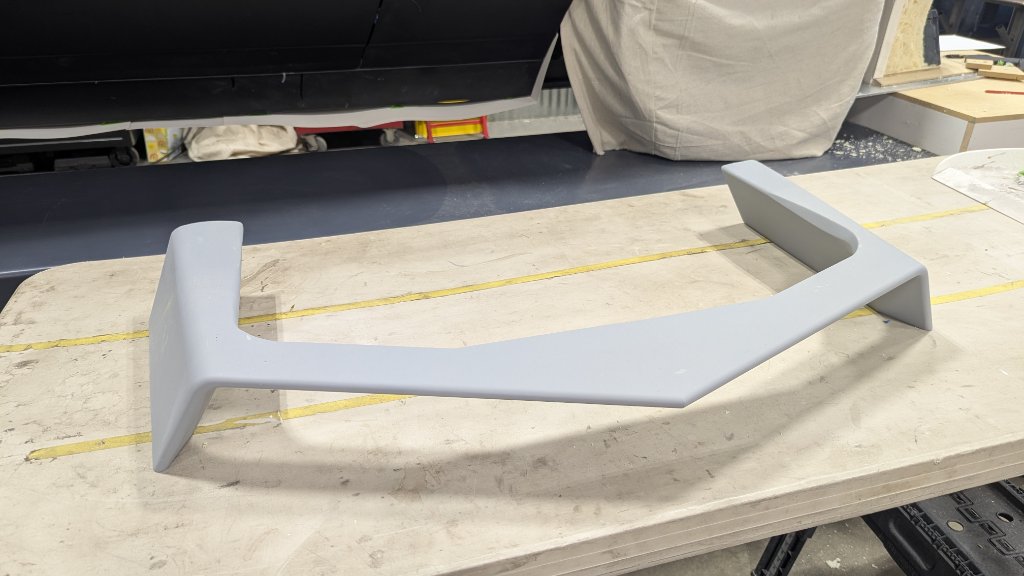

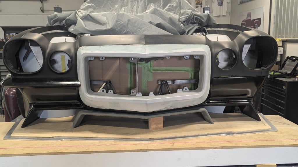

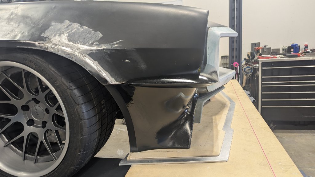

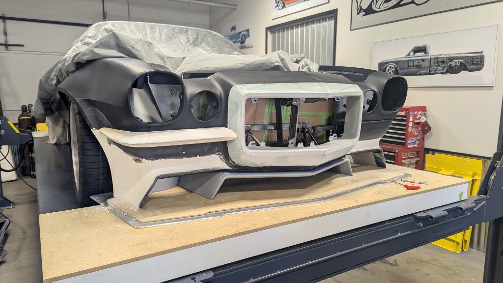

Final test fit of the spoiler and bumperette plugs before mold makin'....

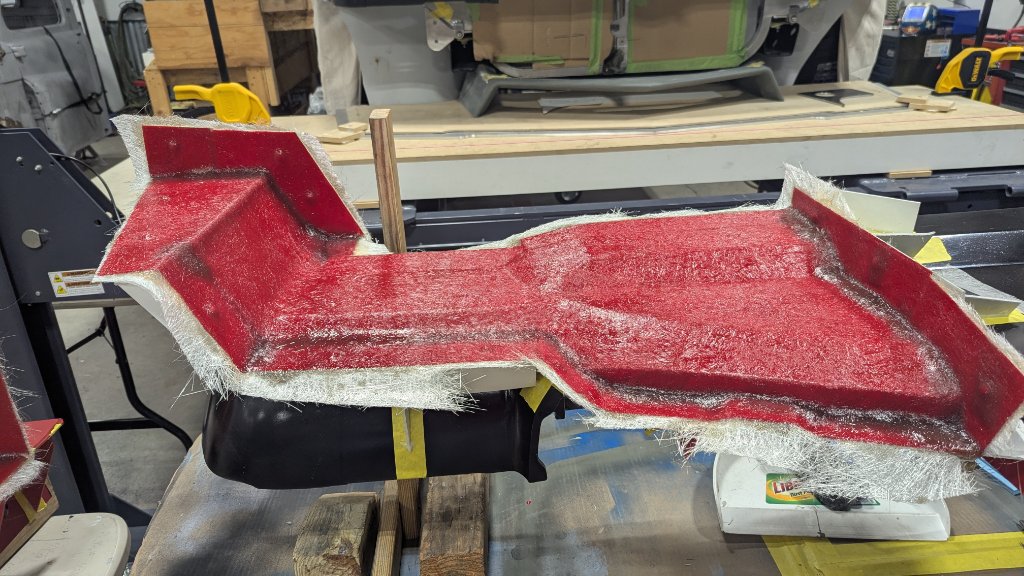

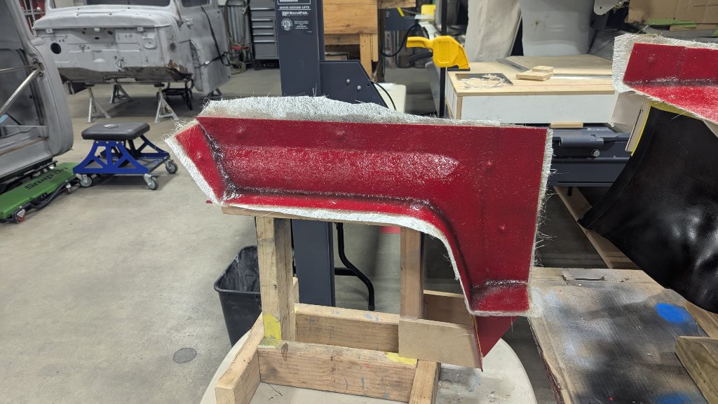

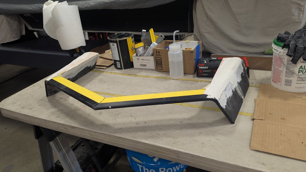

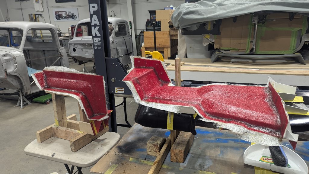

First sections with gelcoat and the first layer of glass. Long way to go, best to do only a layer or two, maybe three at one time so curing is more stable. Just time, right??!!
