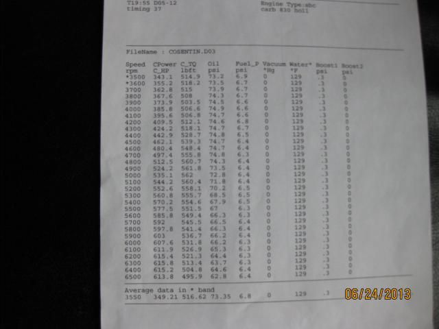

First dyno on a DTS 4000 back in May of 2010. Timing at 37. We did another pull with timing at 39 which bumped hp to 620 and dropped torque to 560.
Joe told me they put way to much timing into it.

Latest Dyno on a Superflow. Timing at 32.5.

Gaetano any insight on the changes to your motor and the difference in dyno numbers, other than timing and different dynos/days? That almost looks like you changed/advanced your cam...
The motor definitely pulls harder down low now. After that little burnout video Vince posted I was curious on why the car launched so hard and left such dark marks on the asphalt. I checked rear tire air pressures and they were at 15 lbs. Obviously due to the car sitting for so long.
Thinking back, when we dynoed at NYES we only spent about 30 minutes on the dyno. Dont think those guys wanted to spend the time tuning other than playing with the distributor and we made two pulls. Cam was degreed with #1 intake at 106*. We made a pull with the timing at 37* and the other at 39*. When I told Joe about that he said that was way too much timing for a large C.I. small block which kind of made sense to me because my 350's always liked 36* and the 383 liked 34*.
The most recent dyno session the first thing Joe was looking for was where the motor liked total timing and after a few pulls Joe said 32.5. Then we started playing with cam timing. Pulls were made with #1 intake at 104, 106, and 108. All this did was move the power curve up and down the rpm range but it pretty much stayed the same so I opted for retarding cam 2* from where NYES originally set it to 108 which kicked peak torque to a lower rpm but left peak hp at 6300 rpm. Figured that I might pull harder coming out of the corners which is where I want to pick up my lap times. It only kicks peak torque in 300 rpm sooner. Not sure how much difference this is going to make yet and I may not even notice. One thing we didn't do was make a pull after rechecking valve lash at the end of the day. The lash grew quite a bit and Joe readjusted lash .002 smaller than cam specs recommend so the cam was probably alot smaller during the pulls which makes me think the motor is making a touch more power judging by the torque numbers. I should have pushed for another pull after we reset lash but after 6 hours I think Joe accomplished what he wanted to and was ready to get out of there.

You better fix your oiling issue or you are going to end up with nice coffee table for a block.
I was wondering about that myself. Not sure why the oil pressures look so much better on the first dyno sheet.
Gaetano Cosentino
Nice catch.
GC - What changed that would influence the pressure or pressure numbers?

Nice catch.
with RPM, my gut is telling me oil pump clearences.
After this season its gonna get gone through again.
Gae, when you dyno'ed what filter was used and was the bypass in the block?
