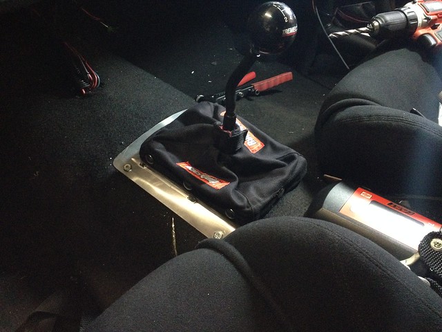

Next up, the Racequip shift boot and custom floor panel (because nothing bolts on, of course). This will get a coat of SEM trim black and some nice button head fasteners down the road, but this will do for now. No more hot air blowing in my face on the road: success.

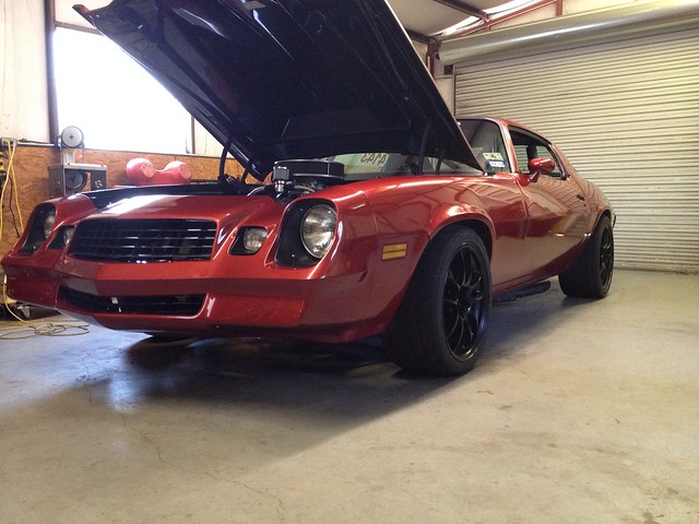

With that out of the way, it was on to the fun part - finally dialing some camber into those fancy control arms we installed way back when. Base setup will be -3 deg camber, just under 4 deg caster, and a 1/16th toe in. Adjustments at the track this time around will be limited to shock adjustments on the single adjustable QA1s and brake bias changes using the newly installed Wilwood magic knob.
And, finally, how she sits (well, this was before the alignment, but you get the gist). The Enkei 18x9.5/10.5 wheels, admittedly, look much more at home on my 350Z, but I can get used to the look if they'll stick and go.

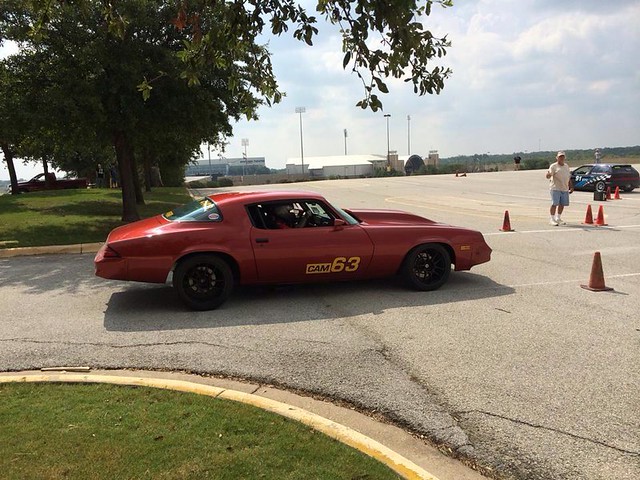

Thanks! I gave it hell, and didn't break anything, so we'll call this trip a success.
All in all, for the first runs this day couldn't have gone any better. Eased through the first run - well, first half of the first run, and picked up from there (see the video below for how quickly things escalated). The car feels great overall. Pretty docile, really, compared to what I was expecting, both in terms of handling and getting the power down.
We had a great turnout of old iron at this event, with 6 entries in the CAM class. It was cool to have several reference points, and we ended up 4th in class. Not bad for a starting point, but there's loads of room for improvement in both the car and my comfort level with it.
Overall, I'm pretty happy with the feel. Naturally, though, there's already a list of changes to be made. Here's a rundown of the issues to be rectified -
- the rear brakes just flat aren't biting. Not sure if it's master cylinder sizing, bias bar adjustment, or other issue, but it's contributing to a ton of front dive and subsequent bottom out under braking, leading us to -
- front spring rate. Specifically, lack thereof right now. We went with 450# springs on the QA1 drop-in coilovers originally, and I pretty much knew they weren't going to be enough. 650s (the highest they have in this configuration) are on the way as of today, with eyes toward replacing them with outboard mounted units tied to the cage downbars this winter
- the rear end is quite skittish. It's controllable, and fairly predictable, but there's just not much grip. The rear sway bar will be disconnected for the next event as a starting point for correcting this
- the 4.86 gears might be a bit too tall, as this course probably could have used a shift to 3rd in a couple of spots. This was a big course, but was pretty standard for the clubs we run with
- stock 9" axle bearings don't like autocross - Strange o-ringed replacements are on the way to correct a bit of leakage on both sides
- oil cooler was already on the list, and proved to be needed. Temps were in the high 240s by the last runs
- MEAT - we'll be investigating how much rubber we can squeeze under the front in the next few weeks (rear is wide open inside and out). The plan right now is for Forgestar F14s, most likely in 10 and 12 inch widths.
The day was pretty much like operating an amusement park ride, with different passengers hopping in for 4 of the 6 runs - all leaving with a big silly grin on their face. By the end we were getting better at explaining the 5-points to the uninitiated.
It might not be the quickest (my Z would have pretty easily been 3+ seconds quicker), but touching 7500 rpm multiple times, and constant wiggle through all the corners makes for a hell of an exciting ride.
Here's video of the second and last runs of the day - turn up the speakers for full effect.
And finally, a quick shot of my (thankfully) helmeted mug on the way to the line. The grin may be covered, but I assure you it's ear to ear
