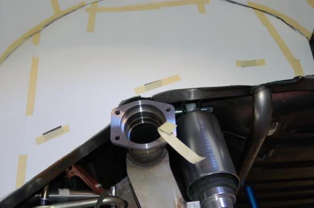

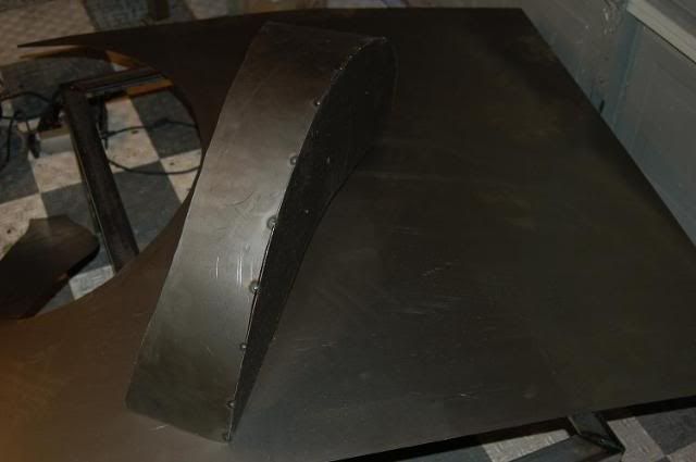

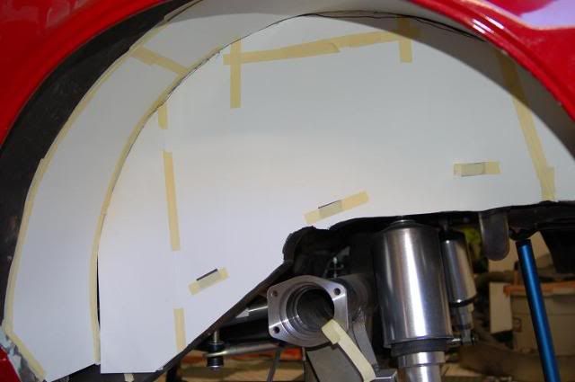

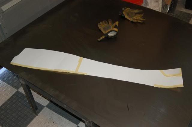

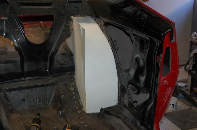

After getting the rear clip tacked in I put the DSE tubs in there locations. I didnt care for the way they hide the Morrison frame rail. I want them to butt up to the rail and not overlap it. Im also running 345mm rear tires. I need all the room I can get. So I pulled out the poster board and started cutting it up. Heres what I came out with. This part has been fun for me because Ive never done fab work like this. Its givin me some time behind the welder. Its not welded in yet, I wanted some feedback first. Thoughts??

I think it looks good. How much do you have to narrow your back seats ?

Nice work man.
