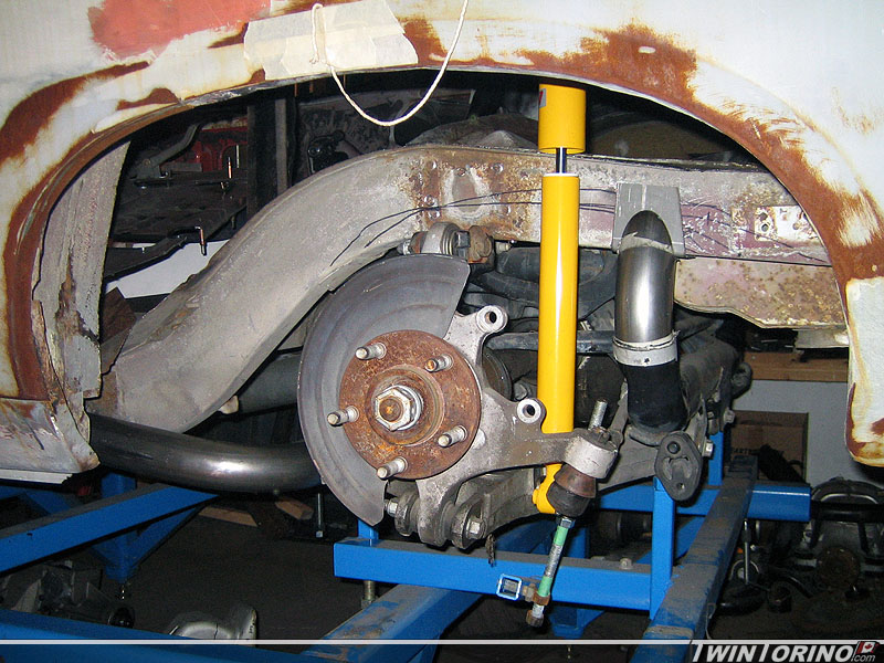

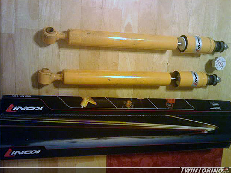

Found a set of nearly new rear adjustable Konis specifically made for the IRS suspension. Just need to make some custom upper mounts.

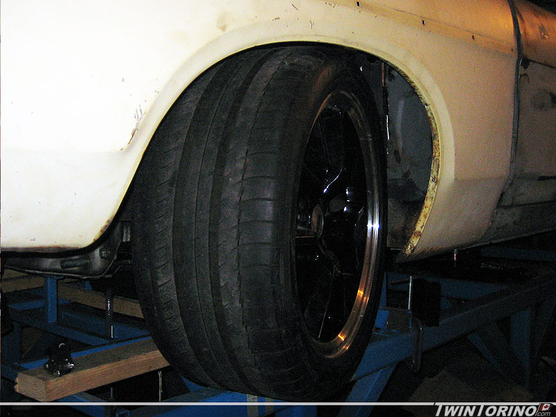

Also managed to find a barely used pair of 275/35R18 Michelin Pilot PS2 tires to try out on the car (same size/model as a newer Viper so they are not that hard to find). They were mounted up on the car and we ran through a clearance check and they fit perfectly. The hardest part about getting a tire to fit is while turning the tire when the front suspension is compressed, and they also need to clear the coil-over suspension.

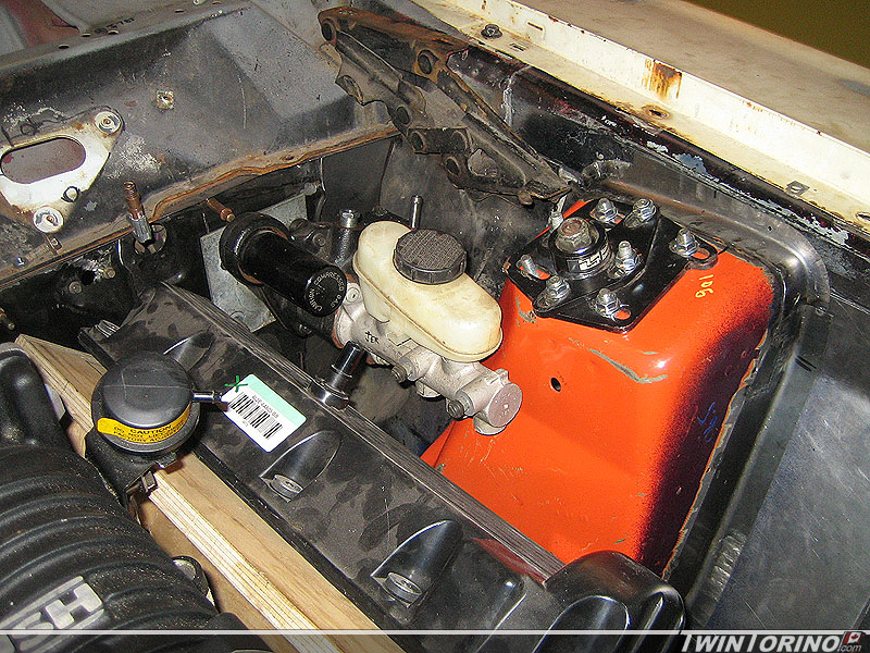

Also moving right along on the front strut towers. Have all of the pieces tacked together on the driver's side and everything fits great. Should be able to weld these in soon. Just need to add a piece in the top corners and they should look factory stamped.

Decided to put everything together once again and check all the clearances one more time before we start welding parts to the car. The hydoboost unit and the hood hinges clear the new strut towers, so we can now proceed with them as in that location.

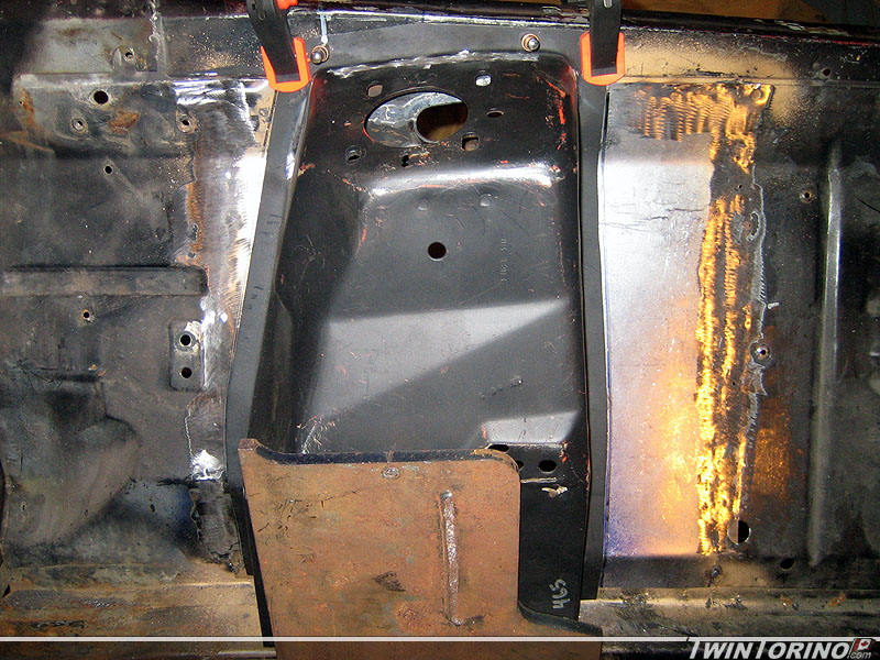

Finally have the drivers side tower completely welded and finished up and ready to tack in.. it's about time! Pass side is welded and should be finished up tomorrow night. Just need to blast everything and paint it to get rid of all the contrasting colors. I quickly splashed some black primer on one of them to keep me insired . Also have all of the close-outs done and ready to weld in too. Just need to make a jig to be able to plasma cut a k-member to fit and make it very easy to do more than one. Can't wait to actually get a real motor in there.

Moving right along on the front suspension. Pass side strut tower is done and ready to tack in. Next step was to make a perfectly centered and tight fitting k-member. The one we have been using to date is hacked up and really only for setting things up. Time to make another jig for this. As you can see, nothing too elaborate, but it serves it's purpose. We used reference holes on the part used at the assembly plant to locate the jig. Then we made up 2x4's that are the exact width between the frame rails. Finally two pieces of plywood are used to conform to the curves of the part. To use, the jig is placed on a Mustang K-member, sockets are placed in the 4 holes to located jig and then a utility knife blade is used to scribe lines on the parts. After that, we break out the plasma cutter and trim/grind to suit. Works like a charm! Making one for car #2 is now a breeze.
We used it to cut the k-member shown and it fits perfectly. That will make it very easy to weld in. Started on making up pieces to run under the frame rails to clean up the package and add a bit more stiffness. Kinda looks like the k-member was meant to be in there. Just need to make up the rear ones and the k-member will be ready to go in. Only thing left now is to weld in the filler panels and modify the motor mounts. After that, the front suspension is done!!

Since the front suspension is finishing up, time to move back to the rear once again. Had a lot of time to think about this one now, so time to put it in action. Biggest issue with designing anything in the rear is the tire clearance. Fitting the 315's back there requires lots of room. Couple of constraints here - the outer fender lip since the tire will sit within it, the springs and the shocks. We went back and forth on coil over shocks, but in the end they are expensive and take up precious tire clearance. The Koni 3012 dual adjutables we wanted were $500 each alone + springs and they are impossible to find used. As you may have noticed, we likely to track things down at discount prices. They also do not provide the most desirable load path as the shock mounting holes are outboard of the frame rail. Many of the aftermarket kits out there use single shear mounts on the outside of the frame rail which we are not big fans of. The shocks even without the coil-overs will require notching the frame, although very minimally. The result here.. the springs and shocks will mount in separate locations like the stock Mustang.
In the end, this is how we decided to mount the spring. We are using the stock spring pocket on the lower control arm, but using a much smaller spring. We started with 2 u-bends as you can see, and turned them into a doughnut. This way we maximize surface area to distribute the load. Just need to add a flat plate in the middle and a small wedge to angle the spring as required. In this configuratins, the springs sit directly under the frame rails. Then we simply add a mount to the frame rail. Notice we are also adding an adjustable sleeve for fine tuning the ride height. Since we are running fairly stiff springs all around, we will be using helper springs (very low stiffness) to keep the springs in place when the suspension goes into full rebound.

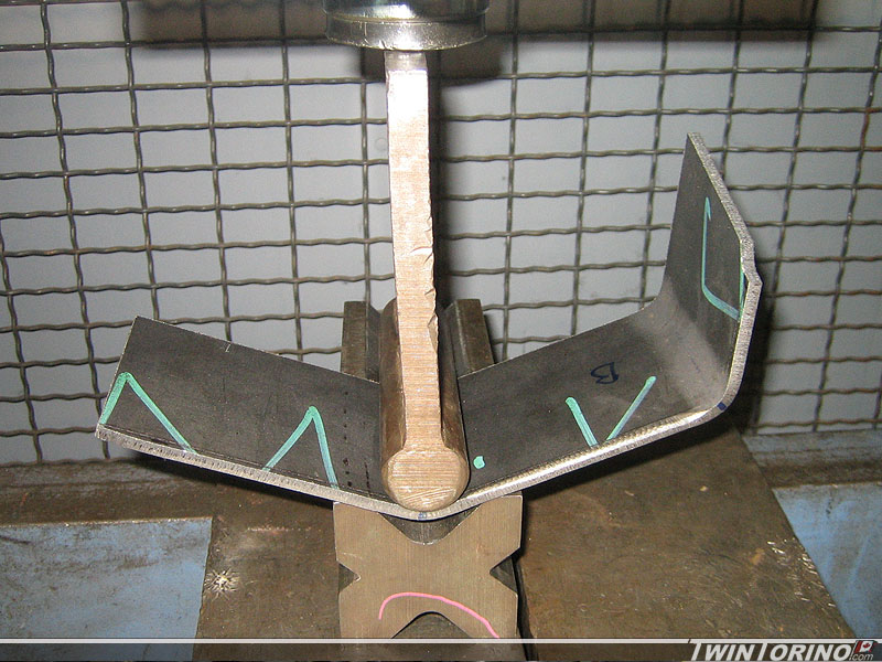

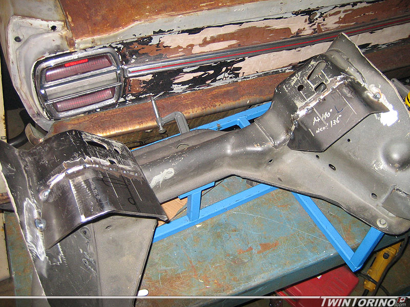

Moving right along - have the Mustang K-member mounting tabs completed. Only thing left to do it shift the engine mounts back 3" to get the engine as far back as possible. Since the steel on the stock mounts is 3/16" thick, this means the std brake won't cut it. Have to move the the hydraulic press for these bends. Got them ready to weld in over the weekend. Will get them welded in this week and then it is finally time to weld the front suspension permanently into the car.
Also found a complete vehicle wiring harness set from a Mustang GT and heater box / ducting parts.
You never know what you will find on Craiglist.. that is for sure. Responded to an ad for a Mustang rear suspension and a couple of hours later.. ended up with another Cobra IRS in the driveway. This one is out of a '99 Cobra (28 spline inner/outer axles). Could not pass up the deal at $175. Not sure where it will go or what to do with it.. but it will find it's way into another project - no worries there.
Got the motor mount extensions tacked in and ready to go. Likely won't go much further with these or drill motor mount holes until the actual engine goes in and we can check clearances. That way it can go back as far as possible. To do that we will just cut the studs off an old set of motor mounts which will allow the motor to easily slide back. K member is now ready to weld in. Just need to finish up the strut towers are front suspension will be almost done.. finally!
Started working on the strut tower stiffening braces. These will directly tie the strut towers to the upper "shotgun" pieces on the body. These tie into the reinforcements plates on the Mustang strut towers.
