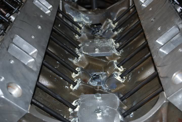

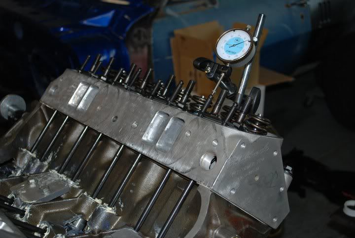

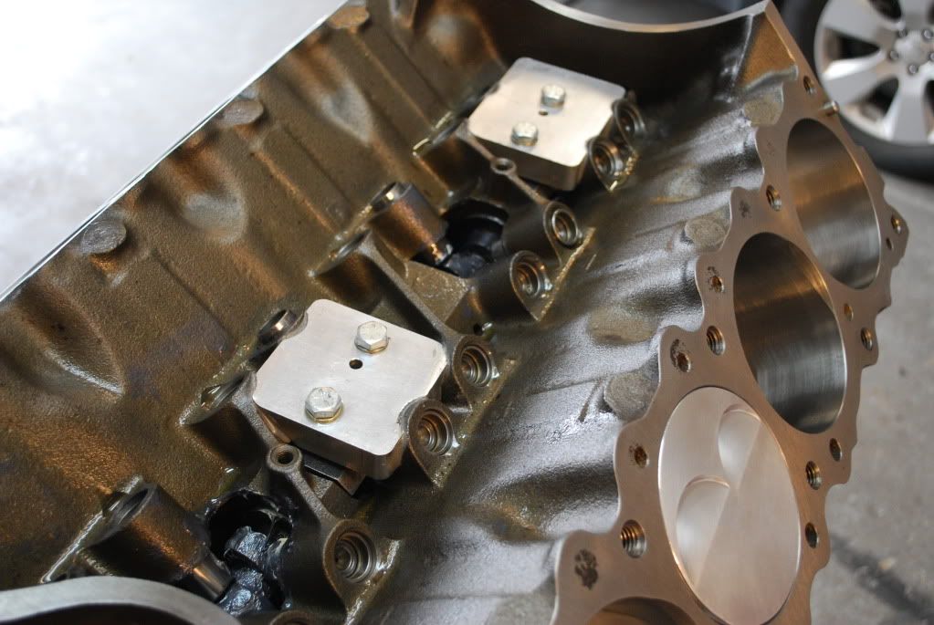

Few more pics of the block at the machine shop, should have it back real soon

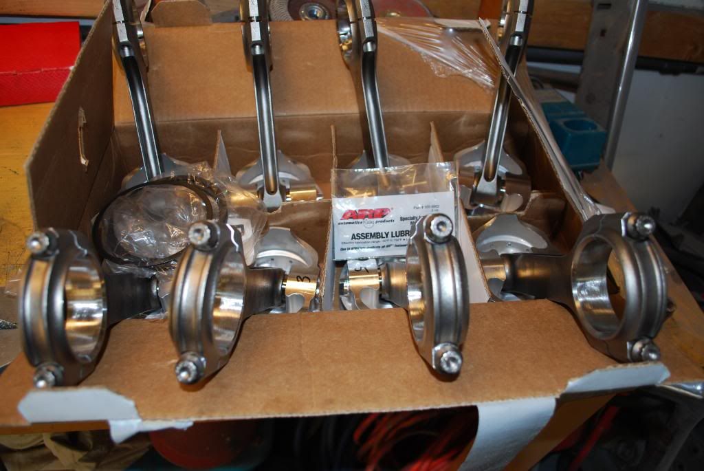

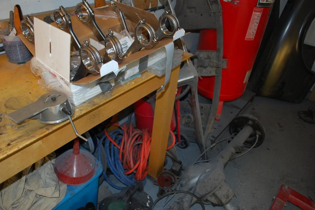

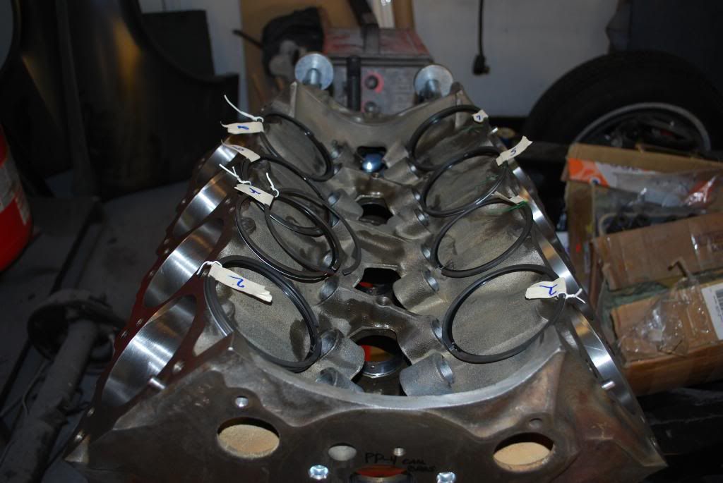

I picked up my parts this past Friday; now the fun begins. I filed the rings to fit and should hopefully get the shortblock assembled this week. Here are the pics:

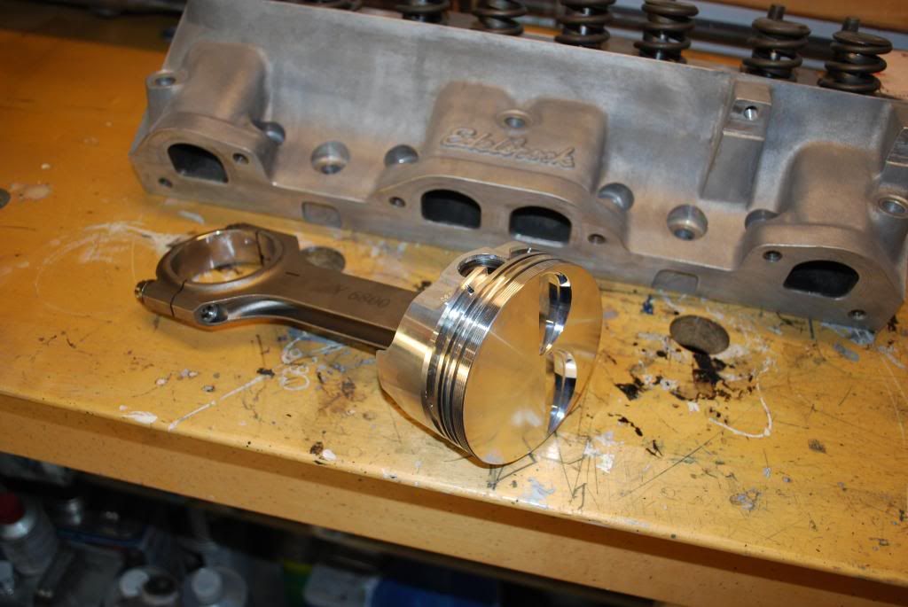

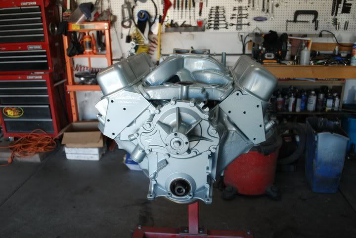

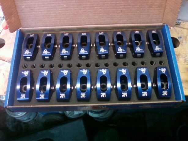

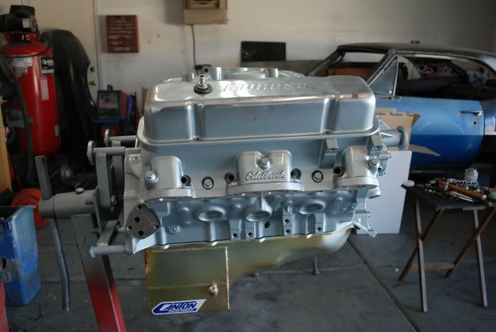

I guess I'm long over due for an update. Progress has been slow, I sort of got sidetracked on another deal. The block is mostly together and painted. I'm just waiting on the manifold, it's at the machine shop. It needs some material removed to fit due to the block decking and head resurfacing. The heads got a little more work than I originally intended. In addition to resurfacing, the ports and chambers were cleaned up, new springs installed, and the vlave job was touched up.
Here are some pics:

A few more:
