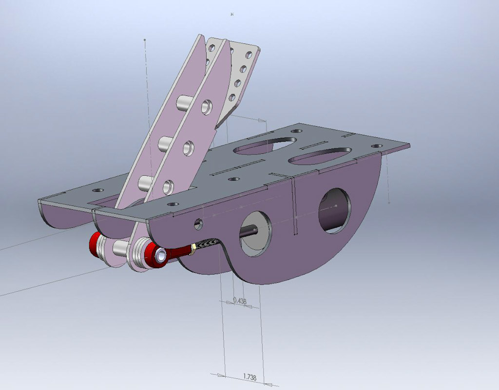

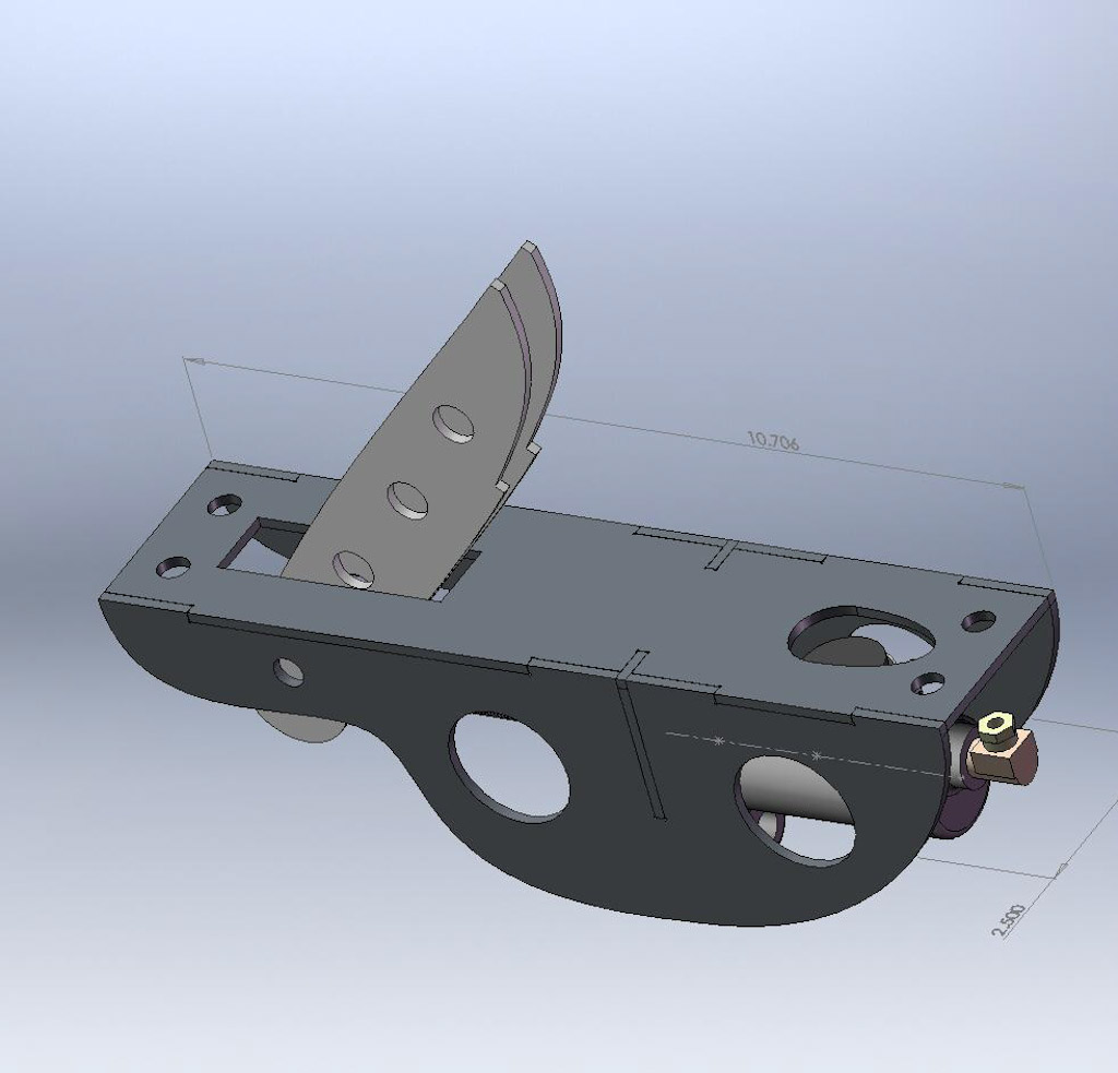

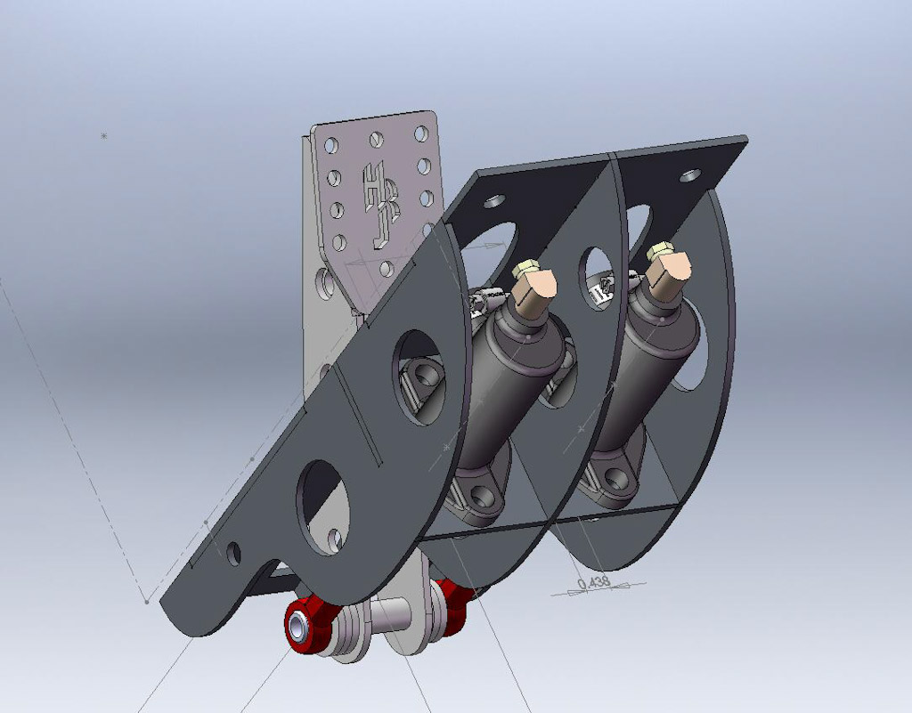

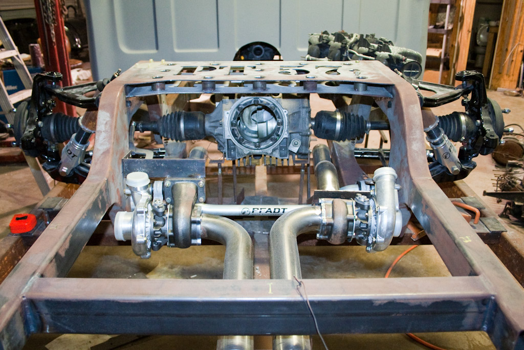

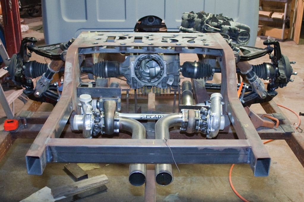

People with big feet - (Darren, Brianne, and I, well everyone but Billy really) our feet wouldn't fit with the last pedal system so we rear arranged a few things and moved them under the floor.
Clutch
Brake

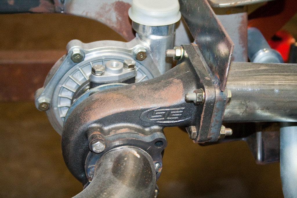

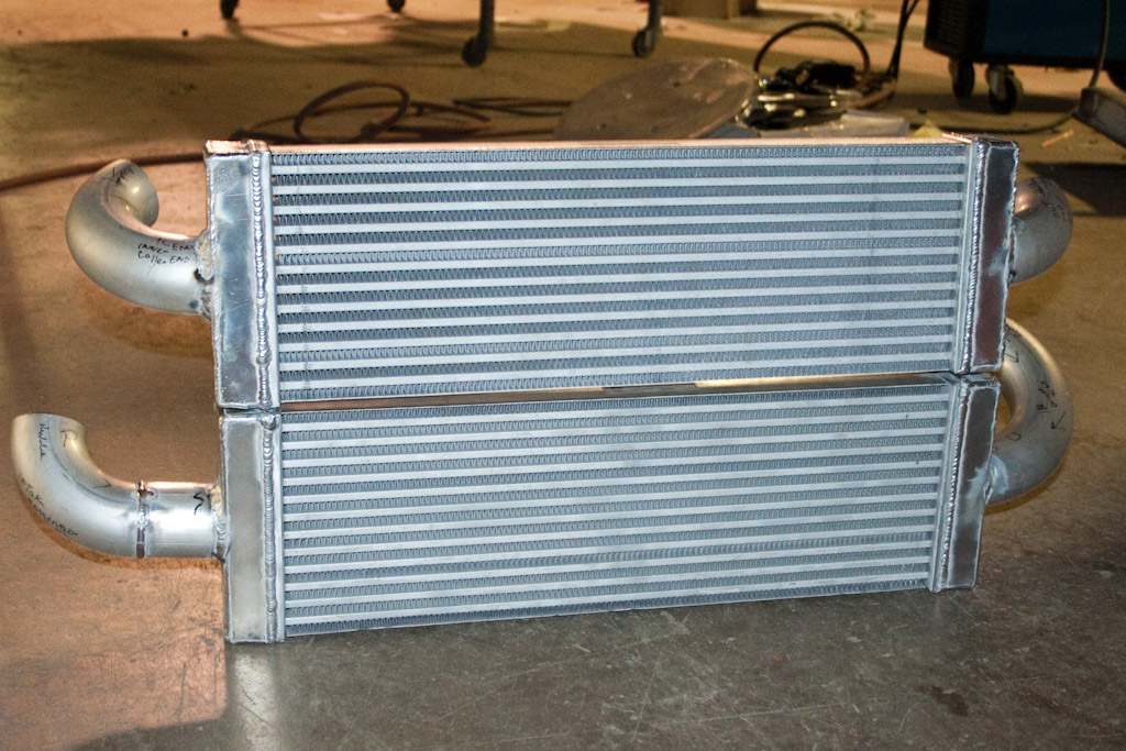

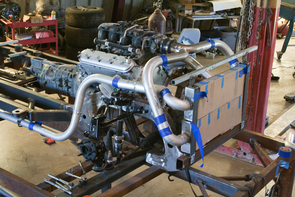

Intercooler caps are done and out to the cutter with the brake parts
TURBOS!!!!
Looking evil. and the tubing for the compressed air is in too. All mandrel bends in aluminum. It'll start 2.00" at the turbo after a few gentle 45 degree turns it goes up to 2.25" up over the front tire turns into 2.5" and then goes into the intercoolers.

I'm not really sure about the remote turbos installation, doesn't it add a lot of lag, and weight of the plumbing? What pressure will the turbos run? It looks really cool and awesome Russell
''Every car has a great quality, is not the hands that build it, is the dedication behind it.''
  #78
Old 10-03-2009, 12:18 AM
rat_rod_russell's Avatar
rat_rod_russell rat_rod_russell is offline
Join Date: Sep 2008
Location: Luling TX @ Nerd Rods
Posts: 365
Thanks: 44
Thanked 18 Times in 9 Posts
Not really since you've also taken almost all the back pressure off the exit side of the exhaust too. The STS cars I've been in exhibit no lag at all. The exhaust is lighter actually since we're not trying to make elaborate headers that flow and twist under the hood and we're not running mufflers. The weight of the mufflers is the same of the turbo, I think the turbo is lighter really. Inter coolers weight 5-8 pounds apace and all the aluminum tubing front to back might weight 15 pounds since its all .065 wall. Waste gates are 2-3 pounds each, blowoff is 4-5 pound, and the oil pump system is 10 pounds total I think.

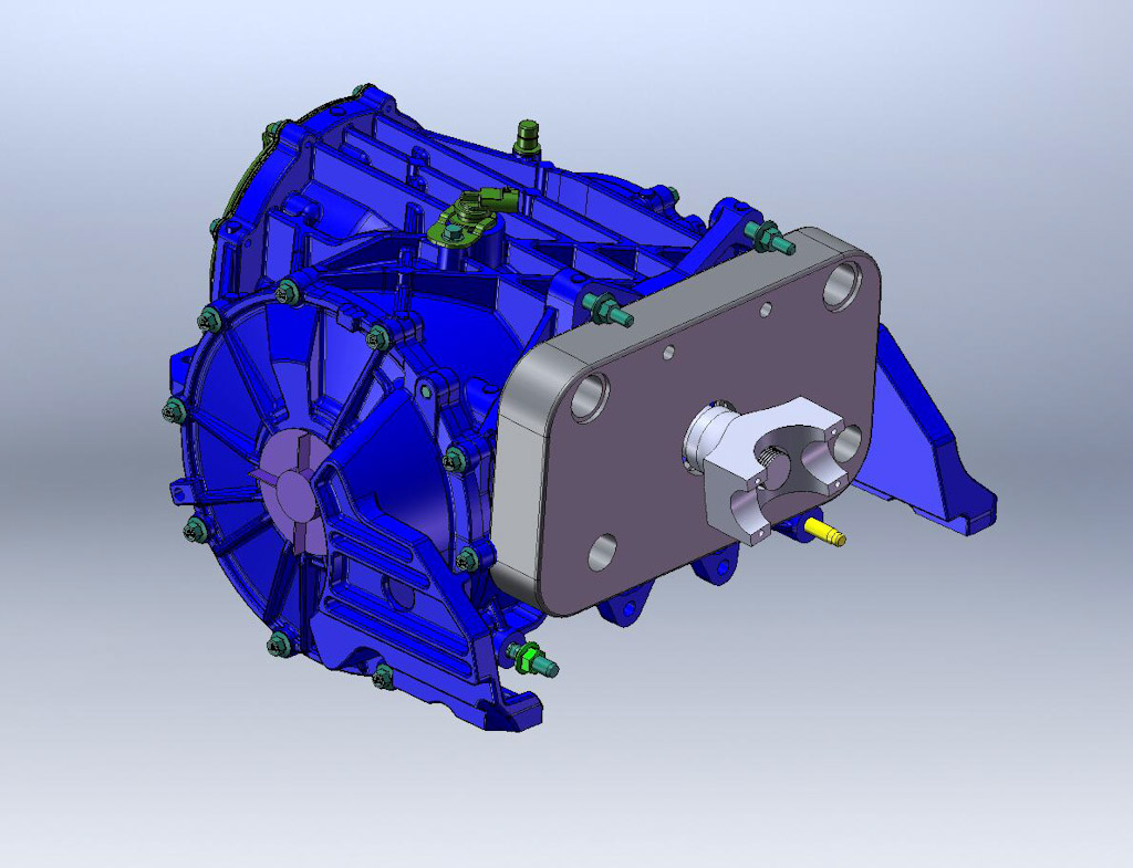

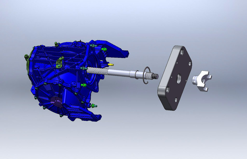

To answer another question, about the rear end. We're developing this adapter to convert the Corvette transalxe into a stand alone diff. I'm showing the C5 adapter on a C6 Rear. I'm running the C5 in the truck but I don't have a C5 model. We'll be offering this shortly after SEMA and we've beaten the crap out of the prototype. It will have several different mounting positions and will take almost all the torque the normally destroys a C5 rear diff into the plate then straight into the frame.

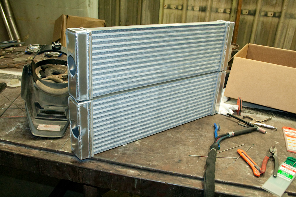

BTW Intercoolers are done

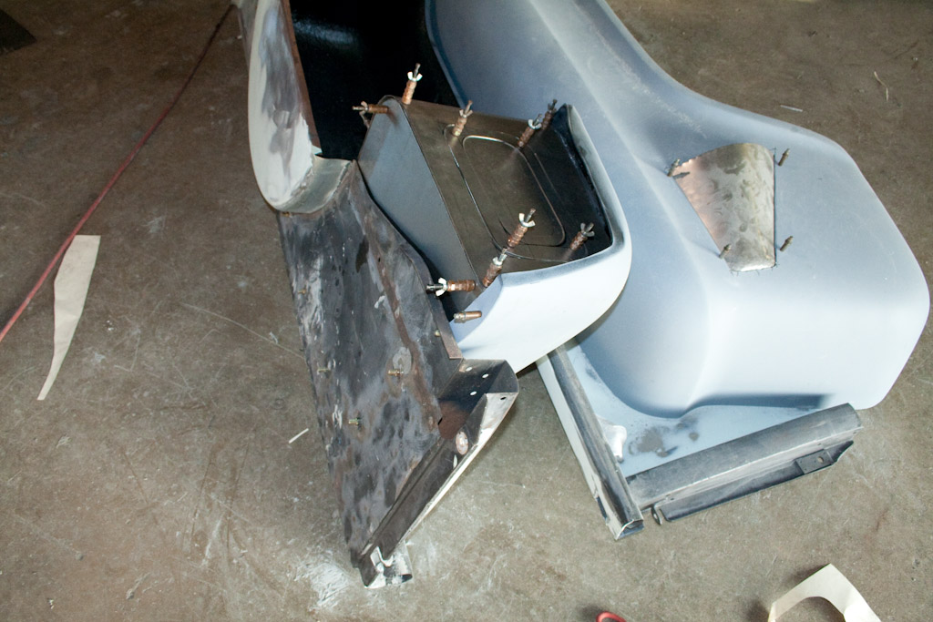

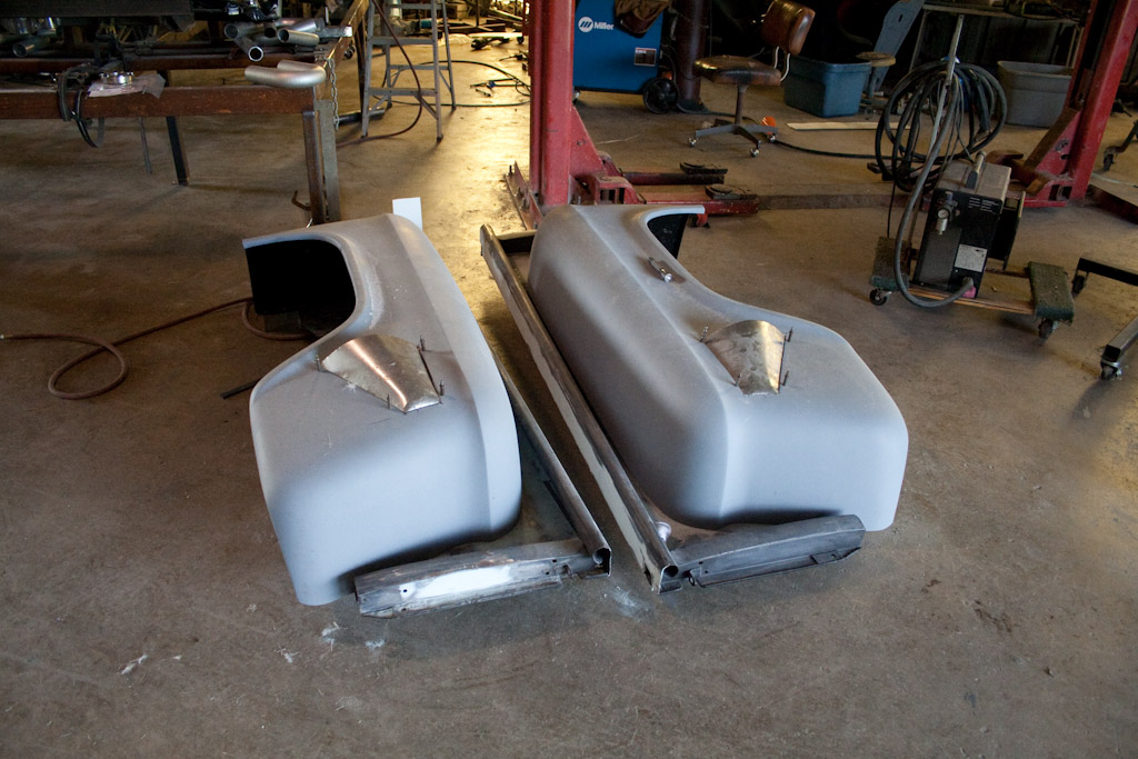

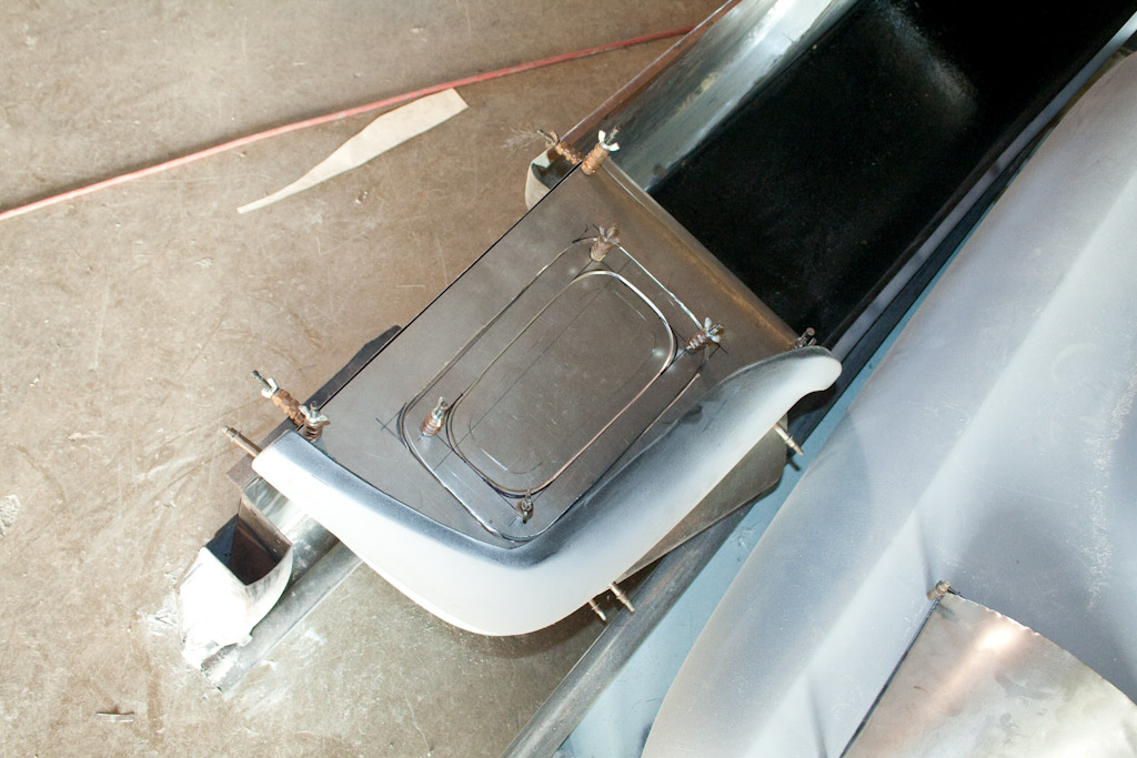

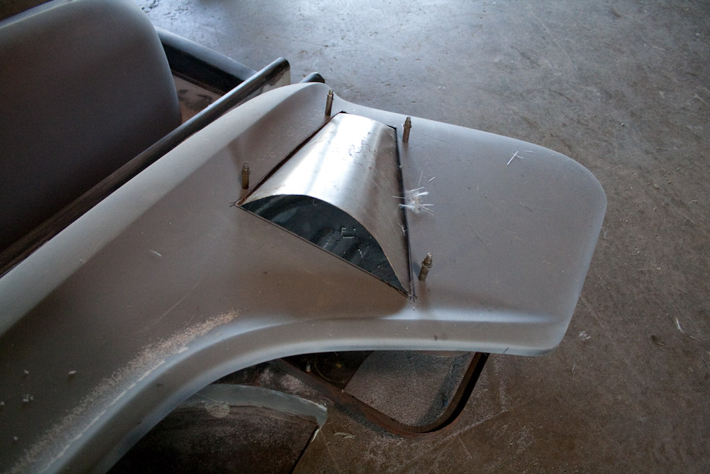

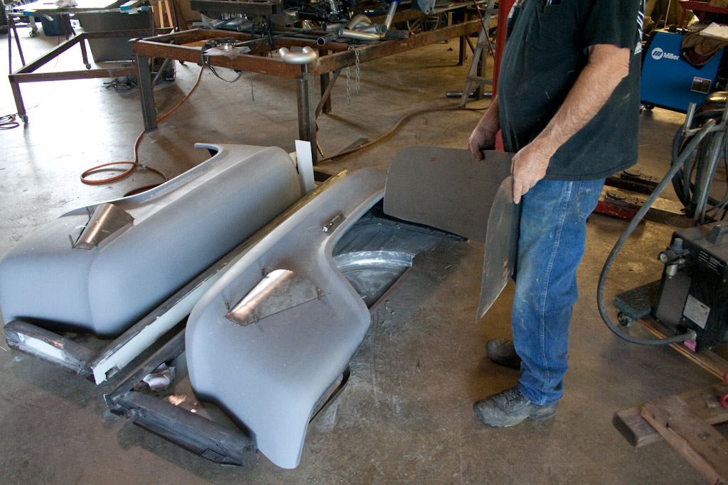

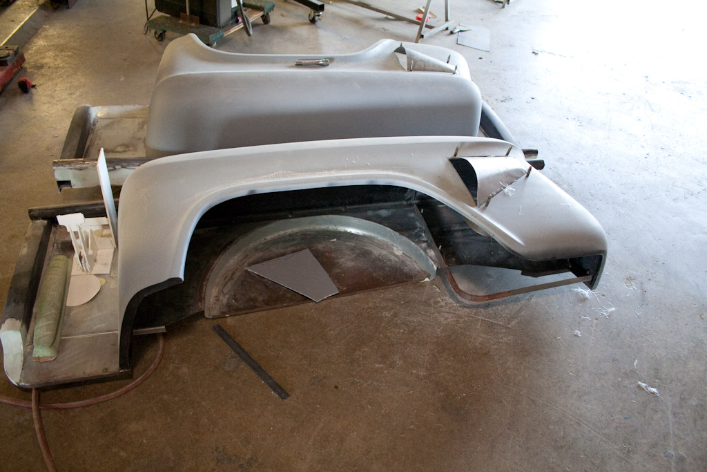

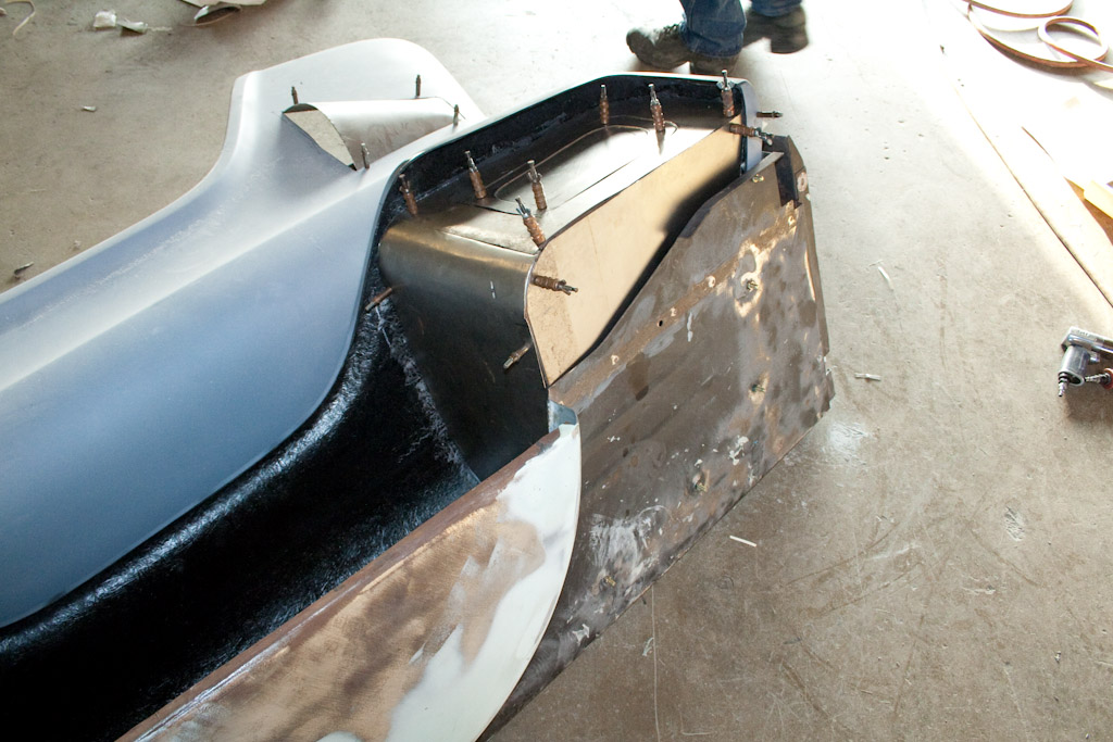

Rear scoops, mud and water gard for the intake and access pannel for the rear fenders are going together nicely. We'll also be installing one of the power cells for the ISIS wiring system in here too.

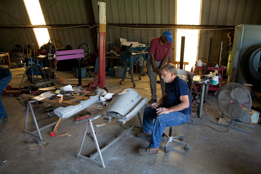

Also I need to point out two of the biggest helps we've had here at the shop. Terry the old guy upfront is a retired body guy. That means he hammers out dented metal and repairs it, not just makes you replace everything with new metal then bondos over everything. His skills have been in valuable here and we all take a lesson when he starts to talk, most of the time.
Kendall Burleson is in the background working on a brace for the inside of the cab. Kendall is the owner of Adrenaline Rides Garage in San Antonio and has been in the Automotive and Air Plane fabrication industries for over 30 years and brings his considerable sheetmetal, TIG and custom interior skills to our shop when he's not racking on his several projects. They convert J bodies (Cobalts and the like) into RWD Drag cars. We're in the processes of designing their first Pro-Touring style conversion with C6 Corvette suspension. With out tight time table Kendall has volunteered some of his time doing what he dose best, everything, lol.

Hey Russell, You might check and see if someone has the C5/6 trans adapter already. I saw the unit in Good Guys Columbus 2 years in a row on a purple chassis of a vendor using the chassis to demo an exhaust cutout/bypass product. (maybe another member here remembers that product and/or vendor) They took a transmission tail shaft - reversed it and used it on the input of the Diff like you're showing in the solid works diagram above. It bolted right up with no cutting or mods. I have pics of it at home - but I'm in Miami this week.

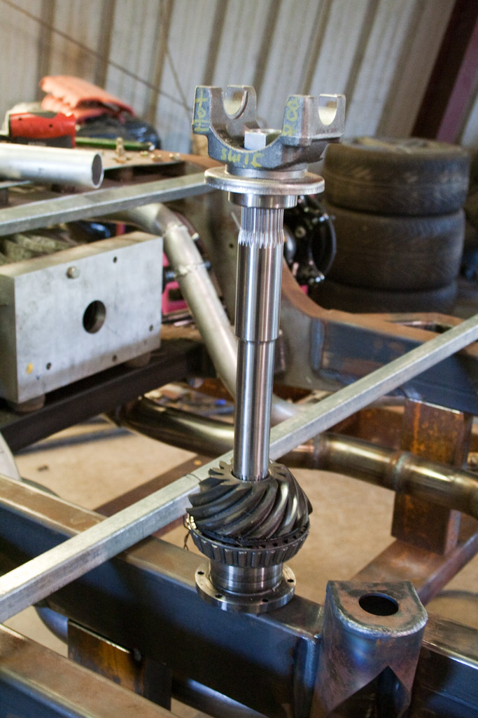

I've been watching your Porsche build since your 4th or 5th post. I have a 69 911 I'm going to do if I don't sell it before SEMA. I haven't seen but one other adapter for the C5 differential and they wouldn't sell it. Plus I'm almost done.
I just got the input shaft in now to make the press on sleeve for the clip ring and bearing face and we're done.
