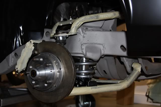

Got some time Sunday to plug away a little more at it. Managed to get the Speedtech arms, Qa1 coilover conversion and Wilwood brakes mocked up. Went fairly smooth as you'd expect.
Really impressed with the quality of the Speedtech arms and specifically the powder coat. Very nice pieces. Embarrassed to say how long I've had those without taking them out of the packaging . I apologize that you can't appreciate the coating due to the masking job I put on them to protect them during this phase . I've been known to drop things here and there.
I'm not thrilled with the brakes but I've had these on the shelf so they'll have to do for a while. These are probably border line for any serious street duty.
The lower arms were a little bit of a challenge to get worked into place. I was prepared with the 1/2" X 4.5" all-thread and a couple nuts and washers though from having seen that mentioned on the forum. Works like a champ to spread the mounting locations on the subframe enough to work the arms in.

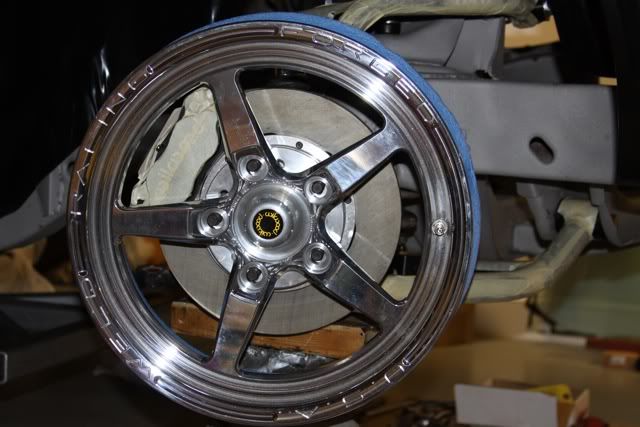

Had these on the shelf too from previous build plan. Awesome wheels for the strip and don't weigh anything. Couldn't help but throw them on for a pic .

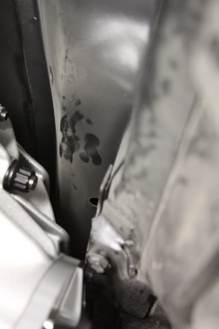

Sorry for the crappy pictures. I need another lens. Little tough under the car, on my back, with limited light and a 28-135mm lens . I need one of those fancy lifts .
Here is a shot of the fill tube on the Fab-9 hitting the crossmember. It is just hitting at full compression but enough that it must be addressed. Probably end up bending another crossmember that goes up a little closer to the floor or change the route it takes. I spoke to Chassisworks about it and they are aware of it but it seems to only be an issue with Fab-9 setups.
Notice the non-existent exhaust clearance. Might have to talk to the guys down the street at Goolsby Customs about raising the trunk floor or something .

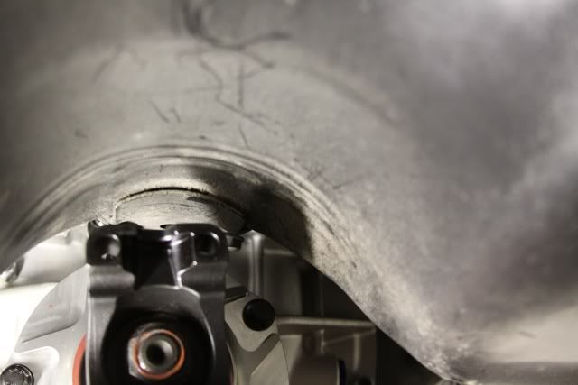

Here are some pics showing clearance in some other areas at full compression.
There is over 1" of clearance at the frame rail.
This picture is a little misleading but there is a little less than 1" of clearance at the tunnel where the pinion is. The G-Link is basically allowing as much of a drop as possible really unless you want to mod the tunnel.
Here is a shot showing the clearance between the gear case and the body/floor structure above it. When I put in a little pinion angle and I remove the old pinion snubber mount there'll be enough clearance. However, again, IMHO this is as low as you could go without committing to modifying more sheetmetal for clearance. At least with a 9" setup like this. I suppose this case is a little beefier so maybe that is taking up a lot of the space.
