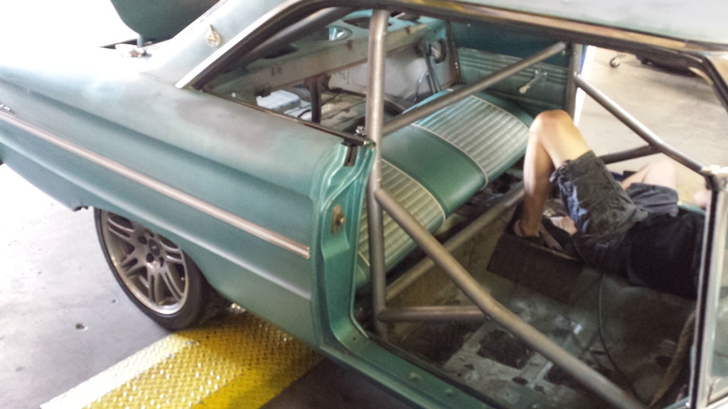

Hey Rusto, bringing my thread back from the dead. It looks like the Sears Point event is the same weekend as Goodguys so I will have to miss it.
The new suspension design is almost ready for the first couple of prototypes and the falcon is at Maier's shop right now getting a cage (or whatever you want to call a 4 point bar with door bars.)
I plan to drive up to the USCA event at PIR this August.
  #77

This should stiffen up the chassis quite a bit and allow me to mount some harnesses for track days.

Comig along very nice.I like it.

Oddly (or not), we'll have very similar roll bar structures (mine's nearing three years old or so now). The front four points (main hoop + door bars) land on 2x3 outriggers (sfcs to rockers), and the rear down bars land on the shock crossmember. Had I realized the flex that leaf springs create in the rear, I would have landed the rear down bars far further back (I haven't the will for pictures here, but there's an anonymous blog out there)...
