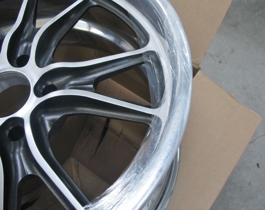

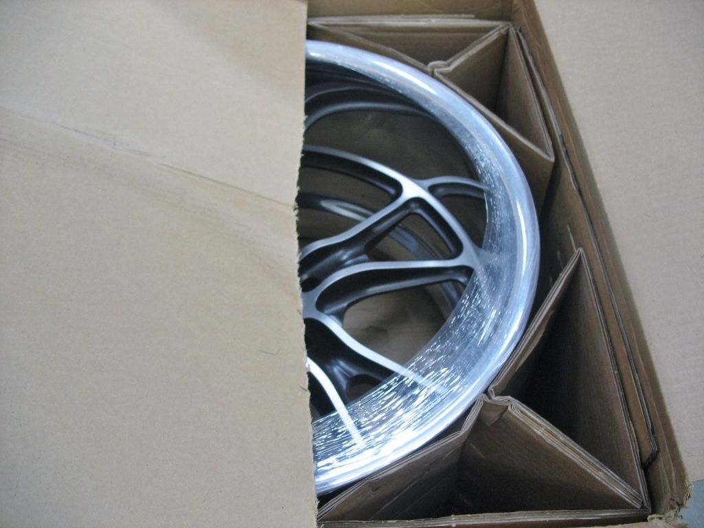

Entry level Wilwood Dynapro brakes, car will have 18 x 12s in the rear and some killer rubber.
