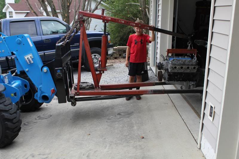

Well, like I said, I got the engine at least set in the frame. Had a rather unique tool that I used, as the frame was set a little closer to the door than I had planned.
Anyway, I had rented this for another project here at the house, and thought I would seize this time to use it.
So this is the outcome of the event. Rather painless in setting it in. As you can see it is jut resting on the pan and the trans has the mount in. I am playing with the idea of using Camaro mounts so you can see them next to the stock Chevelle towers. I will need to see what I can do on this. I think engine setback is good, let me know if I am wrong here guys. Let me know if there are any other pic that are needed to make that decision.

Heep, that is a rather unique tool. LOL!! If you set the engine back, are you gonna redo the firewall to accomodate the engine? Also, why won't you just get some LS adapter plates?

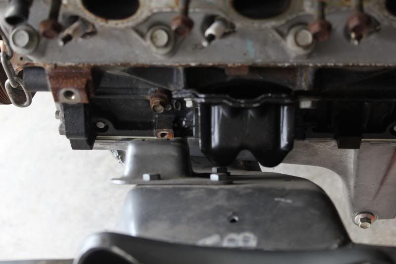

Alright guys, I need some advice. I have purchased the GM conversion pan from a member here and got the engine set in. Right now, I have a 3.7 degree angle front to rear on the engine so it will clear the steering linkages. Now, I'm also more forward of where I would like to place the engine as it is about three inches from the firewall. The one thing holding me back right now is the trans mount. I will need to see what I can do to make it move farther back.
I'm ok with using the normal Ls swap mounts or fabricating whatever I ned to make it work with the camaro mounts.
So what is the optimal angle for the engine to set in? Would I be better off to purchase the Mast pan to make sure everything clears properly? Do I need to set the engine back further than the three inches to the firewall?

I'd purchase the Mast pan. I have one and it's a nice piece. Costly, but nice.

Ok heepster, mine is about 1/2" off the firewall. I made my own mounts, and my own tranny crossmember.

Everything clears great. My vacuum hose for the brake booster just touches the firewall. I'm not so sure if I'm gonna keep it or not, as I might go manual brakes.

Here's a pic of the steering box clearance. I basically set mine back as far as possible during mockup. Of course I had my headers installed, and I put the steering box on, to make sure all my stuff was covered. Having your oil pan on will be mandatory to ensure your golden on fitment. I'm using the Holley pan. It's about 1/4" off the top of the crossmember, and I also have a ton of clearance on the sump of the pan to the crossmember. I researched this a lot. Some people reported that they had to raise the engine, in order to get tie rod to pan clearance. My engine is as low in the car, and as far back in the car as possible with a stock firewall, and I have no problems anywhere.

Scott, thanks for the update on this. I just posted in your thread. I was just looking at your mounts, and was thinking of doing something similar. I created the normal mounting plates today and bolted them on. Trying to decide what to do here. I really hate to spend more money on another pan.
I am going to have to come up with a modification to the trans crossmember to get the engine moved back as far as yours. This should not be an issue, as I will just have something lasered out to weld together. I am running the HPI Customs frame kit, and I think it is designed for autos.

I was looking at your build thread and saw that you had the stock frame stands bolted on backwards, then I realized you were making your own mounts. While having your engine that far back has it's advantages, you will run into problems if you ever want to remove the transmission without removing the engine. The engine needs to tilt down quite a ways to remove a trans, and with the head being only 1/2" away from the firewall, there won't be any room for the engine to tilt down in the rear.
