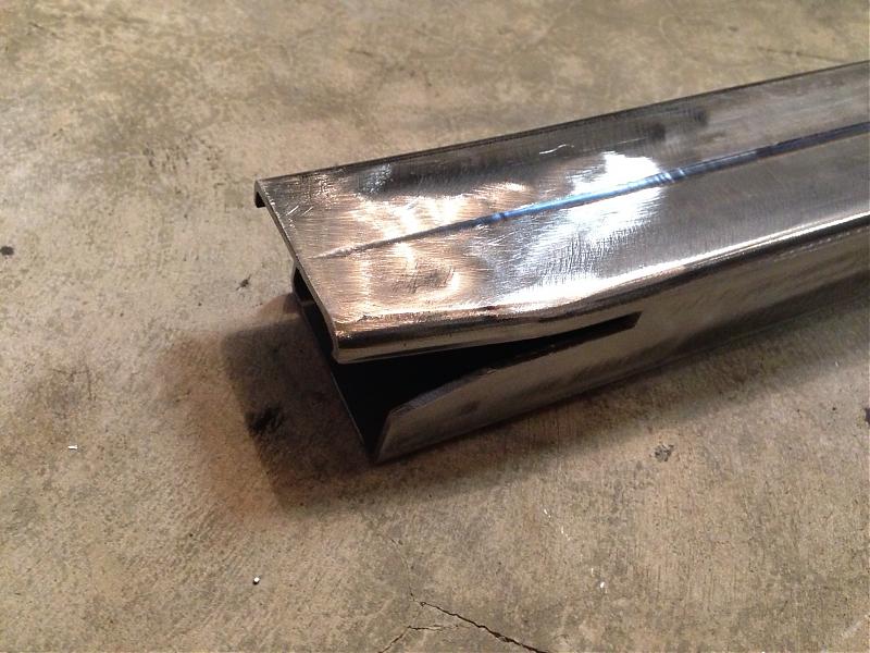

I had to cut a pie out of the subframe connector, taper it down to the size of the frame rail and weld it back up. At 5 1/4" away from inside flat of the rocker it hit the drivers side torque box and wouldn't go all the way back.

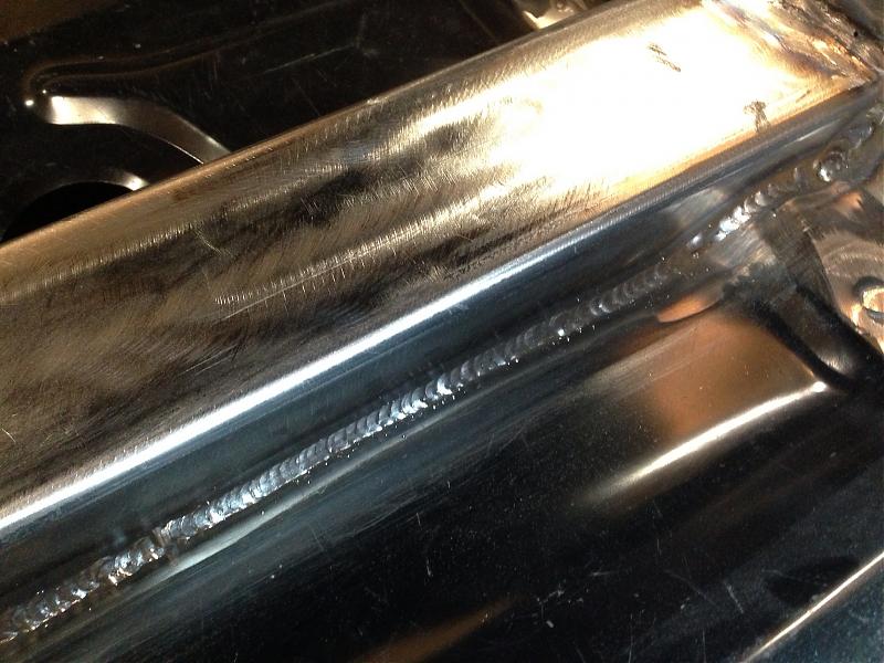

After tapering the end it fit right in place. Got it all welded up and ready for epoxy.

Nice welds on the frame connectors

It looks great ,nice welds!!
