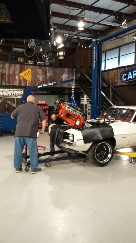

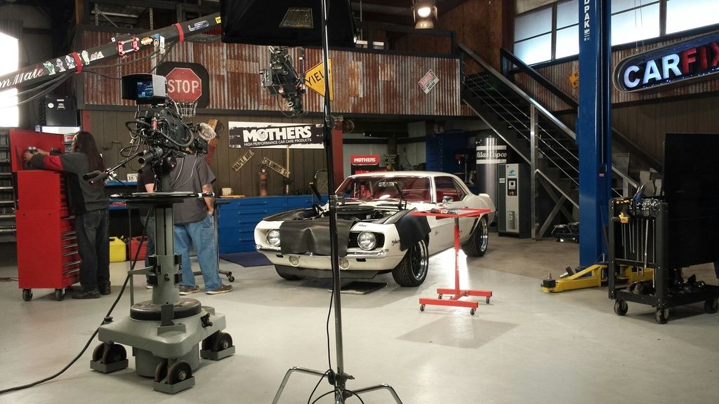

Hey guys, the show has been televised a few times now. Here are some pics from the production. What a great experience all the way around!
