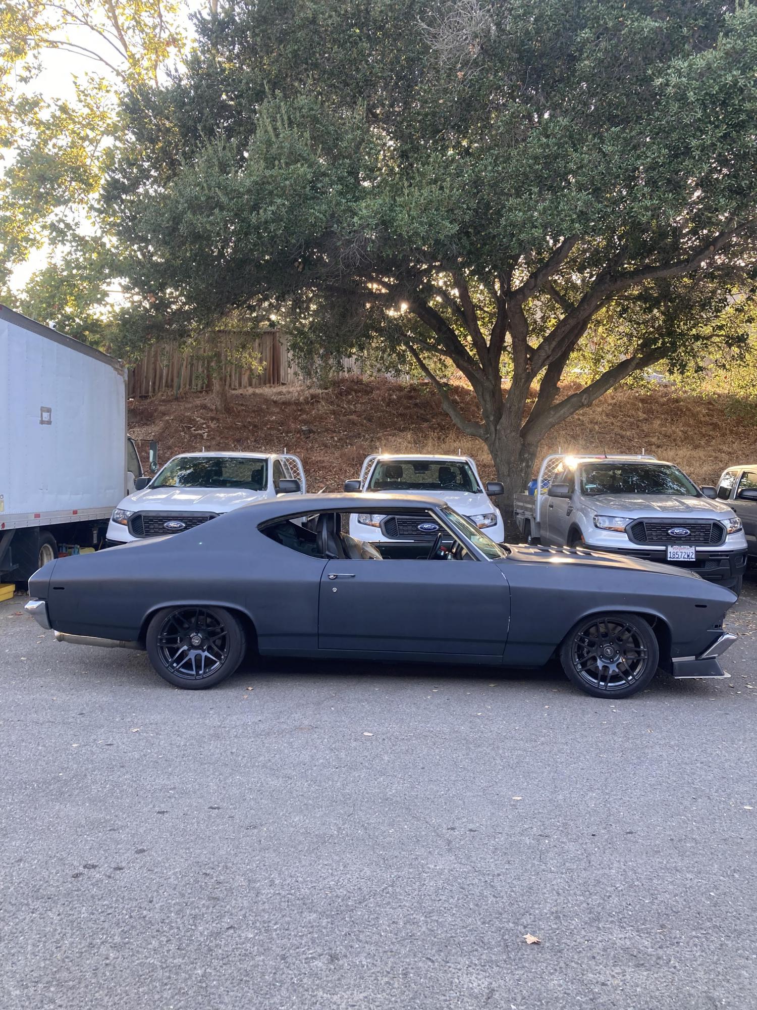

side shot! Pretty good stance... been driving it around and shockingly hasn't scraped on anything yet. Haven't gone over a speed bump yet....

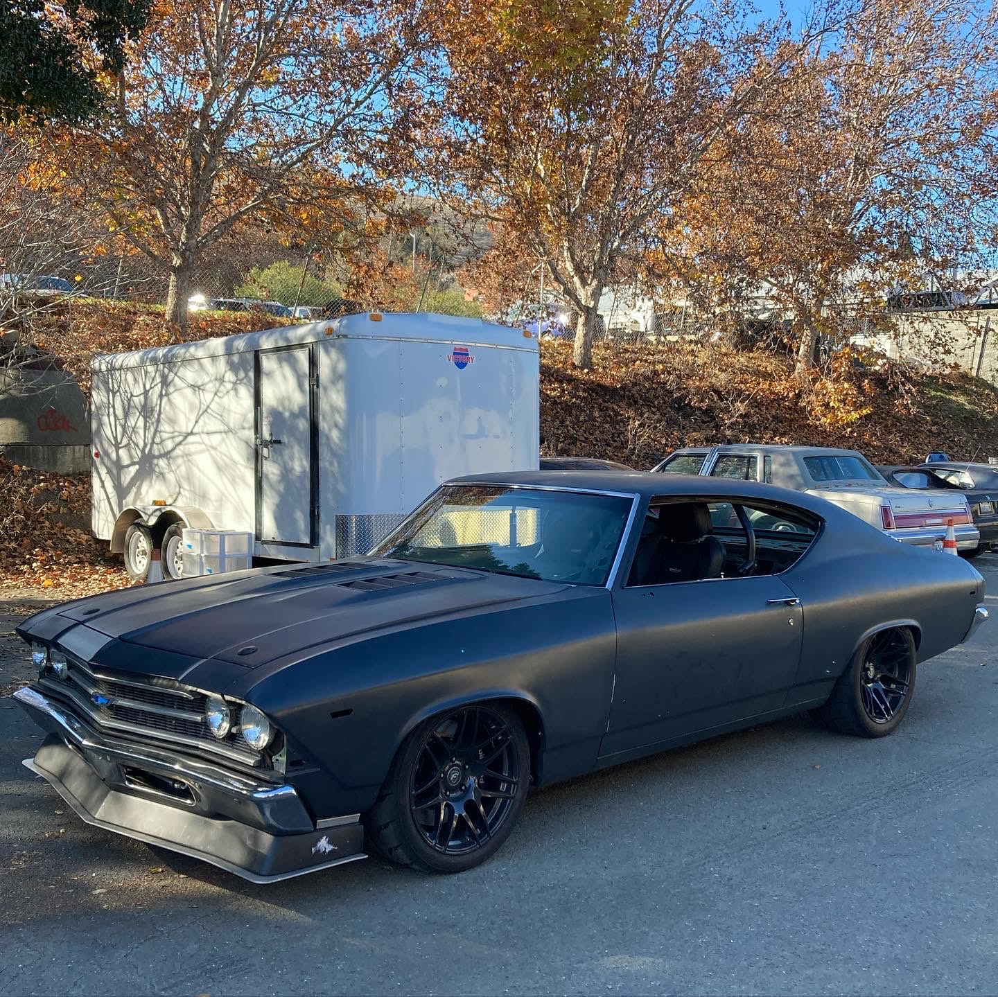

Dropped it off at Hill's Rod & Custom in Pleasant Hill, CA for some safety stuff/checks, ride height/corner weight/alignment and some rubbing issues to resolve hopefully all related and easy to solve.
Curt Hill races and builds all kinds of cars including his green K5 Blazer that he dropped on top of a C5 Corvette chassis running a 468ci LS engine. He did a ton of work on my buddy Dustin Reed's C10 (gray) with a 416 (I helped build the motor and sold him a T56 Magnum). http://digitaleditiononline.com/publ...articleBrowser
2 weeks ago it was in the high 80's and I was out on my waverunner. This week it has been in mid 30's in the am and low 60's during the day. Fall has arrived in Northern California. Getting some much needed rain also as we have been in drought for waaaaay to many years and lakes are at an all time low level. Can't wait to drive this car... it will be on wastegate spring for the first thousand miles until I break in the clutch/T56 Magnum and work out any other bugs with the car. Thus far the pedal pressure is light and the 11lb aluminum flywheel drives GREAT from McLeod.

Had to fix some rubbing issues.... transmission tunnel cut out from behind the transmission (dshaft contact), rear tires luckily just needed thinner spacers, added a shim on both sides of the front sway bar as it was rubbing on the frame bolts to space out the arms on the splined ends of the bar. Added some Crow Racing seat belts.. still more sorting but it drives nicely now without metal on metal contact. Was able to lower the rear a bit as a result of the new tunnel. The 4" driveshaft wasn't helping with clearance either.
Intercooler water pump is on an MSD solid state relay triggered by the Holley Dominator EFI need to make work..... so I can't really make any boost yet since the intake charge isn't getting cooled. Going to get this dialed in next week when I can make some time.
Here is a video of my girlfriend getting her first ride in it... I'm at maybe 20% throttle and barely making boost as I'm in 91 octane and the intercooler not working as it should. It was 70* this day... on Thanksgiving!

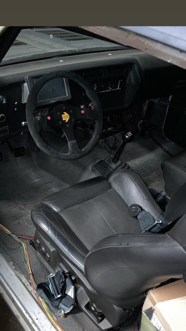

Need to tidy up the interior.... thinking about getting the dash flocked... and need some black carpet. I'm going to just rock the original green door panels for now. Headliner needs redone also. Added a Momo 350mm suede wheel with buttons most likely for rolling anti-lag/2 step and maybe some nitrous to spool it up quicker.
The CTSv seats are super comfortable. After driving it around for about 100 miles the spring rates in the coilovers are waaaaay too soft. Need to change them for something quite a bit stiffer. Not sure what rates are in there... will check this week. It drives soooo nice with the current springs it literally could be a daily driver. It is a bit low out back as entering/exiting angles driveways the rear tires are hitting the wheel wells and stopping the car in its tracks.
The steering seems quite slow... even though this is supposedly a Cherokee "quick ratio" box. Not sure what to do there.... Any suggestions?
The water pump for the intercooler isn't being triggered by the Holley Dominator so I need to get that working.... haven't made more than 1-2psi as there is no cooling of the intake charge happening and I'm on 91 octane and it has 59cc heads on the alum 5.3.... but it feels healthy so far. I'm guessing on 8psi it will make around 500rwhp or a touch more. On kill I'm shooting for 1000rwhp on e85.
