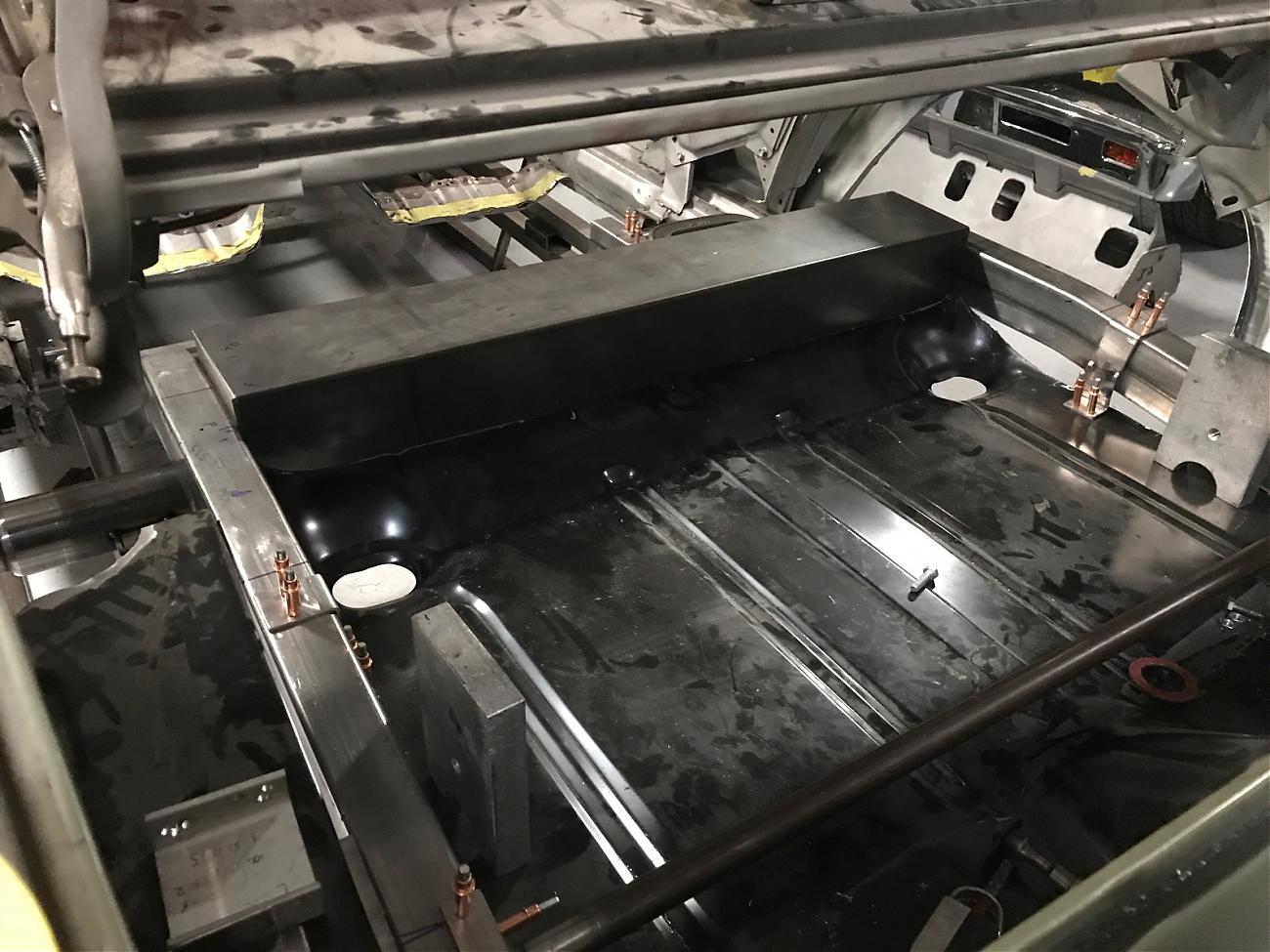

So, Here is some more pics of whats happening. Hoping to have it as a roller by SEMA. Then its off to SEMA for new ideas.

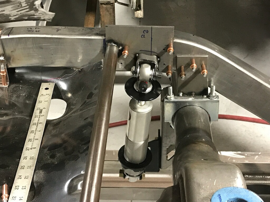

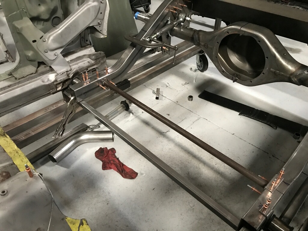

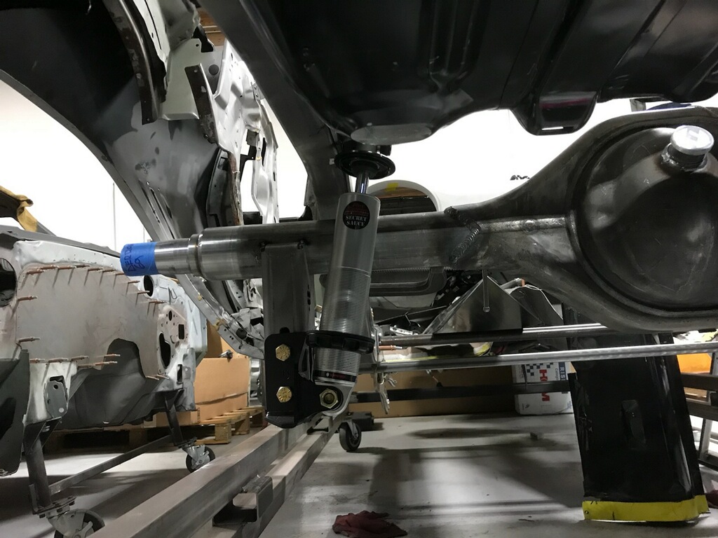

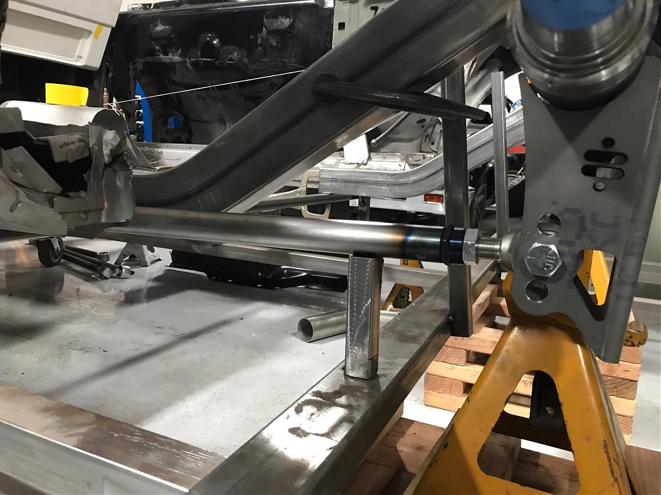

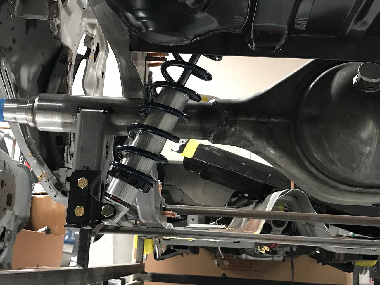

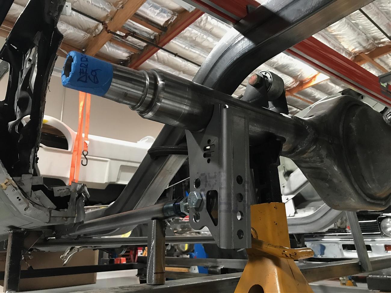

More rear end work.

Old 10-26-2017, 05:07 PM
Centerforce's Avatar
Centerforce Centerforce is offline
Join Date: Feb 2016
Posts: 149
That suspension work is looking awesome! We'll have to come by and take a closer look at this bad boy during SEMA.
