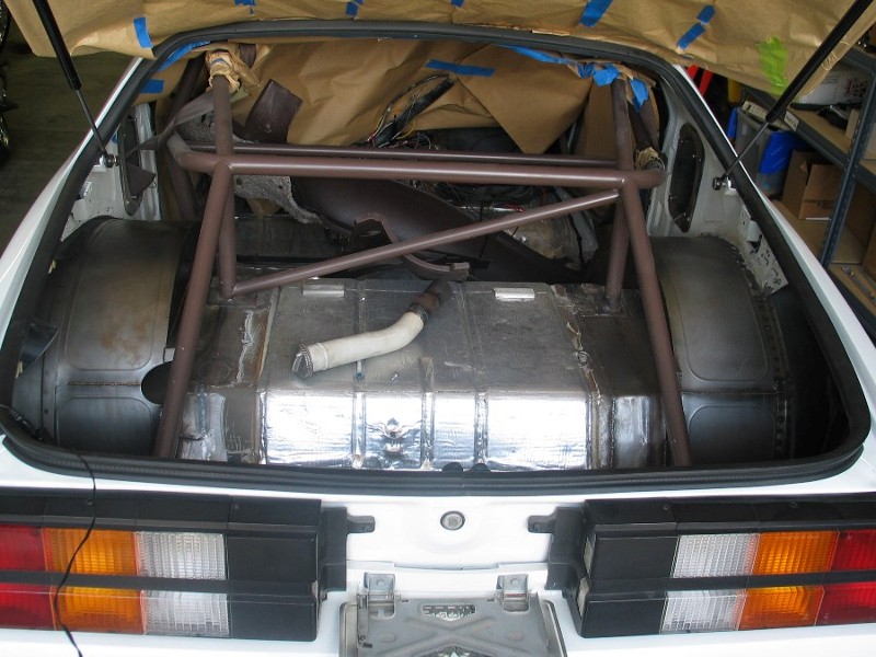

Just adding a pic of the tubs from the back

Originally Posted by 1984 camaro
Just adding a pic of the tubes from the back
Awesome car. Just curious, what are your plans for the interior trim panels over the tubs?
Most of the panels fit we only had to do some trimming those areas will get carpet ? The camaro is getting the interior put in in the upcoming weeks At that time I will post pics

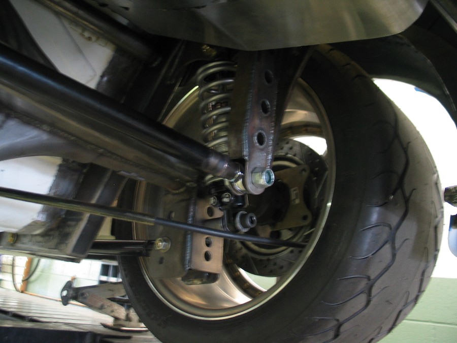

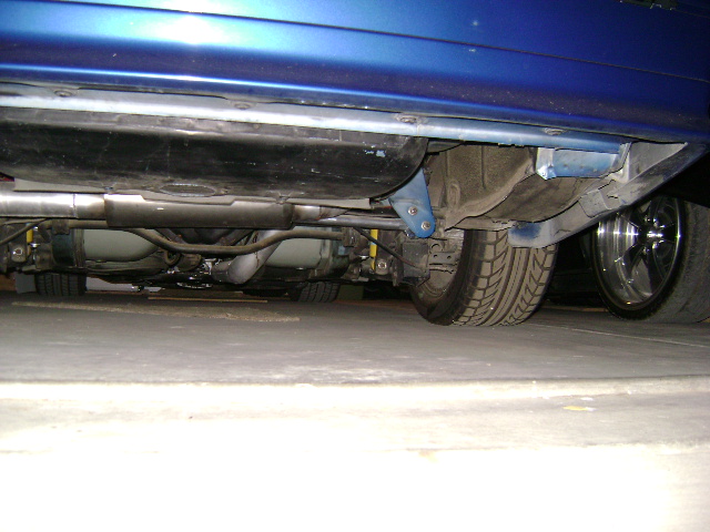

Looks outstanding !!! Do you have any pictures of how the rear suspension was reworked to give you that kind of room? That is the one modification I have been wanting to do to my 91 for many many years, but don't really know how to go about it. Thanks for the pictures! I have been contemplating selling my 91' , not anymore....

Default Rear tubs
Jason
Jason and Robbie here is pic from under side this is a older pic still in the rough
Randy

NICE !! I don't mean to pry, but do you have any more under the rear shots? I am extremely interested in how everything is mounted under that thing...This is something I am seriously going to look into for my 91'. I have nothing in the traction department and this looks to be a cure with killer looks to boot. I give you 2 thumbs up man! Looks outstanding !! What details can you give me about what was used? Thanks for your time!
Jason
The Exhaust I have is two 3" pipes and they fit over the axle. The pic pretty much shows what was used. Coil overs, Umi pan hard bar, lower control arms and tourque arm. moser axle and build the rest.
