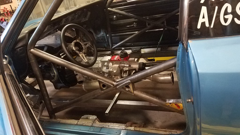

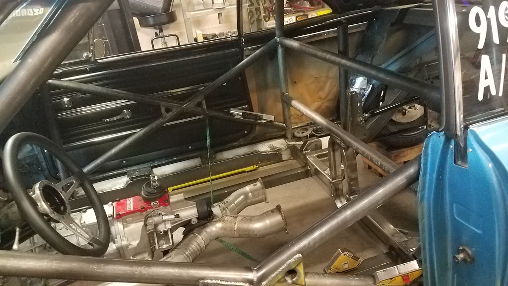

I'm finally back at on the Chevelle. Since my last update a lot of things have been pushing this project on to the back burner. We replaced the gravel driveway with concrete (around 146 yds!), got a new front door on the house, I converted the El Camino over to a Ridetech coilover system with a set of custom built (by me) triple adjustable shocks, and we drove to Vegas to attend SEMA. Over the last few days I was able to get most of the main cage structure tacked in place. I've never installed a cage before and I'm using a kit (from Ron Sutton). I don't have any experience to say whether or not the kit is any good (not that it matters anymore), but I think it will be ok for my use.

Once I'm done with the main cage, the body is coming off and the chassis is going on a rotisserie that I'm borrowing from Tom Farrington. With access to all the tight joints I should be able to weld it much better than in the car. While it's on the rotisserie, I'll also address some areas under the chassis that were hard to get at while it was on the table.

And yes, the cage is a lot of work especially since there were no instructions or diagrams saying which tube goes where, but I'll make it work!

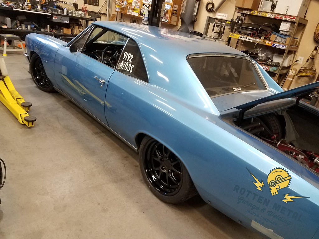

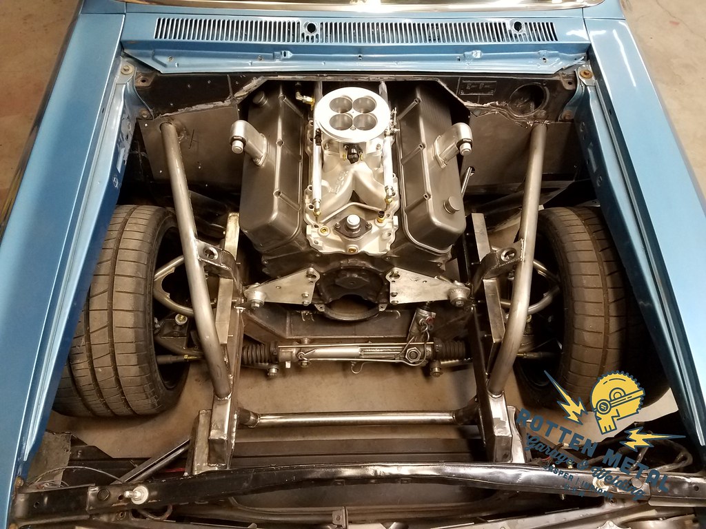

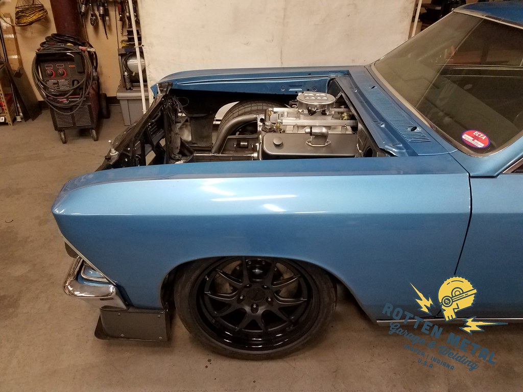

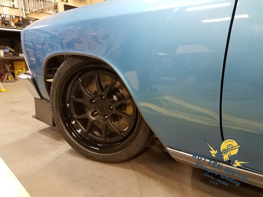

Here it is on the ground for the first time in a while. I had the Forgelines widened to 18x11 and 18x12. The tires are a used set of 315s and 335s I got from Ridetech. They're good enough to roll around the shop and even for some test drives when the time comes. I have the mock up engine in place mounted to the Quicktime bell and T56. Engine set back looks good too.
20190317_210712 by Yelcamino, on Flickr
20190318_101809 by Yelcamino, on Flickr
20190318_101754 by Yelcamino, on Flickr
20190317_210552 by Yelcamino, on Flickr
20190317_210727 by Yelcamino, on Flickr

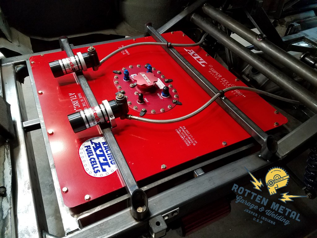

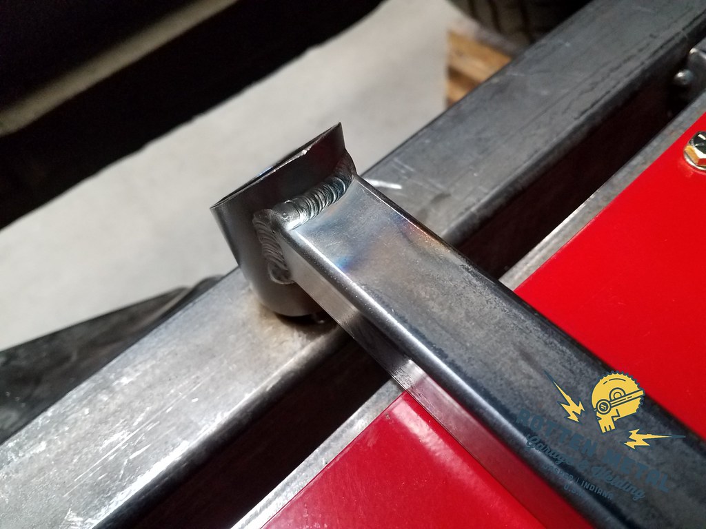

Finally, I got the fuel cell mounts figured out.
20190112_170316 by Yelcamino, on Flickr
20190112_170248 by Yelcamino, on Flickr

Quick question, how are you handling the access to the distributor if you need to take it in or out? Im doing an S10 that has massive engine set back like yours and Im almost considering a LS engine just so I dont have to worry about that.
