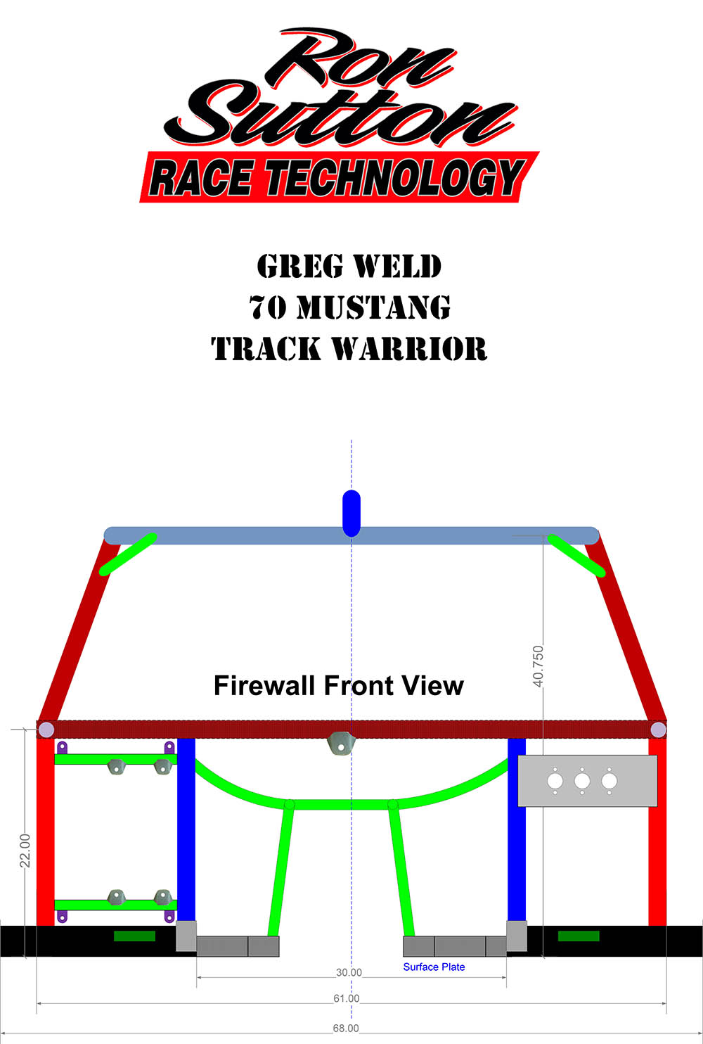

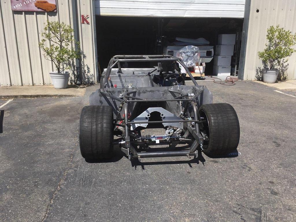

For the engine mounting it’s obvious you are using a front motor plate but what about out back?
Are you going to run a mid plate and suspend that unobtanium sequential or is that the start of a rear rubber insulator mounting point the transmission tail is resting on?

Good question. You need to be careful with how you mount engines & transmissions ... or stuff breaks. When I see people who go by the rule of "when it doubt ... make it stout" on race cars ... that often doesn't work out. Mounting the engine & transmission is a good example of that. If we mount the front of the block with a motor plate, the back with a mid plate & the transmission with a solid or rigid mount ... the chassis flex will break the transmission case.
What I have found works well is mounting the front of the block with a motor plate ... hanging 1 or 2 straps from the firewall cage bar to "help support" the back of the engine/front of trans with no added rigidity ... and supporting the back of the trans with a poly mount. That is what will be done here. With LS, we use one steel strap at the mid point. One end bolts to the top bellhousing bolt& the other end bolts to a bracket welded onto the firewall bar. See illustration below.

Thanks for the insight on the mounting. If you run a Front and mid plate on the motor what would you do with the transmission?

If we run a rigid motor plate & mid plate, we "sit" the transmission on a rubber mount for support. No bolts.
yep that is how I have done it. Or like you said no mid plate then poly trans mount never solid trans mount
