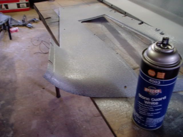

NAPA Pro Stone Guard says it will "Match OEM Panel Texture". Looks very close. But you have to be about 24"-36" away from the panel when applying it.
Since the texture is white, I used a semi flat BBQ paint that looks very close to the normal color of stock panels! Not nearly as shiny as the other "Hammered" paint I was trying.
I am very satisfied with the results.
