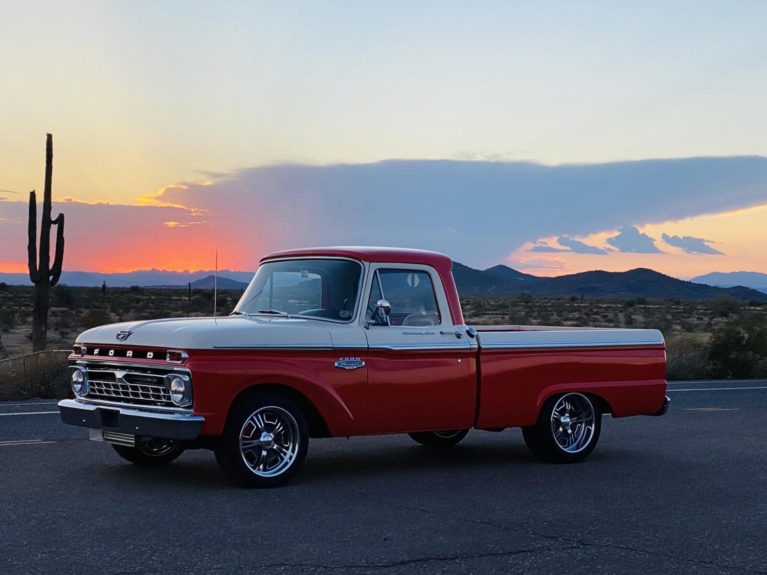

Default 1966 F100 Raptor swap
One of my longtime hobby builds. Have owned going on 23 yrs but a couple years back decided on more power (previous engine was a 482 FE)
I happened upon a 2020 Ford Raptor Crate engine (one of only 5 sold) then swapped it into this truck along with a 10 spd auto.
ALL work including body and paint and building my own custom wiring harness done in my backyard.

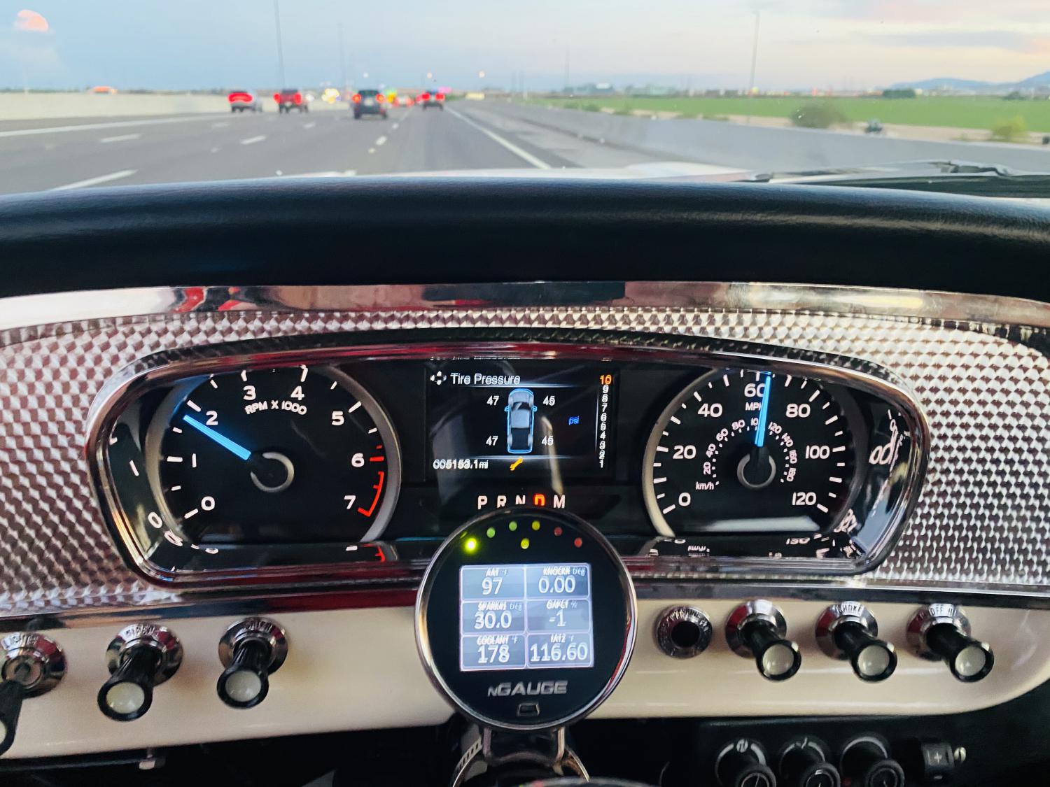

I can run on 91 or E50 fuel. 20 mpg on E50 and 25 mpg on 91.
Built as a long distance cruiser I can go 1000 miles on single fill.
100% emissions compliant like a new F150.

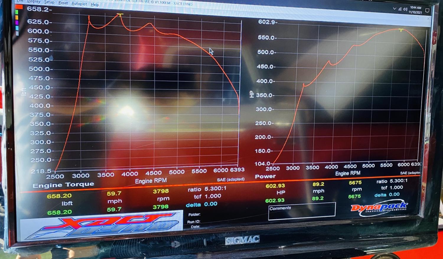

It puts down 603hp and 658tq to tire even thought he engine management software was closing throttle. Who knows where power would have went? That was on base tune also.

Awesome finished product. Wish I got anywhere close to 25mpg on my 2018 Raptor, guess dropping the weight of a supercrew cab, 4x4, extra suspension, 35in tires, etc. makes a huge difference.
