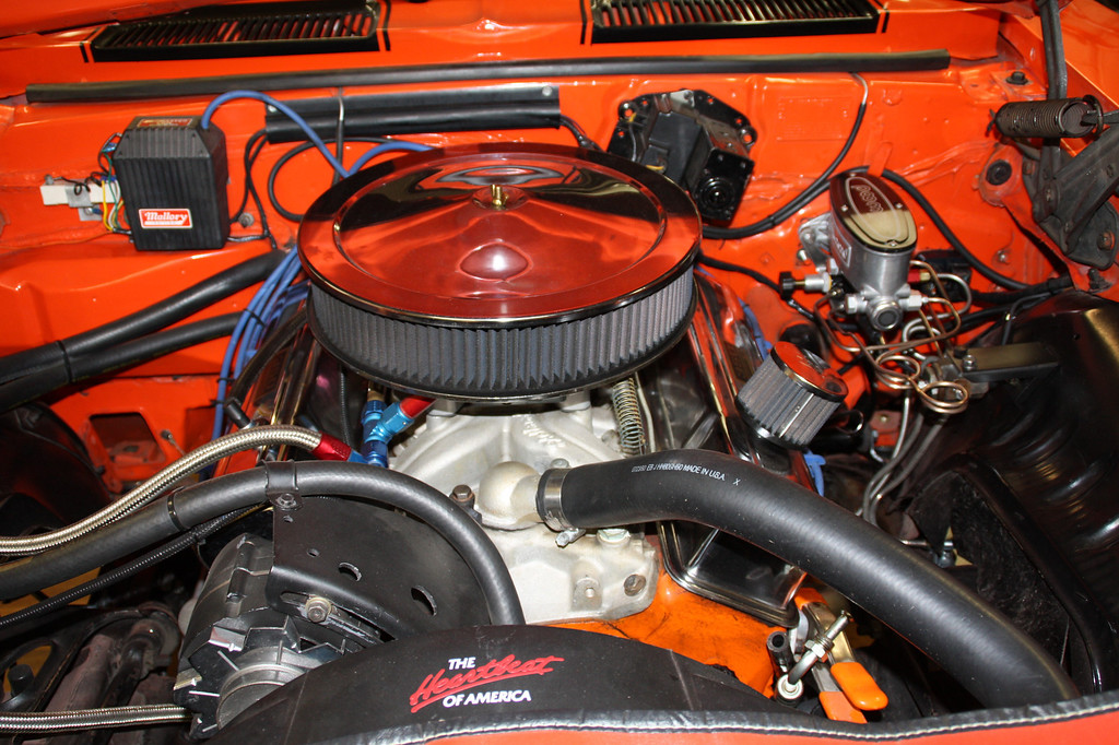

Now to fine tune everything again. Carb isn't bad out of the box but float levels and transition off idle need micro-managing, the new starter isn't starting every time after driving......not sure if the battery is a little weak or the alignment is off once the block and flywheel gets a good does of heat.

Congrats! You did a great job getting this Nice car back on the road....Engine looks Very clean and simple but with a nasty attitude

Drove it a little, haven't been able to pinned it and get it up over 4K yet. Supposedly the brakes were bled but they were like an old sponge, re-bled them yesterday and have pedal now so hopefully the weather will cooperate today. My initial impression with an unturned carb and 4 month old fuel is the compression is down a little so it's lost a little snap down low but that could also be a slightly lean transition off idle, 3-4K feels stronger but the 4-6K is an unknown. It definitely didn't go backwards and Sunday through Friday looks like good tuning weather.
I richened the corner bleeds and tightened the primary accel pump a little so we'll see what that did..........provided that starter cooperates.

Look to see if there is a big azz GROUND between motor and chassis -- lots of people overlook that and it will cause all manor of starter motor ills.
