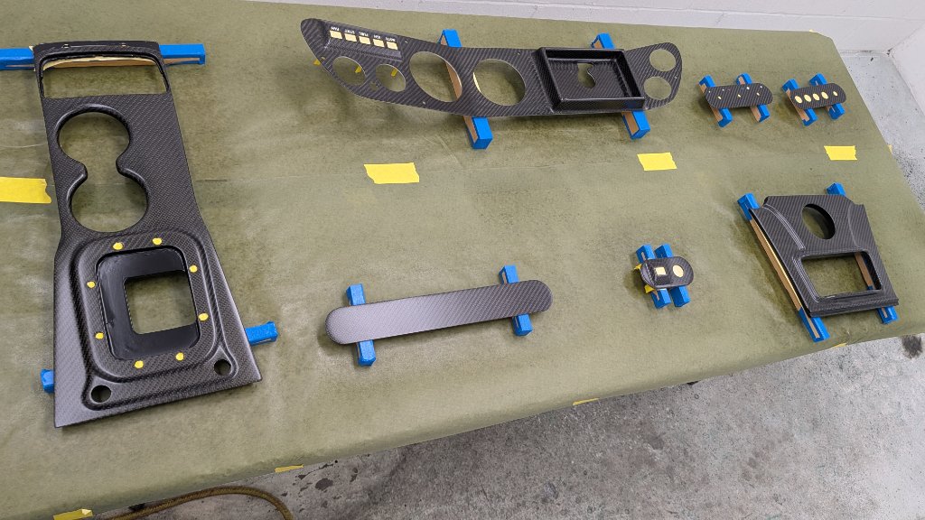

Originally Posted by Goosesdad View Post
Needed to get some clear on the carbon interior panels so I could put them away safely, at least for a while. 4 coats of matte clear.
Attachment 86278
Need to have the AC knobs and the switches anodized so quicky fit up to pick the sheen.
Attachment 86279
Attachment 86280
Those look amazing!
