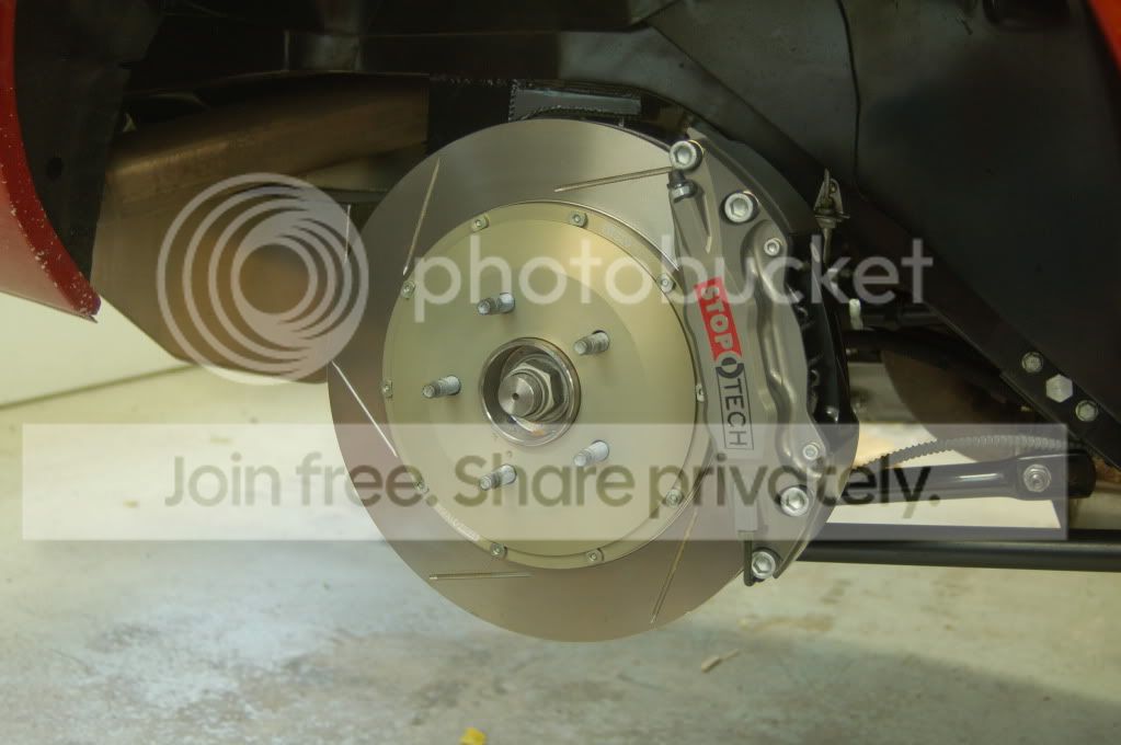

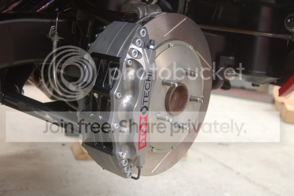

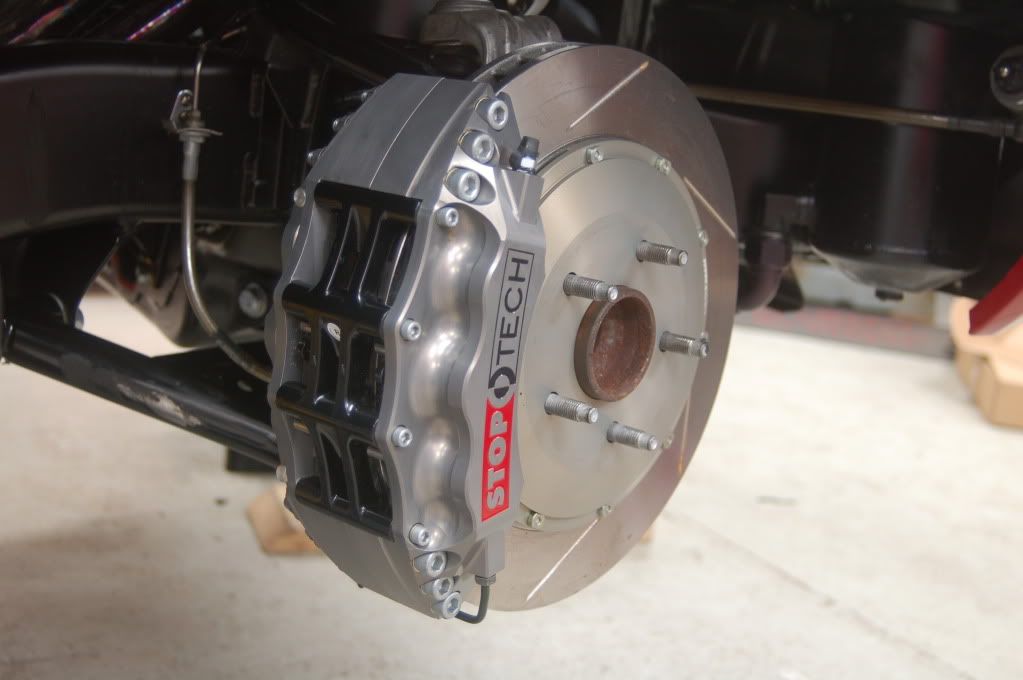

I changed the brakes out to Stop Techs. We rebalanced the caliper pistons in the calipers to better optimized brake balance. The brake feel is great and with a more reliable ABS set up my braking distances are coming down.
I sorted out my clutch issue that I was fighting at Heidts and LSFest. After some research there is a 0.065 restrictor in the clutch hyd. line.
I remember an old article Jeff Smith did and looked it up.
http://www.chevyhiperformance.com/ho...021/index.html
After that modification and a good brake bleed the trans / clutch are working great. It is a mix of OE and modified OE stuff. Working with 800 ft*lbs and trying to road race, drag race and street drive required a little sorting out.
