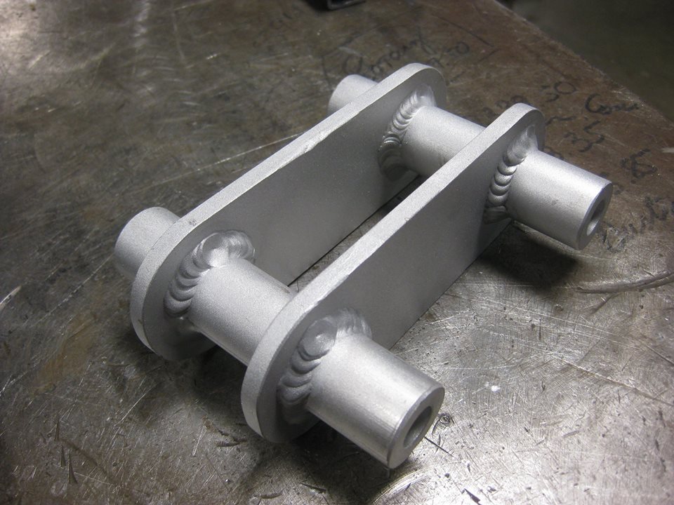

Michael, As promised I was able to get the alum. center support fabbed and welded for you. I Don't have any 3/8 x 5.5" grade 8 bolt's in stock.I will pick up some bolts when I go to town to ship this out to you N/C. Sorry for the inconvenience.
Scott ... that is gorgeous!!! No problem here, my bad by not getting a FOMOCO rack, but your solution is great. I ordered the offset bushings already, hopefully that'll take care of this part.
