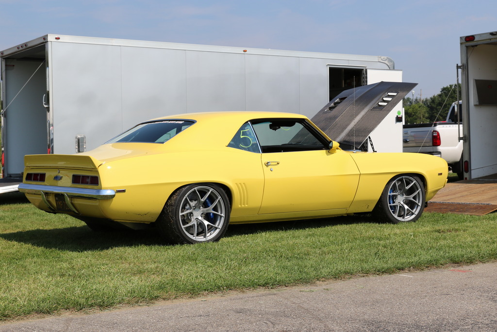

A few photos of JA 2.0 from todays track event at Waterford Raceway. The ambient temperature was a steamy 90 degrees, but JA ran cool (203 F peak) on E85 consuming a tank full each 15 minute session. We will definitely need to bring more E85 for the next track event!
Gordon

Car has a beautiful stances too..

We had a good test at Waterford. I had some good data and some not so good data.
The cooling system worked great.
The ambient air temp was 87 F. On a 15 minute session the oil temp stabilized at 207 F and the oil temp was 231 F.
Now the bad news the fuel pressure is still falling off with high load.
All this data is off my built in Race Technologies dash. It is nice to look at data after the test and have to relay on looking at the dash.
