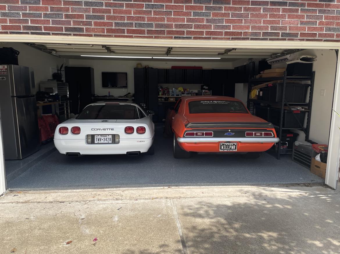

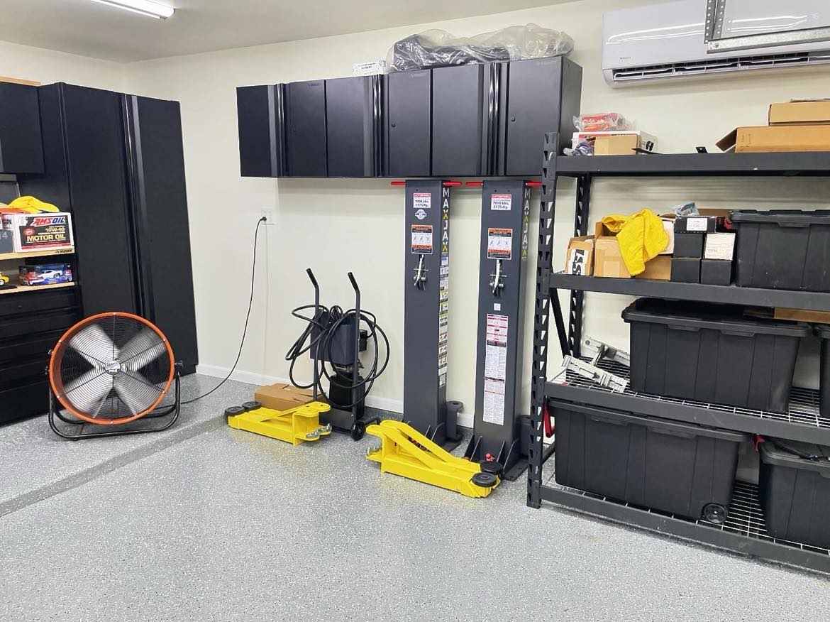

Few pics of the distractions I've had.
Also, made the decision to make this garage more comfortable as interest rates have stopped my looking for a replacement house with larger space for cars. I'll survive with my large storage unit (15x50) and small garage.
I renovated it last year, with new paint, more lights and cabinets/storage.
I recently added a mini split to keep the Houston Temps and humidity outside the garage, and picked up a "small" two post that works for low rooflines. I cant raise the roof as we have a space above that is utilized. This will work for now, and they advertise a 48in lift, so it will be more comfortable than working on the cribbage stands that I've done everyone on previously. Friend swears by his MaxJax lift, so i went with it. I like that it can be removed and stored. I had planned ahead previously when i hung the cabinets, so happy to see my measurements were correct and they fit under!

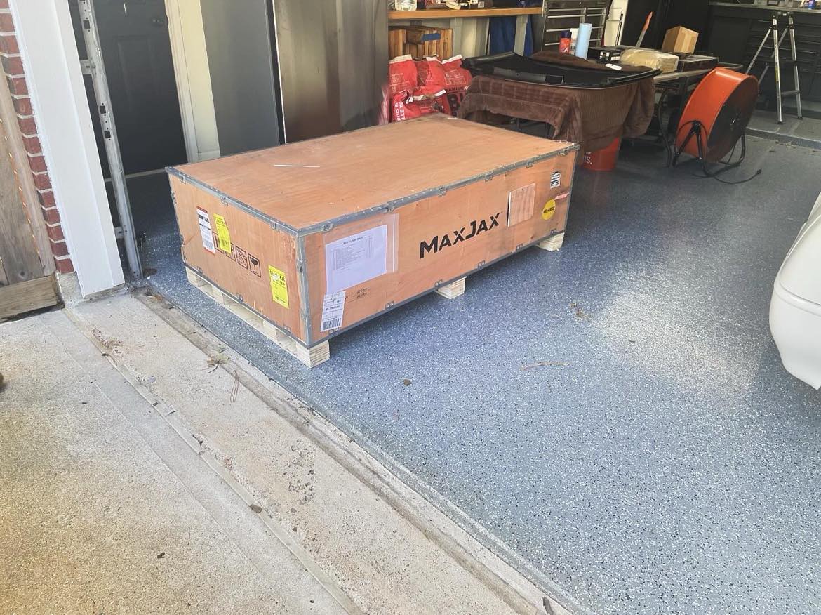

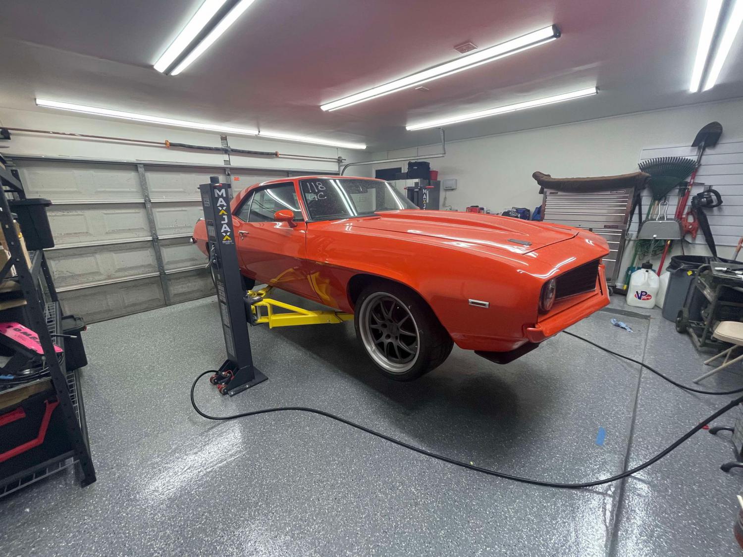

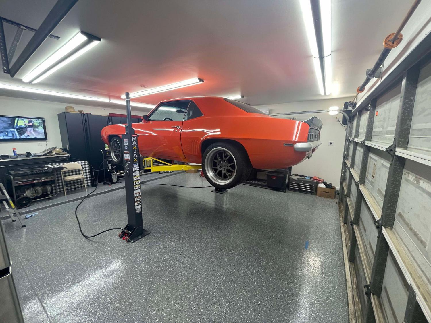

Got the lift installed and positioned it with the ZR-1 and the Camaro. Tested it and so far so good! I think it'll be VERY helpful for work under the car.
Dont mind that the car is dirty. I had to have it outside when measuring and it was slightly raining. I'll get it cleaned up along with the garage.
