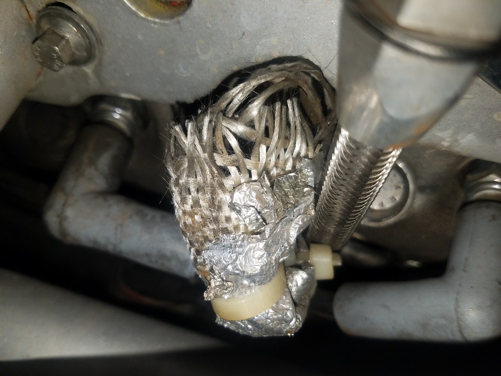

So I have 4 coolant temp sensors currently wired up on my engine...and I can only think of 3 that I need. Anyone have any idea why I ended up with 4?
I'm game planning on where to put the new coolant temp sensor for the EFI (which will let me delete any that are electric fan related) but I'm not ready to disassemble the car just yet.
First is in Passenger side head, pretty sure it was the last one I added and is the cooler of my fan switch sensors.
Second is in the Driver side head, pretty sure it is for my Dakota Digital Dash
These two are in my Thermostat housing, pretty sure one of them is the second switch for the high speed fans, the other, have no clue...
What the hell would I need a 4th one for? It sucks to get old!!

You should only need ONE —- for the ECU — it should be capable of supporting TWO fans set at different temps etc.... and it should have an output for the digital dash...
Not familiar with that particular ECU - but it should be capable of doing all kinds of stuff.

But then I'd just have to find plugs to plug all those holes back up!!
I'm not sure if this ECU has an output for the Dakota gauges to use or not. Prefer to not mess with the dash wiring if I don't have to...as I know it already works.
