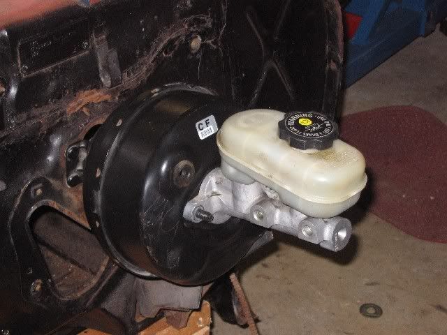

Well, I felt a little better this afternoon and I got a ton of work done. I had to split my time between the Camaro and a huge powdercoating job for a friend's machine shop, so I wasn't as productive as I could have been, but gotta keep the side business going!
Anyway, I got the firewall modified to fit the LS1 booster and MC. First I took the booster and cut out a template for the hole. Then I traced it off on the firewall and went to town with the cutting tool. Fits like a glove! I still need to weld in the section where the old hole used to be and modify the booster shaft to fit the existing brake pedal, but so far so good!

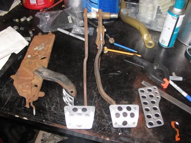

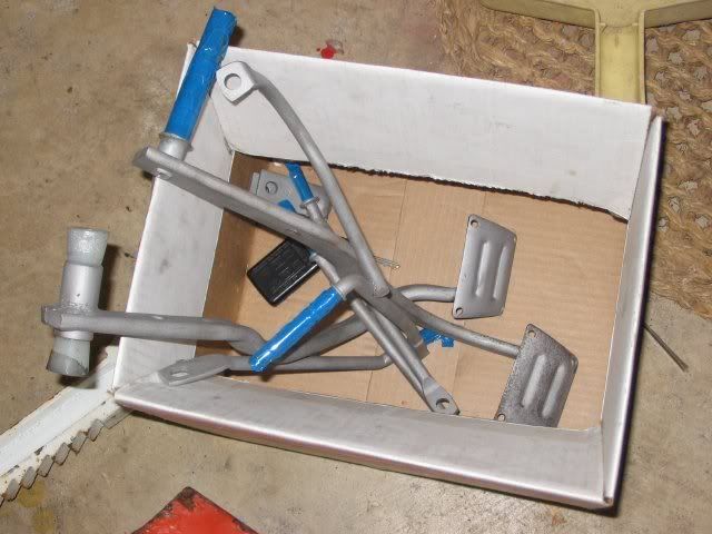

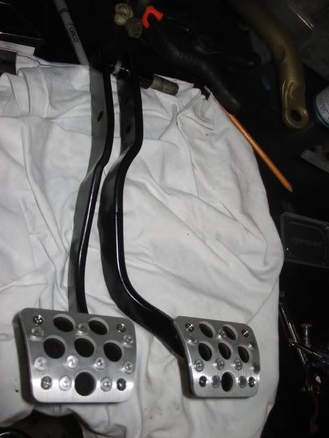

OK, finally was able to get some real work done on the car! I got the pedals all fitted for the Modo Innovations covers, then I took everything down to HRT Performance to be tanked and blasted. Tonight I powdercoated it all semi-gloss black and reinstalled the Modo covers. Came out amazing. I also cleaned and painted the parking brake assembly. I ordered all new pedal bushings and pins and all from Firewheel, so those should be in tomorrow or the next day, then I can get the pedals all ready to go back in the car once I finish up the LS1 booster and T56 Master cylinder modifications to the firewall and get the seat supports welded in this weekend.

Got the LS1 booster conversion all finished up. I measured and cut the stock brake rod and welded it on to the LS1 booster shaft. The I welded in some metal and cut it to match the hole in the firewall.
