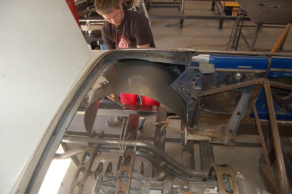

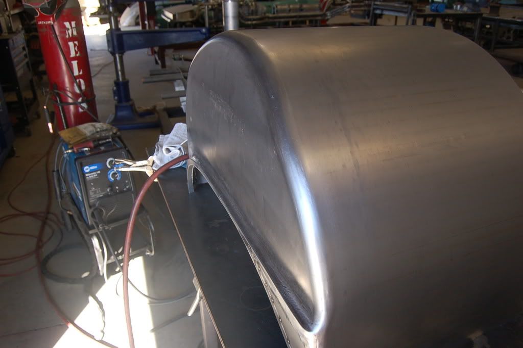

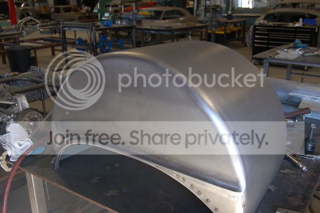

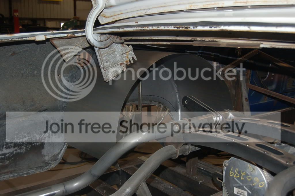

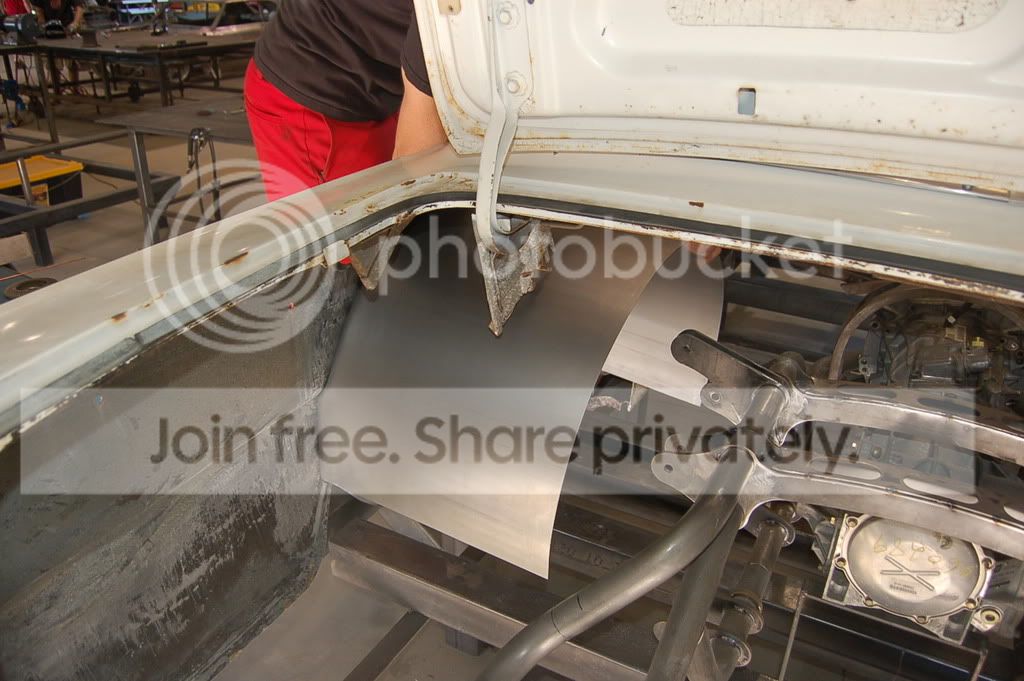

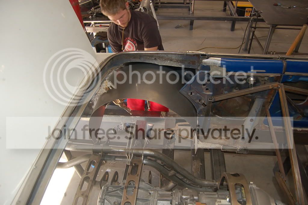

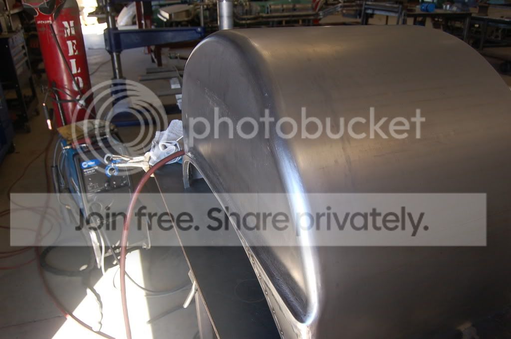

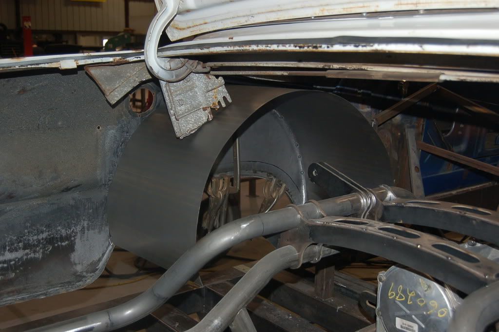

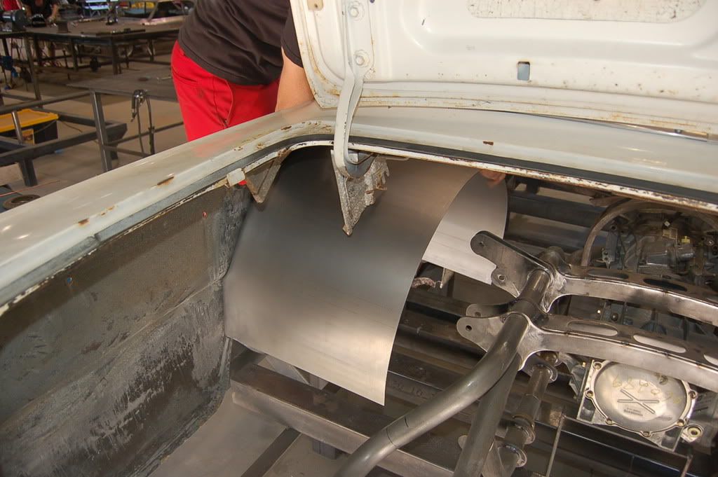

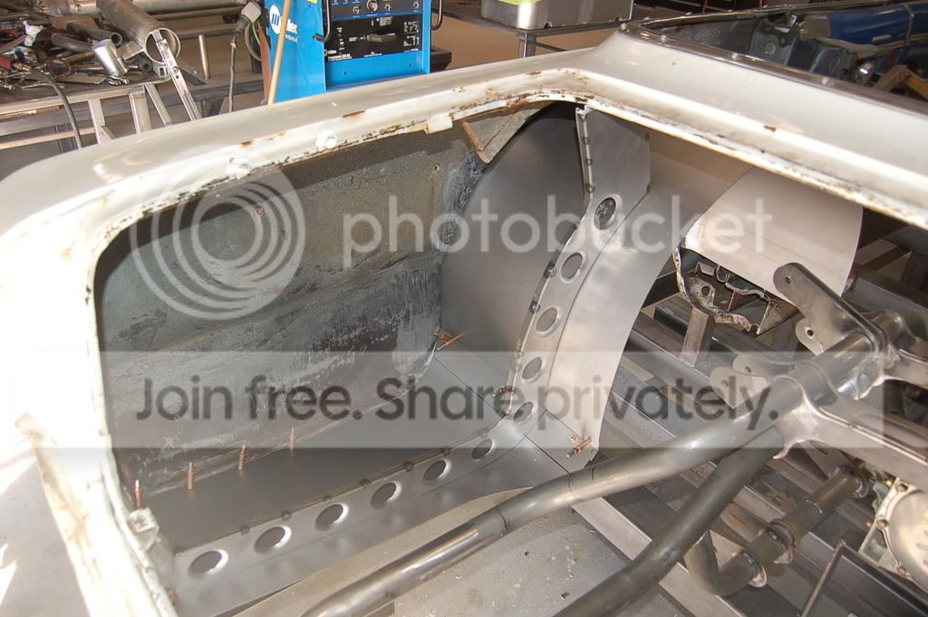

The tubs are taking shape!
Here are a few shots of a tub on the bench being fabbed:
Here are a few shots of one of the tubs being fitted in the car:
The original contertible top mounting points were kept intact during this stage.

I'd love to see some more pics of the fabrication of the wheel tubs if you have any. Those are very nice. I'd like to see where the weld seams are etc. You can barely tell that's for sure.
I'll see if Rodger at IRONWORKS has any of the fab photos...... If so, we'll post them.
Wait till you see the trunk shots. I'll post them soon.
Thanks, We planned that.

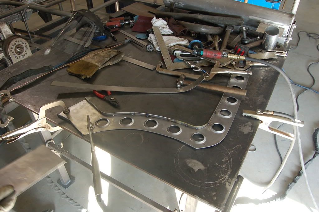

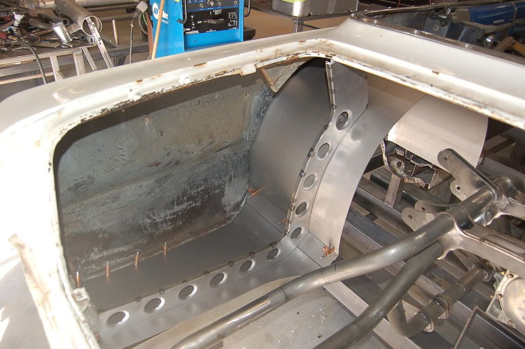

Default The Trunk......

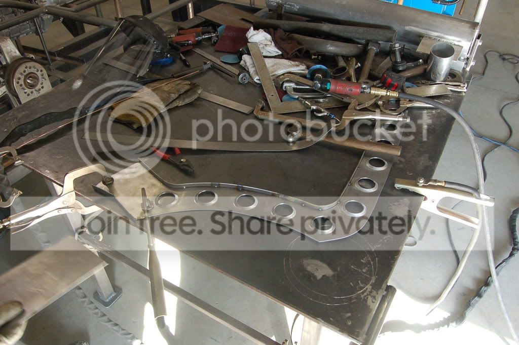

The guys at IRONWORKS are at it again...... Check out the trunk fabrication:
Here is the bracket installed:
There has been interest on the fabrication of the tubs, so here is another photo.
This photo shows where the weld seam is from the inside:
