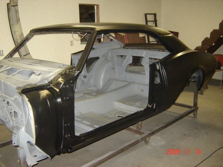

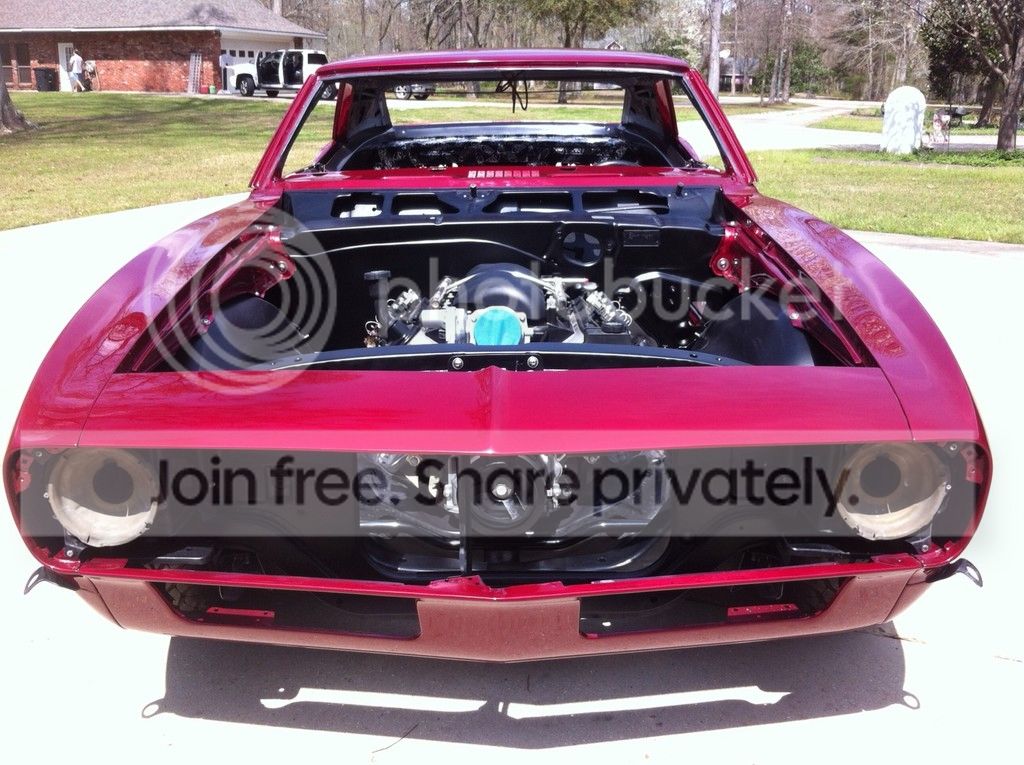

Minimal progress since the last update, but it's progress. Been kinda bummed since the fiasco with my Fikse wheels. Since the last update I've accomplished the following.
* Trimmed the quarter lips for the 335's.
* Removed the body filler from the previous body work (that I paid to have done) only to find that the driver side quarter to roof skin seam had not been welded solid. So, I welded it solid. I also found that the roof skin was not welded to the windshield pillars, so I had to fix that too!
* Welded up the seams where the deck lid filler panel and quarter panels meet.
* Welded in the trunk latch bracket in the trunk.
* Installed the weatherstrip gutters.
* Had some major pitting in the passenger side a-pillar, so I had to cut out a section and weld a patch piece in.
* Stripped the shell down to bare metal and sealed it with DP primer.
Here's a few photos.

So you paid for some work to be done and had to strip it all back off? And the guy didn't even weld the roof to the A pillars and the quarter seams were bad too? Major bummer! But now you are past that and getting things done, and done right. Nice work!!

That's right. I dropped my car off to a body man in July of 2007 to have the driver side quarter and outer wheel house, roof skin, deck lid filler panel and DSE tubs installed. He quoted me 3-4 weeks for the work, I gave him 8 weeks in the back of my mind. In January 2008, I had enough and went to pick the car up partially done. He had completed everything except the tubs and it took 6 months.
The funny thing was two weeks ago, when I stripped the primer from his work, I found that the EDP primer had not been removed from the new panels he installed. I specifically asked that it be done too. Once I saw that, I decided to strip the body filler off too. That's when I found the seams not welded. Oh well, it's just money down the drain, I guess. I have learned a new skill since then, though...BODY WORK.
Not sure on wheels yet. I want a step lip design and an 11.5" rear wheel, so that limits my choices to a select few since I have to go with a 3 piece wheel to achieve the 11.5" width for the rear. Maybe Forgeline or HRE. I'm gonna concentrate on the body work, undercarriage, and front suspension, then decide on wheels.
