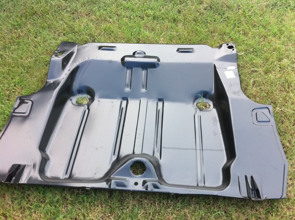

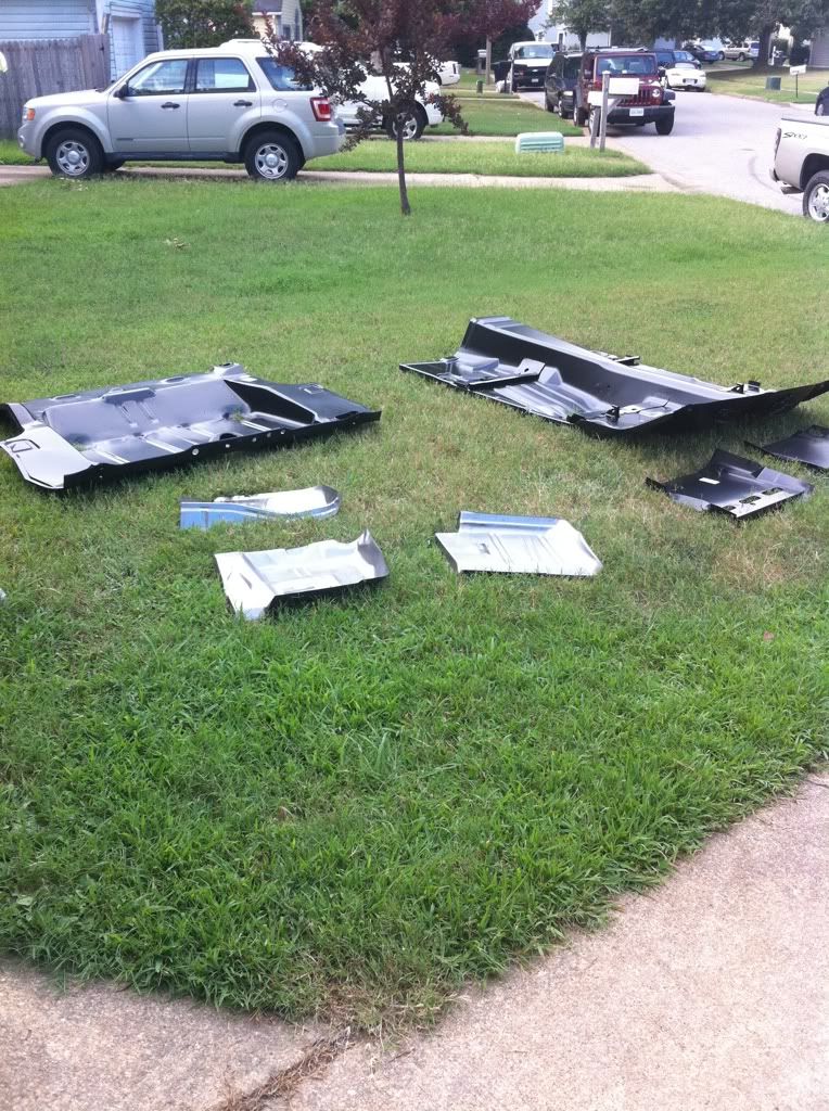

while throwing some weld through primer on the rails of the AME clip,I heard the growl of a Diesel. Yesterday I recieved a call from a frieght company asking if a Semi could fit in my neighbor hood, I told them most straight trucks have problems. I look out to see a Semi with a 48' trailer squeezing between cars.
we ended up getting him to the house, and got the parts unloaded. all the floors arived in good condition. there is one extra brace on the main floor pan which i'm not sure what that is I'll take some better pics tomorrow. I'm guessing it for a convertible.
you can see the brace infront of the rear seat mount
  #84
Old 08-11-2011, 06:29 PM
Nice load of parts
I think that brace your talking about with the cage nut is where the sub frame bolts to. My hardtop had it too.

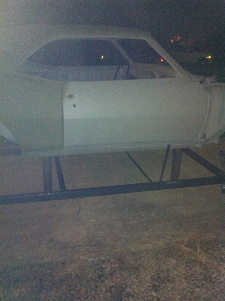

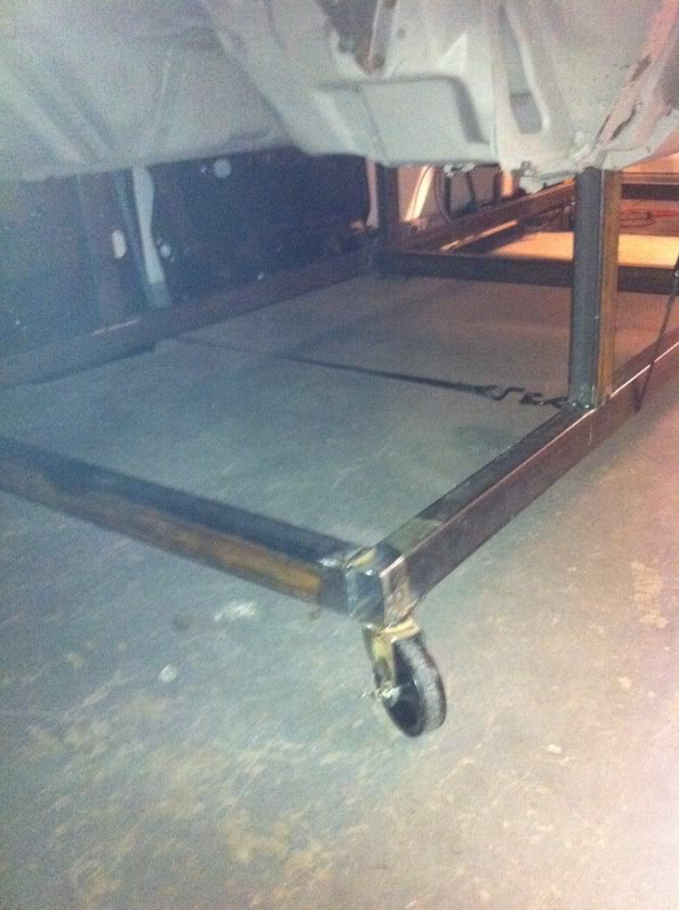

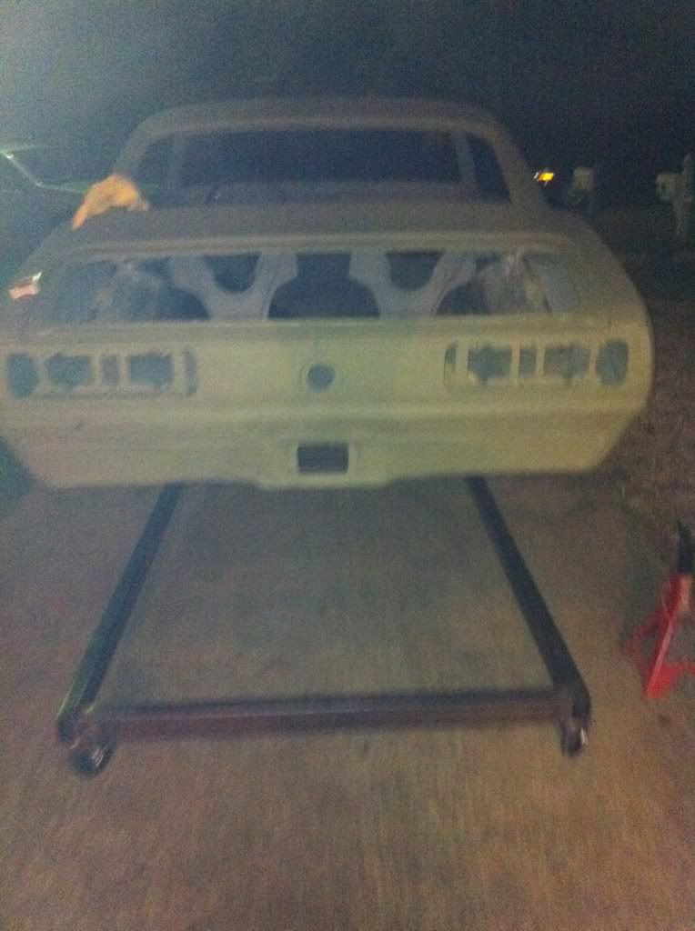

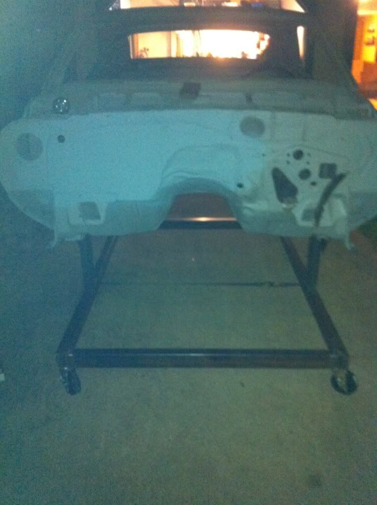

Update of the day..... I made my way to the local metal distributor today, and picked up two 24' 3x2 11ga tubing and one 24' 1x1 11ga square stock. When I got home I started to build my cart. Not the elaborate plans I made I went super simple (hopefully it does the job).
After getting the main box tack welded together and square I ran out of wire for my Mig. Made a trip to Northern Tool and picked up the wire and some caster wheels.
I ended up getting it together after a lot of head scratching, sweating and measuring and re-measuring. Then came the fun part.
I chose not to take any pictures of me moving the car onto the cart, because I was worried it could fall at any time. With the more 2x2's and 4x4's and jack stands than I care to mention I ended up getting it on for the night.
Tomorrows plan is to get the car squared up on the cart, and final the rockers to the cart to keep the car where I want it. Then brace the inside of the car with the 1x1 square. Then out with the floors
here are some crappy Iphone pics I'll get the camera out tomorrow.
Once I get the car where I want it I'll add in a rear brace to keep the trunk from sagging
The garage is real tight now
